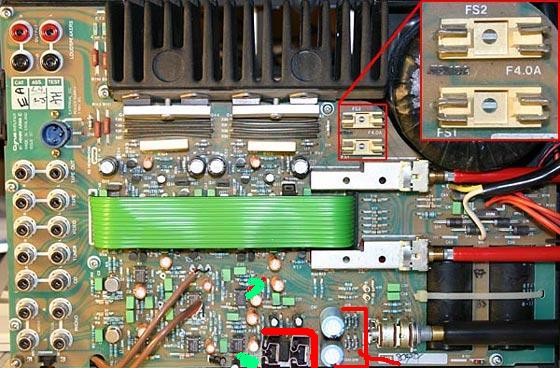

hi i have just removed the four diodes and the regulators the power led still lights up. and the amp sounds great would i expect any sonic improvment similar to psx or was what i done a waste of time :bawling:
inside the cyrus two there are 4 little diodes right near the volume pot ,and there are two voltage regs right , for the phono stage. so what is so confuseing for you do you own a cyrus 2 ?see pic ignore the fuse section bottom right is were the parts are
yes with psx.
now what was so difficult about that?
Can I presume you don't need the phono stage?
Then, you have reduced the loading on the PSU. Effect, unknown.
Apparently the advantage of PSX is the dedicated and larger PSU to the line and output stages of the 2. There not being sufficient room for a proper supply inside the 2.
Cyrus have stuck with this philosophy all the way to present. Small cases = extra sales of PSXr
