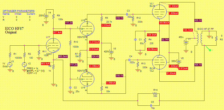

I can understand why you are all shook up: )
Your aim is to get approx 15 wpc in triode mode or 30 wpc in UL connection. Fine.
Build the HF87 plan. Not that this circuit is something very special. But you can only do as much when the topology is Input Stage > Phase Splitter > Output. So unless we are talking about MOSFET/HYBRID Input/Output or Transformer phase splitting, your topology stays a Mullard or Williamson Clone.
That Poinz schematic is triode strapped. Should sound nice. Basically there is nothing, which can go wrong. The input uses a plan called “SRPP”. Some like it, some don’t like it. My 811A SE amp uses the exact SRPP. You can jolly well omit the top 6SL7 and voila!! what have you now?? The Mulllard design !.
I personally like a pendote such as EF86 or 6SJ7 for the input with 6SN7 Splitter to UL connected EL34.
SO your shopping list could be something like this:
EL34 x 4 (your choice)
6SN7 or ECC82 x 2 (Again your choice)
EF86 x 2 if you are looking at Pentode input (my preference)
Or
6SL7 or ECC83 if going for Triode input (sound very fine indeed)

Look this attach. It is as simple as it can ever be. This is the HF87 design. Or look at the Poinz design.
Good luck!

What I am looking for is EL34 Triode - 15W and EL34 Pentode AB1 - 30W.
why EL34? becuase I need 30W for the woofers (they are only 88db) and keeping the same tube for the tweeter gives 15W in triode. a bigger tube (that can give 20-30W in triode) would generate too much heat.
my choices
1. Poinz - 6SL6 and 6SN7 with EL34
2. HIF 87 u posted above using something other than a 12AX7 for input. Maybe a 6SL6 or 6SN7? Any reason you prefer the 12AX7 to the ECC83 for input.
3. Joel Tunah's 6V6 ckt if we can use SS bias.

Hi Navin
I am attempting to convey that all those schematics- HF87/Poinz/Micky Mouse are following basically the same topology. I used HF87 as an example because the illustration is most simple to understand.
Triode, UL or Pentode is a minor issue. You can do all those with the same OPT (almost all Push Pull and some SE OPT’s have UL Taps). So just go ahead and order the OPT’s. Those are the most critical items and throw the biggest chunk of your budget on them. Have you decided what make OPT you are going to buy? Hammond makes very sensible iron at competitive cost. I am also hearing good reports on James. Then you have Tamura and such. They are supposedly the best but a pair can cost the earth.
OT here but I usually get my OPT’s wound by a small company in Korea. They are expensive then James but very high quality. I don’t wish to jack up their costing by disclosing their name here. Till now I have bought 6 pairs from them. The highest I paid was U$ 500/pair for a massive 10K/120mA/45watts OPT for 845 triode. This is under prototype now.
So relax and order the OPT’s now. Rest we will see when you are back :)

total 1 ECC88, 1 6SN7 and 2 EL34 per channel.
I like the (Eico) AF Amp/LTP splitter configuration. Since you have an octal there (6SN7) why not use another octal like a 6SL7? shhh ;) , it's closer to a 5751 than a 12AX7. That's what I would do but hey it's your amp!
And yes I have a "bunch" of schematics and circuits I've simmed, I'd be more than happy to post a few or email them to you...

It is a question about microphony. It is not simple to answer. I have done some mesurment with at least 10 brands of ECC83. The result was a relation between the noise and the microphony. More noise implie less microphony. But as you have more noise, the sound is less good, you get less dynamic.
But it is more. They are tubes optimised for the noise and the microphony as the E83CC or E88CC, E188CC and E288CC. They can be very expansive as the E288CC, but if you goal is to have the best result, it is worth to try those tubes, at least for the first stage.
For you first amplifier, the best thing to do is to build something big enough. You can begin with something simple that will work easily, and after, it is easy to try other solutions even if you must change or add some components.
A word about the Marshall/Fender phase inverter in Waine's post.
A such circuit, used among other by Marshall and Fender in guitar amplifier is an heresy for me in a such amplifier.
In order to get a good sound in a guitar output stage when you are playing at high level, you must drive this stage with enough power, 1 or 2 watt per tube for a 6L6.
If you look at the Ig1=f(Ua) characteristic, a 6L6 can take some current on the grid. The driver must be able to drive those grids (at least 2 for a PP class B)
A much better, but epansive solution, is to use a triode or a pentode in triode comfiguration with a driver transformator. The circuit is simpler, one tube, one resistor and one capacitor between the cathode and the ground, one transformator (with an air gap).
I get excellent results with an EL84 and 2x6L6 or 807.
The problem for a manufacturer, is at the most expansive Marshall cost less as 100$ to manufacture, inclusive the box, the manual and the tape on the package. They hae to find a way to get a cheap and good enough result.
One more thing. You can get an excellent result with a Marshall/Fender phase inverter in an hifi amplifier, because the output stage will be in class A or AB, and you will not have grid current to drive.
Another way to go with a guitar amplifier can be to use a Marshall/Fender phase inverter and put 2 tubes in cathode follower. But you will not get a so good result as with a transformator, because the circuit and the alimentation will become too complicated.
