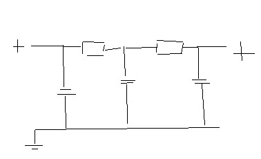

Could you draw a wiring diagram of this? I can read a diagram but other then that I am a bit lost.
As for the rectifier, I don't mind spending money for good ones. Are there better then UF4007 or should I just use those?
You will do FINE with UF4007s. The snubber filter will kill off the small amount of noise they produce. You could boost performance of the snubber by using a 100 nF. cap., instead of a 10 nF. cap., across the power trafo's secondary. Snubber caps. need to be HIGH WVDC rated, as there are spikes to be dealt with. 1200 PIV Silicon Carbide (SiC) Schottky diodes would be a step up, but they are as expensive as filter chokes. A snubber is not needed if Schottkys are used.
I do schematics by hand and it's hard for me to post them. Perhaps another "denizen" will provide a CRCRC filter drawing.

I am going to stick with CRC for now, I think. Should I still use 100uF caps for this or go larger? If I were to go with a CRCRC what size resistors would I use and what caps?
What is the main bennifit from switching from a CRC to a CRCRC?

Use the CRCRC topology with 3X 100 muF. caps. and 2X 150 OHM wirewound resistors. Mouser carries suitable resistors.
The electrical tradeoff on CRC vs CLC is in regulation. A CRC will droop more in a heavy load than the equivalent CLC. Its acoustic effect will depend on the amps topology and use, its a much bigger deal in an AB amp than an A as the voltage drop will vary. Some instrument amps have deliberately droopy rails.
