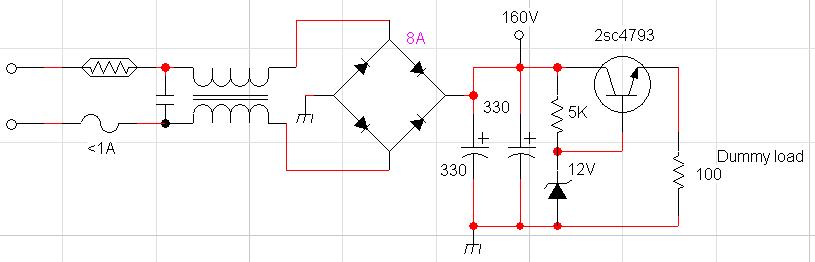

Heres my problem. I want to take 160VDC and bring it down to 12V to run a TL494 PWM, It's part of a high current(50A) 12V power supply I'm building for testing car amps on before putting them in the car. My problem is that no matter what I get for my theory it just doesn't work. I will show you my schematic at the bottom. I'm useing a basic series pass regulator with a zener holding it at 12V. when I have no load on the supply it will output 12V(not including losses) but the moment I put any load on it, the supply drops to .33 or so.
Could you please tell me what I'm doing wrong.
P.S I know I'm working with mains at the moment so that is why I'm asking.

Man, you sure like to live dangerously. You realise this is a live mains circuit? And that you ground the mains through a diode?? As P-A said, get yourself a transformer. Otherwise you may need to change your name to ifrymyself .

Not only dangerous but impossible. You want 12V at 50 amps? You'll never get that out of a mains supply anyway. Besides saving you from killing yourself, a transformer lowers the voltage and allows for increased current while maintaining efficiency.

I think that nobody has understood the initial question, and I feel quite ashamed by such an amount of misunderstanding, particularly in a forum where SMPS discussion is quite usual.
ifrythings wants to power a TL494 SMPS controller IC directly from the 160V bus of his SMPS by means of a series pass regulator. That IC requires 12 to 20V to generate proper MOS gate drive signals and it draws approx 8mA when idle.
This is absolutely OK and is the solution adopted in almost all commercial SMPS units that feature primary-side control. It's quite obvious that an isolation transformer is required to do such SMPS development, but I assume that he has already got one, and if he doesn't, then he will be acting at his own risk (of death).
Also, the "transformer" shown on his schematic is not a step down transformer, it's actually the common mode EMI filter of his SMPS!!! Who could have missed that point???

The proposed circuit should work fine, altough you are going to get serious dissipation on the pass transistor if you try to get out of it more than those 8mA that the TL494 draws when idle. In most commercial units, this is solved by using the pass transistor during start up only, and then powering the control circuit from an additional winding in the main transformer when the supply is running.
For example, you can get 20V to 30V DC rectified from that additional winding (use the proper turn count), then pass them trough a simple L7815 regulator, and connect its output to the emitter of the 12V PSU pass transistor. When the SMPS is running the auxiliary supply will be forced to turn-off and the power will come from the 7815.

BTW, that 100 ohm load is already pushing your pass transistor beyond its power limits. 10-20mA load might be reasonable but 120mA is too much. You also end up with 5watt power loss in your 5k resistor, if it not big >5w rated, its burnt already.

Per-Anders is right, an isolation transformer is required in order to do that kind of experimentation with some safety. I have also mentioned it in my post. If a dedicated transformer is not available, several secondaries from standard transformers scrapped from old audio amplifiers may be connected in series in order to get an isolated 120V AC source. The thing should be also properly fused.

Hmmm so if I have this right, you guys thought I was useing raw mains with no isolation transformer? If this is correct then I'm sorry to everyone for not saying that I am using an isolation transformer (500VA) with a variac before it.
