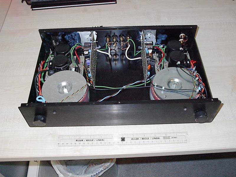

This is an amplifier I designed several years ago, its unusual in that it has an error correcting output stage based on Hawksfords topology. The PSU used T-Network capacitors from DNM see:
http://www.dnm.co.uk/capacitors.html#tnetwork
It is not really a project for the beginner, but if you persevere it does sound nice, a friend compared it to his Chord SPM1200 and thought it did not go as loud but that was is only criticism. Have fun!

amp picture

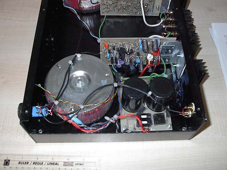

picture of inside of the amplifier

IME chip amps sound OK for most purposes, but lack that finesse, bass slam and three dimensional imaging you get with a good discrete design. Basically I have not heard an amplifier costing less than 3000UKP sounding anywhere near as good as this design. Someone has reviewed in another forum, I will ask permission to post it here.
