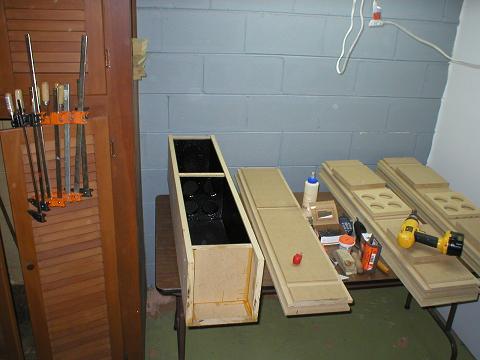

Haven't veneered the plinth yet... but just couldn't wait to show her off.
What I liked most about the original ProAc Response 2.5 were it's modest dimensions, equisite veneers, and D-tapered grills. Of course the sound was surprisingly good for a 2 way, but my own clones would also have to have a furniture fit and finish.
But I'd never built a loudspeaker before. So this turned out to be a 3 month labour of love undertaken over my summer (university) break.
I used page 2 of the 1996 Stereophile review as a reference for my own grill design.
What do think?
PS. More construction pictures can be found at my website. I like to call it the TroelAc 2.95 because it uses Troel's XO design for the D2905/9500 tweeter.

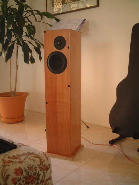

I was shocked that it sounded great without any further modifications. (I was very careful about wall damping and lining and followed the DIY website's directions exactly) I'd agree with Troels description of them-
"Coherence... transparency... but robust midrange...close to getting it all from this modest 2 way...quite amazing"
Certainly the treble is still sweet, but not raspy. Plucked strings are less amazing than the original, but pianos and violins are more realistic.
Woofer were run in (free-air) for about 100 hrs prior to installation. Tweeters however were not.

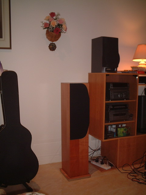

Some more pics
Here's some more pictures.
Neutral, laid back. Sometimes you even miss the excitement and crispiness of the original 2.5.
But I haven't found one piece of music that's intolerable or even "average" sounding. This speaker will never be fatigueing, but has enough detail to keep you interested.
I think it was Darryl Nixon that said that Troel turned the ProAc Response 2.5 from a "Wow, listen to that!" to a more of a
"Sit back and have listen to this..."

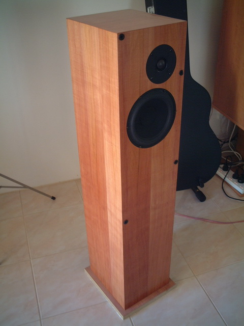

Someone please stop me... I'm getting addicted to posting pictures- admins- I hope i'm not breaking any rules...

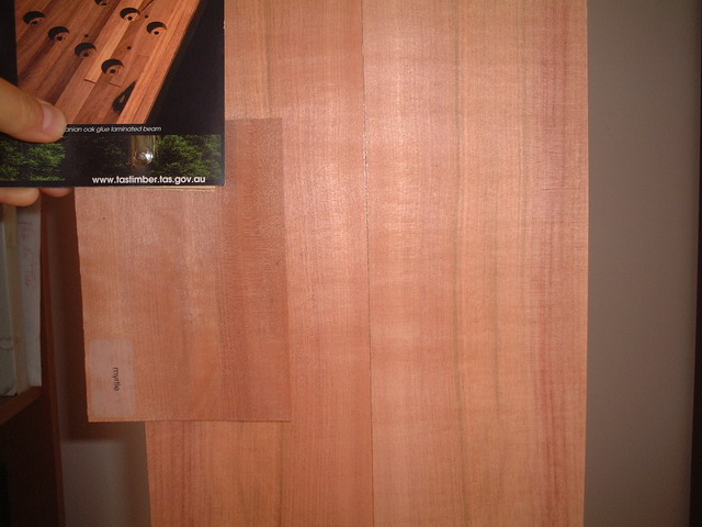

The problem with veneer splitting is not obvious unless during close inspection. However, because adjacent veneer leaves run in opposite direction, some lighting conditons will clearly reveal this.
I tried sanding it, but next time I will make sure my veneer grains run in the same direction.

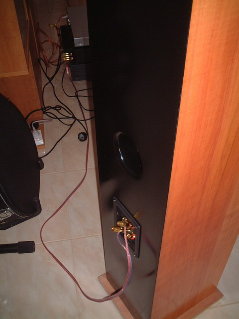

I flared the port, but did not change it's dimensions.
The difference is probably minimal in terms of port tuning and of no significance in reducing turbulence (it was a non-issue in the first instance)
I did it for 2 reasons- a) much more secure way than just running PVC straight through MDF b) it looks much nicer.
Idea by Wayne Jaeschke
That's it! Off to listen to them. If anyone's interested, I can post a final picture once I've finished the plinth. Actually, even if no-one's interested, I'll still post.

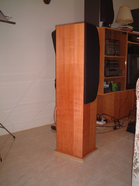

MITMechE,
the veneer is Tasmanian Myrtle, sometimes called Australian Cherry or Myrtle Beech. It starts out pink and I wanted to redden it to become a darkish mahogany colour like this:
http://www.tastimber.tas.gov.au/species/myrtle_01.asp
but it turned out this cherry colour.
I tried staining it but my piece looked stained, if you know what i mean. So I just used Danish oil (Rustin's) and a good quality paste wax (Liberon)

A few people have asked about the veneering and finishing techniques-
I must thank fellow Diyaudio'er Pete Mazz for his idiot-proof veneering guide. It is an excellent method. I haven't tried other techniques, but I have heard horror stories about DIY veneering.
My speakers are not as good as fine furniture, but given this is my first attempt I am very pleased. Use of thicker and wider veneer leaves will most likely alleviate the slight problems of splitting or bubbling. (Friends and family don't notice unless I point them out)
For finishing the timber I use a good danish oil, such as Rustin's, followed by a good quality fine paste wax to bring out the depth and shine. I used Liberon.
Here is the picture of the original veneered baffle, alongside a typical sample of Tasmanian Myrtle. It's good for showing the slight gap that developed during the veneering process.
As you can see, the Danish oil and wax worked well to hide the split.
