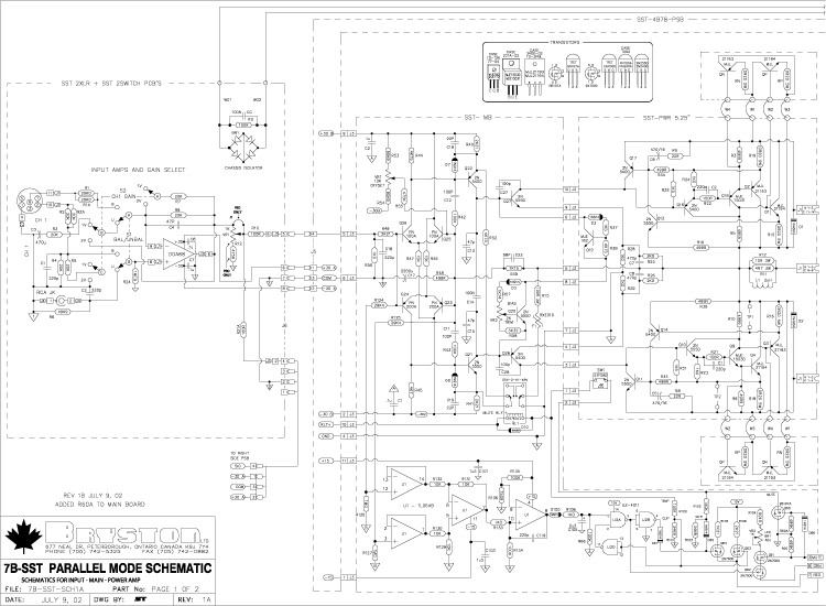

Looking at all these amps, the 7stt looks to be the best choice. It’s the newest and the output transistors in all the others are custom made for Bryston. The 7stt is a mono-block amp; however it contains two amp modules. They can be wired in series out of phase for more voltage or in parallel in phase for more current.
All Bryston amps use a variation on Bryson’s “Quad-Complementary” output section. This uses PNP and PNP transistors on both rails (see the schematic). I can and will post more on this later if the thread gets a good response. Over the years the schematic has not changed that much, but there are notable changes in the output stage.
I think for simplicity the clipping indicator module should be removed and the power supply is also going to need a bit of a trim. I’m not entirely shore if I can get away with removing the input section using the (DOA68) op amp (it’s not really an op amp chip) and just bypassing that section. The impedance of the amp hooking up the input right to r49 is less then 1k. This may have to be changed and is my biggest dilemma.
The schematic is attached below. It’s too big to be posted as a PDF. However if you look around, you’ll find it at http://www.bryston.ca/pdfs/7bsst_schematic.pdf

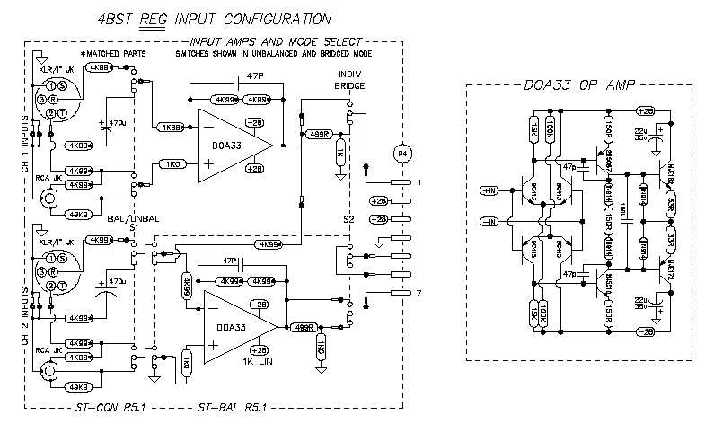

I’m happy to see that someone has already built this amp. You’ll find the schematics for the outdated st amps bundled in this document http://www.bryston.ca/pdfs/38bschem.pdf .I have two important questions I need answered.

Does your diy amp include the board at the back of the amp with the op-amps made out of passive components? It should look something like the pic below.

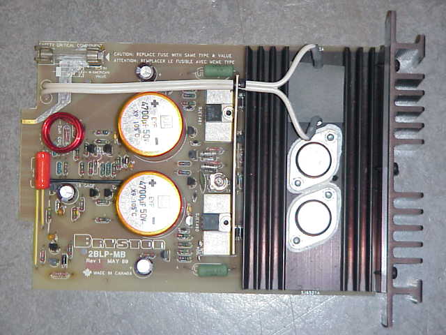

Besides the output power transistors (2n6031 and 2n5631) what else has to be thermally coupled to the heat sinks. Does the T0-220 devices driving the bases of the (2n6031 and 2n5631) have to be coupled? The bias stage uses one T0-92 device and one to-220 device if I have to guess I would almost certainly guess that the T0-220 has to be thermally coupled to the output devices.

2) no I did not include the opamp board
1) no the TO220 devices need not to be coupled to the output devices thermally in the 3B. They have a own heatsink in the 3B and in mine. They do not run very hot.
Ofcourse the TO92 in the bias need to be coupled thermally.

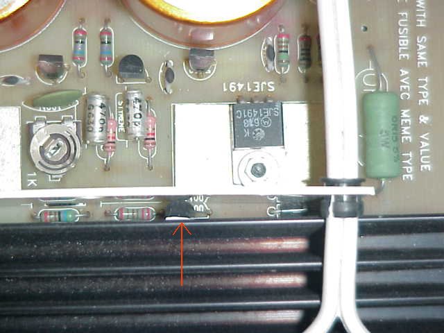

Does anyone have internal pics of the amp? I want to find out if any of the transistors have to be thermally coupled to the output devices.
Hi this has been somthing I have been thinking about for a while now ever since I found the PDF of all of the designs on the Bryston website.

hehe, ever look at the aleph2 schematic? i was like "where is the rest?" its pretty simple. but sometimes (most of the time), simple is better than complex.

That’s really surprising! Are you positive that it’s the TO92 device (2n5210) in the bias that needs to be thermally coupled and not the TO220 device (MJE180 (2))? I see what look to be a connector on the schematic but only for the TO220 device.
The low input Impedance of this thing without its buffer stage is going to be a problem. Did you make any changes to the input resistors to up it a little.

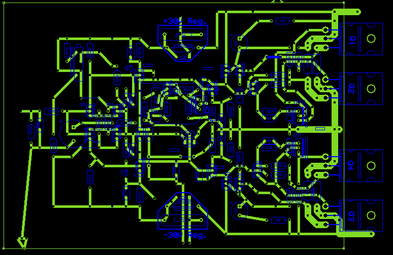

I plan to leave out the outboard set of output devices. That will halve the wattage and I’m driving them unbalanced, once more cutting the wattage in half, so it should be about 120 watts in the end.
Below is the first draft of my PCB layout done in express PCB. It still needs some work.

1) Yes I'm sure. I'll try to make a picture of the original 3B I copied to show you.
2) I use 47k-ohm which is the same value the 3B uses.

and here is a detailed picture of the TO92 bias regulator thermally coupled with heatsink compound to the heatsink of the output transistors, see red arrow.
Also visible (see also former picture) is the separate heatsink for the TO220 devices, barely touching the back of the TO92 bias regulator.
I also noticed that I mixed up the 2B and 3B, sorry for the misunderstanding.
