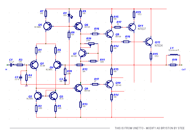

foundamental is the output stage
need just true complementary devices (hFE matched) :eek:

I just wanted to see how their output stage topo would perform, so I just made a simulation, using ordinary ltp with ccs, 2 transistor vas with ccs, and then slapped on that output stage. I can say that it is very prone to oscillations and not so easy to stabilize. But once compensated and stabilized, I was able to make an amp with 23ppm thd at 20khz on 8ohms, with rails at 40V and 25Vrms output signal.
I'm sure it can probably be even better with a few tricks and using other compensation scheme than plain miller.
That same sim gave me about 1.7ppm at 1khz, under the same other conditions, and down at 10hz, it was down below 0.08ppm (0.000008% thd). Not bad.
The key is to avoid oscillations, and as long as they don't start, then the signal is crystal clear.

I would agree with you about reservations. Do we know who designed this amp? It looks so much like the SWTPC designs that I wonder if it was the same designer or did they "borrow" it and add their patented output stage to claim innovation. It seems to add unnecessary complexity. The output stage looks like they couldn't make up their mind, I kind of laugh when I look at it.
Concerning those who commented about the patent, as I understand it, experimentation with patented designs is encouraged to promote further innovation. And people here do seem to be innovating.
I have many concerns about this design, there are 4 common emitter stages, but the first VAS has so much degeneration that it probably operates almost as common collector. The first VAS has 2.2K emitter degen wonder if it has much voltage gain at all? Then it has a speed up cap across it.
I could go on, but this design does not give me a warm fuzzy feeling.
