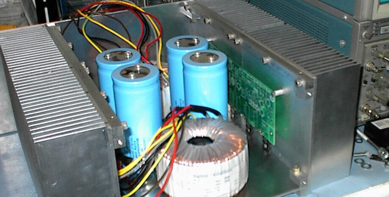

Both Christer and 5th Element are correct. I built the 160W OptiMOS but raised the rail voltages to achieve 180-200W. I will post some pics on my website before too long. I absolutley love these monoblocks. A couple of things that I've noticed is they are very resistant to power supplies...I have my PSU next to my amp PCB with no sheilding and there is not a hint of hum through the speakers. However, the chassis hums somethimes, but that is due to a lack of inrush protection...which cannot be blamed on the excellent OptiMOS.
200W produces amazing control in the bass and gives me exactly the signiture of sound that I'm after. It's perfectly balanced!
The 400W version is said to exhibit the 200W version's "same outstanding performance results". Randy Slone goes on to mention 6 bullet points of modifications. This require
Resistor changes
New rail voltages (+-85V)
New fuses (7A)
New MosFETs (SemeLab's Double-die BUZ901CDP & BUZ905DP)
New Heatsinks (0.2C/W)
The number of output devices stay the same (4 per channel) but the heat dissipation seems collosal for a Class B amp!
I would think you could build a 250-300W amp with little or no modifications to the circuit. It is very rugged. However, I would suggest modelling in PSpice and checking that no components exceed their rated specification.
Good luck and let us know how it goes! You'll be very pleased!

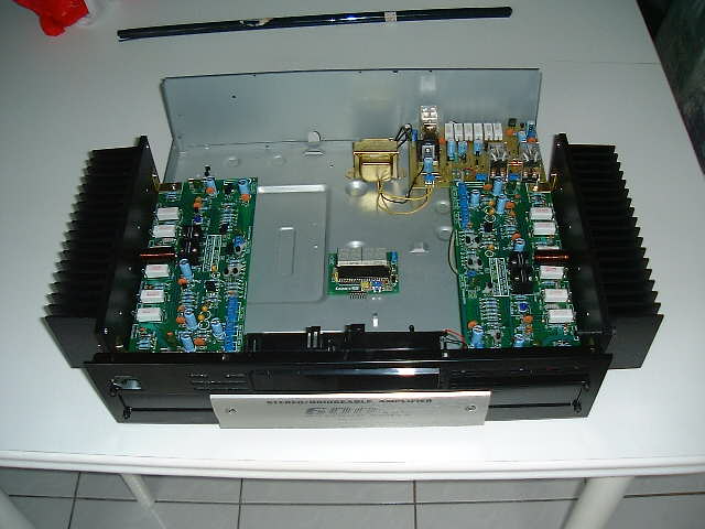

I've built a couple of his amps. Both were of the moderate power variety (125W or less). Single long tailed pair topology which I take to be Slone's variation on Self's Blamless amp theme. As a learning experience, I laid out the pcb's myself. It took me three tries and lots of learning. (I know know a bit more than before about parasitic oscillations and how to avoid them.) If you were to use Slone's PCB layout, I would not expect you to have the same problems (ore lean as much about parasitics) as I did.
I built these as parts of secondary systems (bed room and office). This was a mistake as I now prefer those two rooms for listen rather than my living room where amplifier duty is served by a 20+ year old Carver M400. Next major project is obviously an amp for the living room.
I'm leary to asign adjectives to the sound from an amplifier partly because of the over-blown prose one can read in high-end publications. Nonetheless, there is something about Slone's amps . . . . I guess they just sound real good.
I recently finished a pair of Opti-Mos boards and gave them a listen. In a word, OUTSTANDING!!! At least for my ears anyway. Because sound is subjective to the listener I won't tell you to rush out and build one but quite simply it is the best amp "my" ears have ever heard. Audio has been a hobby of mine for over 30 years and I've owned a listened to quite few amps. Briefly what I heard was the smoothness of a tube through the midrange and top end with the punch of solid state on the bottom.

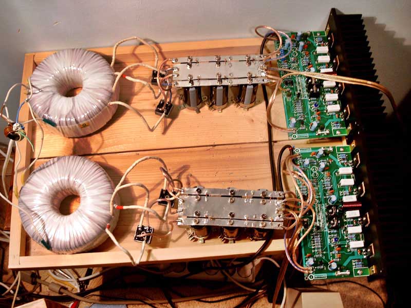

Yep - I built a dual mono version with dual power supplies and my own pcb - it doesn't look as nice as your's under the hood.
I had some problems with oscillation at first and blew an expensive tweeter. Got it to work with some help from Randy.
I also made a few circuit changes of my own. Fab sound now.

I had some problems with oscillation and hum. The oscillation might have been due to non-Hitachi devices, or using a self etched pcb. I got the MosFets from Rapid Eletronics in the UK but they were described as Hitachi so I don't know.
To elimante the hum I actually went to an extreme of building a dual mono supply with two torriodial transformers and rethinking the grounding and internal wiring. I learnt a lot about this sort of noise in the process and could probably go back to a single 500va 50-0-50 transformer - however given that it sounds superb the motivation to do so is low.
Elimating the oscillation was a lot harder. I tried all sorts of things, some still remain, however the eventual fix was simply to increase the size of R23 & R24 gate ressistors to 1k on the 2sk1058 MOSFETs. This looks unbalanced to me, given the gate resistors on the 2sj162 mosfets are only 470ohm. I've seen another approach which is to add a capacitor to even up the gate capacitances. Examples using a capacitor seem to use a range of values anywhere from 30-300pF. I don't know which is the better approach but would appreciate any advice on this subject.
Here's the link to the circuit that I built, it's actually dated 0ct 2001 and revision 2, the pcb is from his audio projects book.
http://www.sealelectronics.com/kits/images/OPTI1001.pdf
Before arrived at this solution I made some other changes in my hunt for the cause. I stripped out all the protection, converted the softclip VAS cascode bias into a standard zener regulated bias arrangement and changed the NFB take off point.
A few of my component values are also slightly different, e.g. 1000uF for C10 the NFB DC block capacitor, 220pF for C12 & 14 the larger of the miller compensation capacitors. I lowered the mosfet source degen resistors to 0.22 ohm, I read somewhere that lower is better (true or false?) but given that the mosfets appear to be not well matched I should maybe change them back to 0.5 ohm?
I lowered R3 & R14 to 4.7K to increase the zener current flow on the input stage cascodes because I wasn't seeing a stable 24V there.
I recently also increased the input resistance to 22k and have lowered the gain to 23x because my pre-amplifier is putting out quite a high signal.
I have a couple of questions about the circuit that puzzle me, I don't get why the collector resistor on the input stage cascode is 1k on the -ve differential input and 2.7k on the +ve input.
The differential tail currents also seem low to me, i.e. 0.6V/470 = 1.3ma and I'm tempted to lower R6 and R13. Many of the examples in his power amp manual have a higher tail current source of around 4ma or 2ma per leg.
Nick
