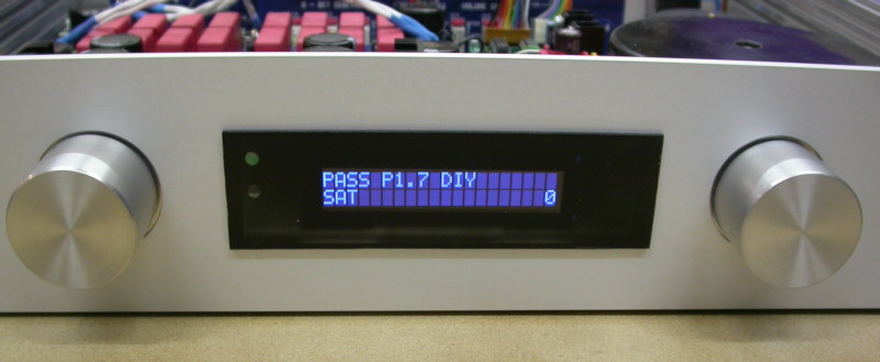

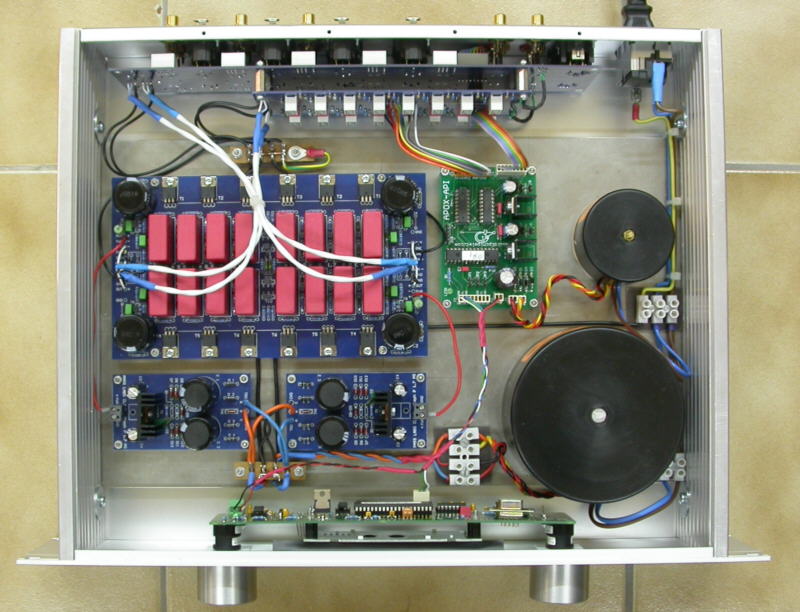

As promised some pictures of the P1.7 with the APOX interface. APOX IR interfaces with API board that provides all voltages (5V & 12V) and controls input and volume relays. The APOX components work just fine - the embedded software is excellent and easy to configure.
boards
Rodd, we (four friends building four P1.7s) used the APOX IR (display, input etc.) and the 'API' board that Craig/Dale from APOX made for us based on our requirements/specifications. The API board interfaces with the 'standard' PASS volume ladder board (as per the P1.7 diagram) and our homegrown input/output board. Both volume and input/output board were done by Kristijan (PCB-Design) based on our designs. The P1.7 board is 'off the shelf' from Kristijan, the two power supply boards are from Kristijan but have been modified to the original P1.7 power circuit.

Thanks for the nice comments. It helps building in a team - and no, I am not Peter Daniel's brother but admire his work and the numerous tips and hints he is providing (e.g. on tooling, metal work).
Paul, the sound (lack of) is very nice. Very detailed, good soundstage and firm control. It was a big improvement from my old Classé preamp to the P1.7 (almost as big as the step from the ZENs to the Aleph5s).

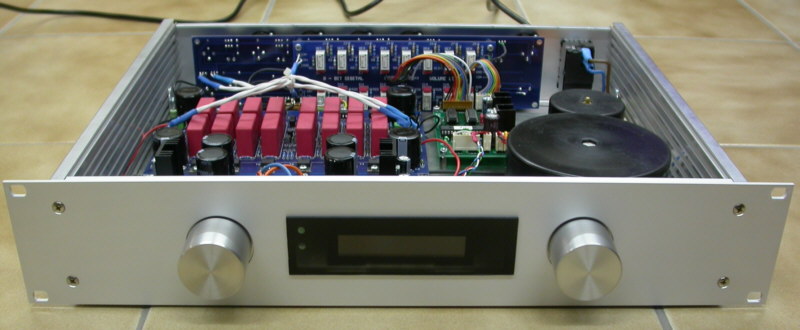

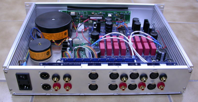

Thomas, please find attached two more pictures.
