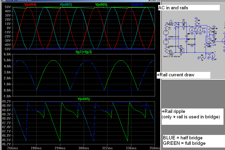

pacificblue, here are some waveforms.
The transformer for both cases is 35-0-35 (50V peak), practically ideal. Putting in parasitics gives an even greater advantage to the bridged amplifier.
Capacitors are 2x15mF, one per 50V rail in the half bridge amplifier. The full bridge amplifier has only one 15mF capacitor on its single 50V rail. The rectifier is a center-tap two-diode full wave in the bridge amplifier, not that it matters.
The load is 5A peak at 25Hz output from the amplifier. (for example 8 ohms driven to 40V peak) Mains frequency is 50Hz.
Here it can be clearly seen that peak-to-peak ripple voltage is the same for both amplifiers even though the half bridge needs double the amount of energy storage. If parasitics, mainly those of the transformer, are modeled too the advantage of the bridge amplifier grows even greater.
The ripple on the negative rail looks the same as on the positive , just out of phase, so its plot was omitted for clarity.
RMS ripple current in the capacitor of the full bridge is about 150% of the ripple current in a single capacitor of the half bridge. (Or 75% of the total ripple current if you want to look at it that way)

Looks like the same peak value and half the rms value on the non-bridged amplifier to me. Do you agree that the ripple factor is Vripple(rms)/Vdc as defined e. g. on Wikipedia? Then the capacitor needs to be double the size for the single supply bridged amplifier to achieve the same ripple factor. And to answer your question, I do know, what happens with series-connected capacitors, which makes me suspect that you come out at four times the capacitance with a split supply bridged amplifier.megajocke said:The ripple on the negative rail looks the same as on the positive , just out of phase, so its plot was omitted for clarity.

In both cases the peak of the PSU current (see that diagram again) is 5A. The bridge amplifier draws 3.2A average while the half-bridge needs 1.6A average from each side of the supply. There's your higher peak-to-average ratio in the half bridge.
More importantly, it's the same ripple valley voltage, and this is what the amplifier cares about as the amplifier clips instantly if supply voltage drops under what it's needing. The amplifier doesn't care about Wikipedia's definition of "ripple factor".

"The peak-to-average ratio of PSU current is double in a half-bridge amplifier compared to a full-bridge." You keep repeating that. Is there any chance that you support it with an explanation, a link, a reference, anything?
There you have it. And double the current needs double the capacitance for the same performance. That is, what AndrewT and Jan Dupont pointed out in the original thread and what I agree to.megajocke said:Power consumption is the same...

The don't have to be in phase for it to be better. Try simulating or measuring it.

I wrote TOTAL. It's ONE capacitor instead of TWO. ONE capacitor with DOUBLE the dissipation will give the SAME total dissipation as earlier. This is only a problem if ripple current rating were on the edge to begin with. Do YOU think "it is good to use capacitors or other components at their limits"?
Or use 1.4 times the capacitors in the bridge amp, keeping ripple current in each the same as earlier. It is still a smaller power supply.
pacificblue said:There is no such thing as better PSU utilization. What goes in, goes out. If you think, it is good to use capacitors or other components at their limits, you can do that in a non-bridged amplifier just the same.
Have you ever heard of power factor?
A half bridge amp delivering a 5A peak sine from a +-50V DC supply:
Delivers 5A * 0.707 = 3.5A RMS to the load
Draws 3.5A * 0.707 (half wave) = 2.5A RMS from each supply
Draws 5A / pi = 1.6A average from each power supply
50V RMS * 2.5A RMS = 125VA per side, 250VA total
50V * 1.6A = 80W per side, 160W total
A full bridge amp delivering a 5A peak sine from a 50V DC supply:
Draws 3.5A * 1 = 3.5A RMS from the supply
Draws 5A / pi * 2 = 3.2A average from the power supply
50V RMS * 3.5A RMS = 175VA total
50V * 3.2A = 160W total
Power drawn is the same, but RMS current and apparent power delivered to the amplifier from the power supply is 40% higher in the half bridge. This needs a somewhat bigger power supply to keep losses and ripple down.
