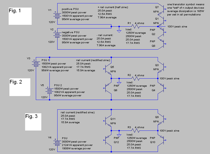

From the higher peakiness. The power factor on the DC side of the PSU differs by a factor of sqrt(2) between the both cases. Look at those numbers in post #16 where power and apparent power on the DC side is calculated. For sine wave output it is 0.91 for the bridge amplifier and 0.65 for the non-bridged.
The power factor on the primary side of the transformer is the same in both cases, if you wonder.
The non-bridged amplifiers has two such power supplies. The total ripple current is higher because of the higher total RMS current (or apparent power) on the DC side of the psu.pacificblue said:I am really at a loss now. In post #16 you wrote yourself that the non-bridged amp draws less current from each rail. How can its ripple current be higher, then?

This chart illustrates the difference. PSU peak power is *double* in the half bridge example, figure 1, compared to the full bridge with the same number of power supplies, chart 2.
This is why less total energy storage is needed in the power supply for the same ripple at low frequencies.

While I have not followed every post and calculation, I think Megajocke is correct (or at least largely correct). Because a bridged amp draws power for the full cycle from each rail (instead of for just half the cycle), the amplifier will have a higher (better) power factor. This can be seen in the specs for Crown's bridged amps. Crown specifies the power factor (real world) as 0.85 for their bridged amps while a conventional amp cannot exceed around 0.72.
So yes, bridging does change the AC current waveforms in the power supply to be more efficient just as Megajocke has said. For the same power output, you can use a transformer with a smaller VA capacity in a bridged amp. I think this is one of the main reasons so many pro amps are bridged. It saves money and makes the amplifier lighter.
It is the peak power from each power supply that is higher in a half-bridge compared to the full-bridge. (see the chart in post #27) The half-bridge needs two power supplies with the peak power ability of the whole PSU of the bridge amplifier.
At low frequencies this peak power draw lasts for quite a long time, and during that time the amount of ripple depends on how high this draw is. This is why there is an advantage at low frequencies for the bridged amplifier.
Power factor (which is not often mentioned for DC circuits as it is 1 in most cases) was just calculated by the amount of watts and VAs consumed from the power supply. Bringing it up seems to just have confused matters though. It doesn't matter much, just look at the absolute numbers if that feels more comfortable.
Of course there are disadvantages to bridge amplifiers, like that you must have transistors in series. At low supply voltage bridge isn't a very good idea because of this. But at 120V+ you need to series transistors anyways, for most common transistor types.

In your example the half-bridge amp needs two 8V 1A supplies while the bridged amp only needs two 4V 1A (equal to just one 8V 1A) supplies.
Neither have I written anything about amplifiers being treated like rectifiers.
The RMS values of full wave rectified sine and a half wave rectified differ by a factor sqrt(2).
Energy storage is work. W = P x t = P / f. The power consumption is the same. And the frequency, with which the capacitors are recharged from the rectifiers is also the same, as is the wave-form, because we assumed full-wave rectification. So you obviously need the same energy storage in the power supply, whether the load is a bridged amplifier or a non-bridged amplifier.
If the power remains the same and P = U x I, you need double the current, when you use half the voltage. With energy storage being W = ½ * C * V² that means you need four times the capacitance, when you use half the voltage.
The rms value of the ripple voltage gamma = 1 / (4 * sqrt(3) * f * C * R). Since the power is the same, but the voltage is halved, R is quartered for the bridged amplifier. If you want the same ripple voltage, you need four times the capacitance. Less capacitance means higher ripple voltage. That is the practical application of energy storage.
There is no improvement for lower frequencies in bridged amplifiers. The ripple voltage changes with the amount of current, not with the frequency at which current is drawn.
Ripple current Irms = sqrt(Ichargerms² + Idischargerms²). The charge current through the rectifiers is doubled, see above. The discharge current through the amplifier is sqrt(2) times higher, see your post #16. Therefore the ripple current is sqrt(6) = 2,45 times higher for the bridged amplifier, which means the capacitor(s) for a bridged amplifier need a higher ripple current rating.
Crest factor or peak-to-average ratio is a non-issue in unregulated power supplies. All components in unregulated power supplies can easily deliver peak currents that are much higher than their rms rating. Crest factor is an issue with current limited, i. e. regulated power supplies. In that case the bridged amplifier might have an edge, but we were not posting about regulated power supplies, were we?
