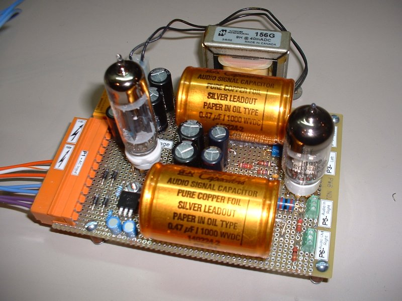

Here my new tube voltage gain stage for my new DIY DAC. It is using a HV 6X4 Tube rectifier and a double triode Svotek 6922. The 6922 is using DC filement voltage using schottky rectifer and LM317T regulator. The HV is filtered using a CLC filter with two 47uF cap. an a Hammond 9H, 40ma choke.
Coupling caps
And I just forgot. I'm also using in the signal path all copper Riken resistors and the very good Jensen copper foil and silver lead.
I will listen to this beauty soon...
Comments are welcome. Any suggestion on my tube choice will also be appreciated.
Don't be too hard on me, it is my first tube circuit. Better late than never.

And a few measurements
Since the DAC is not completed, here a few measurements to test everything:
Bandwidth (0.767V, 1Khz reference): 20Hz-300Khz in 50 Kohms
Voltage Gain (in 50Kohms)
0.5Vin = 22.5
31.6mVin (Vout=0dB) = 24.2
Distorsion (in 50Kohms, Vout 0.767V)
100Hz: 0.5%
1Khz: 1.2%
10Khz: 1.4%
20Khz: 1.5%
Are these values of distorsion typical or an other tube brand can give me better values?

Re: Coupling caps
You know that those caps have outer foil marked and I found that when outer foil is directed towards the load, it sounds better.
Algar_emi said:And I just forgot. I'm also using in the signal path all copper Riken resistors and the very good Jensen copper foil and silver lead.
I dont know the exact Engineering on those caps but its almost like they are polarised like an electrolytic cap and what peter has said seems to be true....and to comment on your distortion levels....isnt that what your looking for in a tube design?????....that does make the nuiance warm and proprietary with a tube design.....Live music is never perfect and audiofiles are ultimatley trying to re create a live performance not a mixed studio version

Hmm.. i think i know those sockets(maybe). I have a couple of them myself. Both the ceramic and the type used for the 6DJ8.
I bought mine at www.demostenes.no, the price was about 4 Euro.
The socket used for the 6X4 is a good ceramic socket but the socket used for the 6DJ8 tube is in fact not ceramic, it's some kind of plastic material. They are not very good
for tubes producing much heat(small output tubes). I used some of those sockets in an EL84 amp and it did actually melt a little bit because of the heat

Found my problem with 6922
I found the problem with the high distorsion. It was the tube. Hey guys, I begin to understand your love of tubes. It is so easy to unplug the bad one and try an other ones!
Anyway, all my others 6922 tubes test like this (pretty consistent also, incredible for a transistor guy like me :
Distorsion (small signal 0dB, 0.767V in 50Kohms, 1 kHz):
0.3 to 0.5%. I will use the 0.3%

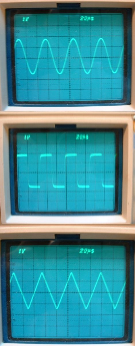

Soft Clipping and Linearity
I veryfied indeed that the tube go softly into clipping and can drive a lot (in high impedance at least):
Check also the good linearity indicated by the slight variation in the gain.
Distorsion (indicating clipping coming into effect):
Vin(V) Vout(V) Dist(%) Gain
0.03 0.767 0.3 25.6
0.22 5 0.72 22.7
0.43 10 1.05 23.5
0.87 20 1.9 22.9
1.38 33.8 3.0 24.5 (no visible clipping)
2.00 44.6 3.6 22.3 (begin to see it)
2.78 57.7 5.5 20.7 (clipping, see gain is dropping)
This picture is showing the clipping just beginning at 57.7V

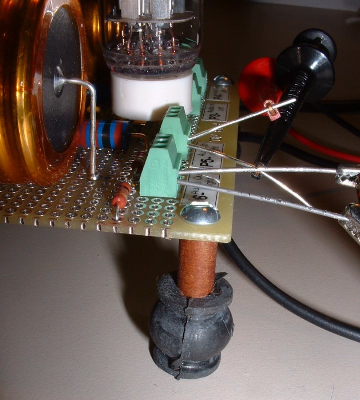

Microphony and Vibration
The svotek 6922 is not that sensitive to shock (microphony). Here a small suspension that I want to implement for the tube PCB. They are small rubber post that I found in a surplus store.
I can see small jump in the noise level when I knock on the table where the PCB rest. Vibration effect dissapear when I put the PCB on the rubber post, Great.

What's the quiescent current through the tube stage? From personal experience, I've found that less than about 4 mA through a 6DJ8 tube can crank up the distortion figures and lead to less than ideal sound. If you crank your bias up, your distortion figures may drop even more.
I use a pair of 6DJ8 type tubes in an SRPP configuration with cathode degeneration in my tube DAC. I like it and lots of others seem to enjoy it as well. The SRPP stage also has a low output impedance which can be a big deal depending on your cable lengths and cable choices.
