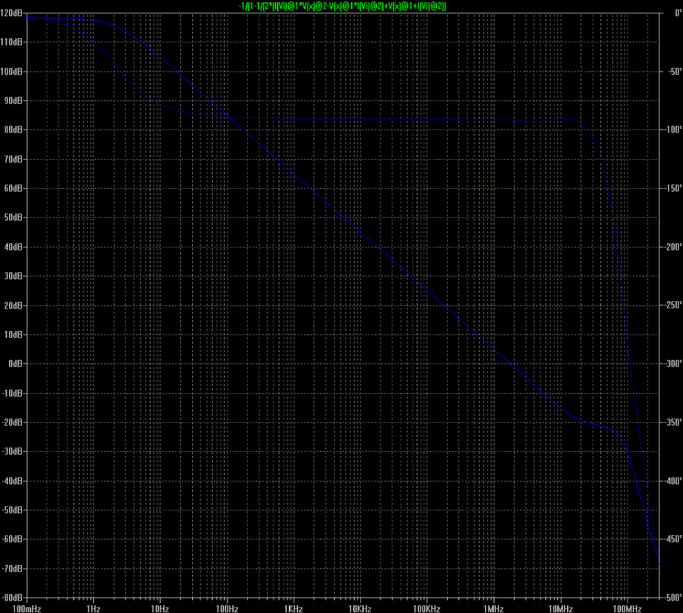

The theme of this amp is hi loop gain so that distortion
can be so low that the main problem is choosing parts
and layout.
What motivated me was that maybe the ear really has a
wider dynamic range than we can believe. Therefore why
not push distortion as low as possible?
The 0db point is around 1.8Mhz and OL gain is around
118db. It looks like things should be stable (see attached
loop gain diagram) in theory. Don't know about practice
which is one of the main reasons for me posting this.
I'm no super expert just a hobbyist, and I asked Bob C.,
and Andy C. for early revue on this, which they both
graciously provided.
I'll post more stuff as I get it formatted and uploaded.
I may be a little slow due to my workload.
So far it has just been simulated in LTSpice. I know Spice
can only go so far.

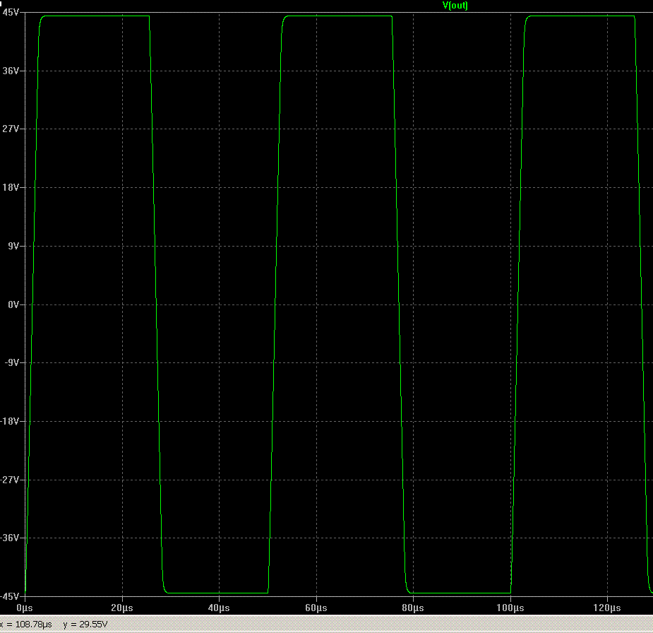

Thanks for the comments regarding NDFL. I was cautioned
by both Bob and Andy about this. Both mentioned using TMC.
In Sim, I didn't seem to run into any problems even with
capacitve loads up to 4uF // 1 ohm.
Attached is a ~45v 20Khz square into 4uF // 1ohm.
I saw more problems using a bipolar output driver like the
MJE15034. This was harder to control. Using the ECX10N16
in this position was easier. Maybe this is a modeling issue?
Mike
Keep in mind that mosfets in reality are only slightly faster than bipolars.
Your slew rate is so-so, expect stability issues as if you ued all bipolar amp, such a simulated waveform on capacitive load usually means wild oscillation in reality.
Don't get me wrong, some schematics are just easier to put into real-life working amplifier with no strange phenomena expected, yours is not.

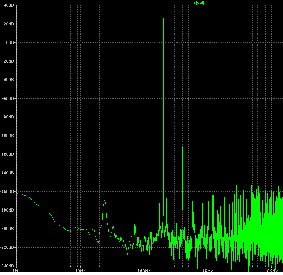

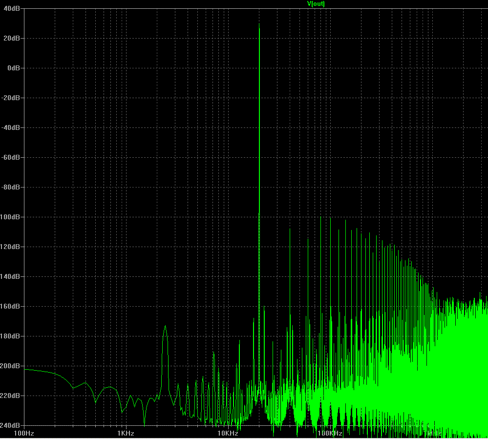

Looking at the 20Khz 45v sim you can see the
4th harmonic comes in around -99db
3rd harmonic around -114db
2nd harmonic -107db
I looked at removing or simplifying several of the mechanisms:
A. Simply removing the CFP, and everything else the same moves
the 3rd harmonic up to -74db.
B. Simply deleting the NPN from the super pair (don't know
what else to call it???) and going straight into the PNP (no longer
a super pair), and eliminating the small 20 ohm emitter resistor,
everything else the same moves the 2nd harmonic up to -58db.
C. Removing the NDFL cap, changing the local 2pf cap to 120pf,
so we have roughly the same 1.8Mhz 0db point, everything
else the same moves the 3rd harmonic up to -57db.
These aren't additive. Looked at removing a combination
of mechanisms.
Removing A. and C. and everything else the same moves
the 3rd harmonic up to -56db.
Removing A. and B. and everything else the same moves
the 2nd harmonic up to -56db.
Removing B. and C. and everything else the same moves
the 3rd harmonic up to -55db.
Removing A., B., and C. and everything else the same moves
the 2nd harmonic up to -55db.
So it looks like they all work in conjunction with each other.
