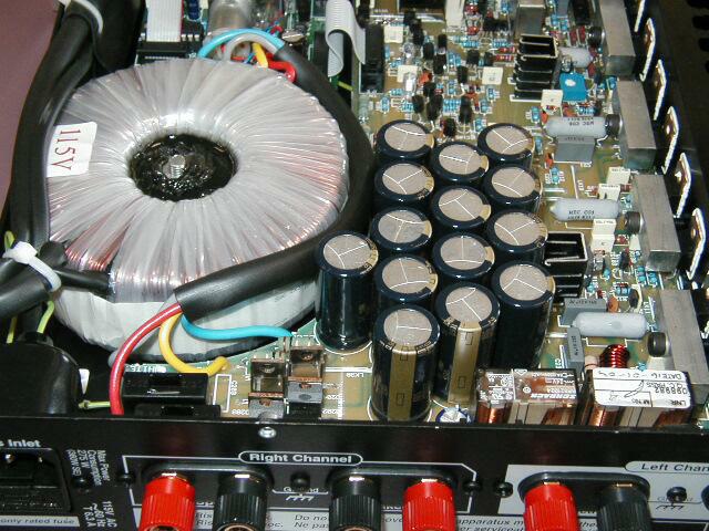

Shown is the part of the supply in a McCormack preamp.

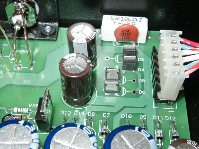

There may be some conventional diode for the Digital volume control interface. I have seen high speed diodes in several McCormack products. Steve was one of the first to do this in commercial products. i think the high speed diodes were from Harris.
Picture of 100 volt Shottkys and paralelled Panasonic FCs in Creek integrated.
