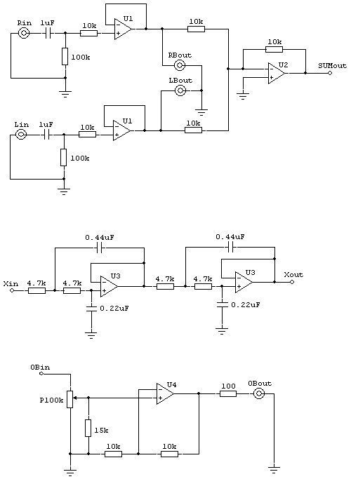

I'm planning to build a DIY subwoofer amp. As the first step, I collected informations on active crossovers from the internet and came up with the following circuit. It consists of four sections: input buffer, mixer, two R-L filters in series, and output buffer with volume control. Because this amplifier will be used with my DVD player, which has only one pair of audio lineout (left and right), it needs to have a pair of buffered outputs which will be connected to my receiver. My reciever doesn't provide any lineout connection. The target crossover frequency is ~100 Hz which is pretty close to the value (109 Hz) from the resistors and capacitors shown in the circuit.
I will make a PCB for this amplifier and would like to make sure that this circuit will work before I print out the PCB layout. So, any recommendation and suggestion will be appreciated. Thanks.

I think you mean "RC" not "RL."
In any event, the first thing that strikes me is that you've got the possibility for the opamps to lose their DC ground reference. There's also the potential for some major pops and bangs should some connections get loose.
Tie the buffer input to DC ground with a meg or so resistor. Tie the Xin inputs of the filter blocks to DC ground the same way.
A more global question is what acoustic crossover you're aiming at; it's rare that a desired electronic response will give you what you want acoustically unless you take the speaker's acoustic responses into account. What are you using for an upper-range speaker? Ported or sealed? f3?
Thanks for the reply. What I meant by "RL" was "Linkwitz-Riley". I should have written "LR" instead of "RL". :)
It's hard for me to understand why the opamps could lose their DC ground reference. Could you tell me more about it, please?
Actually, many part of this circuit came from Rod Elliot's website. This circuit is almost the same as the low-pass section in his electronic crossover design except for the summing amplifier which was copied from another project of his. One thing strange is that he didn't mention anything about "DC ground reference" problem. Maybe he's missing something? I thought his design is VERY reliable. Maybe not.... I don't know. :confused:
If your Xin is not connected to something with a DC ground reference (a cable not plugged in, for example, or a cable pulled out- these things happen!), the noninverting input of U3 will not have a DC return path.
BTW, I was somewhat unclear about the buffer- when I said to tie its input to ground via a large resistor, I meant at the input jack. That way, the end of the coupling cap isn't floating, a likely source of some nasty bangs.

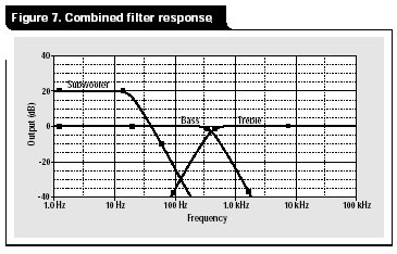

According to the TI application note, +20 dB higher gain is given to the subwoofer section than the higher frequency range. I'm wondering if this is a general rule of thumb? I attached a figure from TI on the following post.

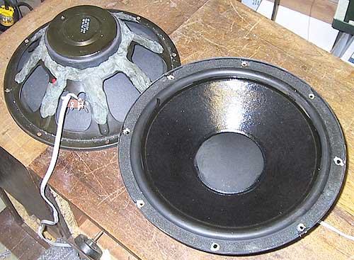

miguel2 said:
I cannot give you information about the driver because the only things I know is that it has 30 cm diameter and is from Philips.
Here is a pic of some similar Philips (same but 8 ohm IIRC) drivers i put in an aperiodic push-push sub. They have been puzzle-coated & ductsealed for improved performance.

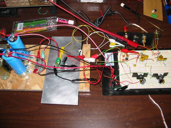

Finally, I completed DIY subwoofer amplifier on a breadboard. Input section consists of two buffers (L and R) followed by a summing amplifier. Crossover is two Linkwitz-Riley crossovers in series. Output stage is a buffer with a gain of two. Volume control is done at the output buffer stage. All the Op-Amps are TL072s powered by LM317 and 337. Power amplifier is OPA549 and OPA541 with a gain of 20 dB. I still haven't decided which power Op-Amp to use in the final design. Right now, I only have a small subwoofer which came with my PC. So, it's difficult to say anything about the sonics. But, it sounds OK, so far.

do you have a circuit diagram?
