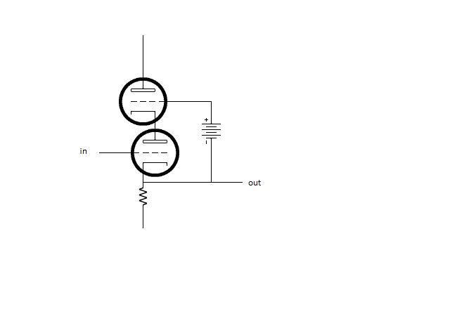

I have been experimenting with using cathode followers as output stages. Fixing the plate to cathode voltage seems to remove most of the distortion components created in the tube. I believe that it has to do with removing the voltage related parameter shifts inherent in the tubes, but I am still experimenting.

I have read and reread this paper, and I have come to the conclusion that I must build an "acf-2" or an "acf-3" or both, only using somewhat BIGGER tubes. Then I must "test" it in true Tubelab style. As I am leaving town in a few days my "testing" will be confined to the simulation world for now.
Stack another triode on top of the CF and drive its grid with the output, level-shifted so that the CF has enough plate-to-cathode voltage to operate. I'll see if I can find a Tektronix schematic that shows how it's done- it was a common trick for scope design back in the '50s and '60s.
edit: Here's a quick conceptual sketch
A normal cathode follower has a very high PSRR to plate voltage variations, meaning that the plate voltage can move around a lot without causing a serious change in the output as long as there is enough voltage for the tube to work. In a normal circuit the plate voltage must be high enough to so that the largest signals may pass unclipped. This means that there is usually a fairly large voltage across the tube. The plate voltage is usually fixed, and the cathode voltage varies with the signal voltage. The parameters of the tube vary slightly with the applied voltage causing small distortions of the signal.
Now suppose we could devise a circuit that moved the plate voltage in step with the signal voltage. Tha K-P voltage in the cathode follower would remain constant over all signal conditions eliminating these small distortions. Most agree that the small distortions created in the small signal cathode followers seen in typical audio designs are far below the distortion created in the output stages. The added complexity needed to "modulate" the plate voltage is probably not worth the effort.
But, what if we are designing a cathode follower output stage? Now we have the opportunity to design an output stage with virtually no distortion. Fixing the K-P voltage offers us another benefit. It is now possible to greatly reduce the power dissipated in the output tube.
How do we do this? The simplest way is to add another follower (tube or mosfet) between the output tube and the power supply and drive it with a shifted (zener diodes) version of the drive signal. It is also possible to design a complex SMPS do do the same job. I have built several versions of these circuits and they do seem to offer some serious improvements in an output stage at the expense of circuit complexity. I plan to post some of my circuits on my web site when I return from an impending trip, and have some time to document them. I am enclosing one of my simulation schematics to illustrate the technique.
This thread has made me aware of work done along these lines back in 1957 by J. Ross Macdonald. His work is centered on low power applications with very high input impedance (many megohms) and low output impedance (5 ohms) with very low distortion, all accomplished with 12AX7's and 5687's. These attributes are accomplished with multiple cathode followers and a feedback loop. I believe that this work can be used to create a very serious cathode follower output stage.
Read the Macdonald paper and decide if the added complexity of this circuit can be of use to you. The "cathode follower" that I am building contains 5 tube sections.
