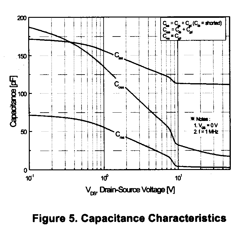

I agree with Ian on the Mosfet CF drain voltage at 20V or more above max signal peak being sufficient to remove the need for a drain follower on top of the Mosfet. The Mosfet looks like a very high Zout pentode (so no plate fdbk to worry about) and the variable capacitance issue is largely gone with sufficient drain voltage. (The gate input capacitance is bootstrapped out besides in CF mode.)
I have attached a capacitance chart from the FQP1N50 datasheet (no affiliation, etc... just an excellent part for tube circuitry. I don't think Fairchild will mind me copying just the cap. chart from their copyrighted data sheet, probably sell some parts for them. )
Above 10 volts, the capacitance is pretty much minimal and stable.

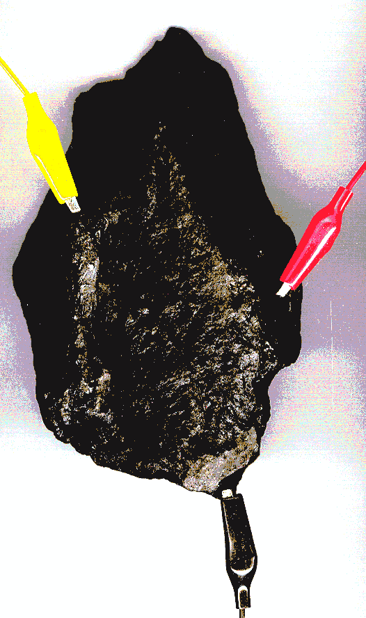

Nah.., I found it while kayaking the Catawba river here near a R-R bridge on the banks, probably from the steam-engine railroad days. Measures over 2 megohms across 1/16 inch. Obviously needs some N or P type doping. I need some naturally occuring N and P type coal with lower resistance.
Probably easier to make a coal FET, just need N type coal and then plate some copper on it for a gate.

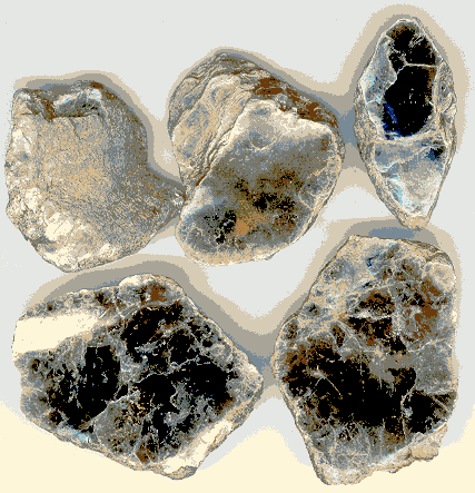

Lots of Mica around here for making tubes:
