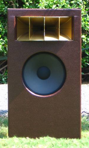

I have been running a similar rig, see the photo below.
Much like yours without the top half. 811 horn instead of your 511. Selenium 15WP3 instead of the Ushers. The Selenium has a higher Q, about 0.6, so a little more bump on the bottom end than the Ushers.
My rig has NO bottom end without massive FR tapering. Gobs of beautiful mid bass, sounds fantastic on orchestral works, but real low end energy just isn't there without bass boost under the baffle roll of frequency.
Of course your big baffle and corner loading will help a lot, I'm just curious how much. Mine, with side wings, started to roll off fast under about 150Hz. Since your baffle is taller, but about the same width, I'd guess yours rolls of under ~100Hz.

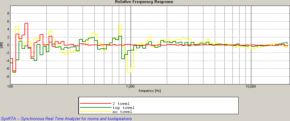

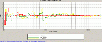

Reason I ask is that I measured a rather nasty 900Hz kink in my 811 horns on a similar baffle. My 811s are mounted with the flange behind the baffle, your 511s with the flange in front, but otherwise similar.
What I saw - and heard - you can see in the crude graph below. How did I get rid of it? Towels! Placing a rolled up towel along each edge of the horn smoothed out the 900Hz ripple. As you may be able to see form the graph, a towel was need both top and bottom - just one didn't get it. A first I thought it was the 15" resonating into the lower lip of the horn, but the ripple happens on top, too.
All you need is four towels and some tape (to hold the lower ones). If you are playing music or pink noise while you put the towels in place, you will certainly hear the effect. The towels do no go over the horn mouth at all, just around the edges.
