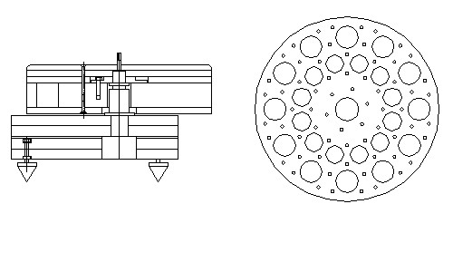

I've posted this topic over at the Vinyl Engine and many platter material postings on AA but with limited responses. Maybe I can gain some new prespectives and insights on this forum.
DIY TURNTABLE PLAN
Buy the Teres maxxon motor ($400)
Buy Teres inverted bearings ($250)
My best friend is a master machinist and shop forman for the Univiersity of Colorado research lab with 15 years experience. I'm going to enlist his aid to manufacture the platter, plynth and possibly a separate tonearm pillar.
Platter: Sandwiched layers starting from bottom. 1" black PVC-1" alumunum-1" black PVC. Professional Plastics say they do have 1" PVC black in stock. (question: 12" platter the correct size?)
Plynth: Sandwiched layers starting from bottom. 1" Alumunum-1" black PVC. Maybe another 1" alunumun layer on top of that too?
If I were to build an armboard attached to the plnyth it would be another sandwiched layer of pvc and alumunum. Black Racing cones for the feet.
Tonearm Pillar: Stainless, Alumunum or Brass 4" cylindar. Filled with mineral oil coated lead shot. Mounted on Black Racing cones.
Options for Plynth and Platter:
Use stainless steel instead? Alumunum is 14 lbs per sq foot
1" STAINLESS T-304 ANNEALED HRAP PLATE is Weight/square foot: 41.328 pounds
0.5" STAINLESS T-304 ANNEALED HRAP PLATE is Weight/square foot: 20.664 pounds
Further resonance control: I was thinking of using that damping material sold at Parts Express. have a 1/2" thick groove carved into the bottom of the platter and run a strip of that stuff along it. This should help I was told. Maybe some of the bottom of the plynth also.
Placement: Grizzly Industrial - search on part #G9654 for this 154 lb. plate granite slab.

Interesting laser table
That laser turntable is quite interesting but I'm in no way interested in my analog sound touching an ounce of digital.
I can't wait to get away from transistors and build my Bottlehead tube preamp and phono preamp.
I was looking over the weight of alumunum and stainless steel. Looks like stainless is twice as heavy at half the thickness. I have no idea what the sound properties of the two is or the resonance so maybe I should stick with Alumunum since thats the common material used by $2000 and up turntables. Here is a listing of what some of the $2000 and up turntables use for platters.

I'm planning to make my platter sandwich comprising 1.5" aluminium base filled with leadshots/oil bolted together with several layers of 10 mm acrylic (Redpoint style). Bolts make the layers replacement experiment possible, and provide good path for vibrations to be sunken in leadshots bath. Recently I'm trying to reduce the aluminium base machining cost compartible with Teres ledfilled platter.

NOTTINGHAM
The idea of using graphite as a material for a TT mat was given to Tom Fletcher by me after I reported the excellent results I had with this on my own Mentor Reference TT.
It has the added advantage of effectively ridding static charges of the records.
The soft alloy you are referring to is actually Zamac,an alu alloy.
The outer rubber rings we used already on the Dias TT,these deaden the platter very effectively without compromising the springiness of the platter in the vertical plane.
Nottingham Hyperspace The 'mat' on the interface between the record and Hyperspace is a 25mm thick
graphite platter - which, when married to the soft alloy underneath and coupled by the three anti-expansion rubber rings round the platter, forms a very inert combination indeed

Fdegrove!
Awsome, someone that knows how the mystical NottingHam platters are made. I've been very curious how they did it. There simply is not much information on the ASL website explaining this. I have a few questions

Livemusic's drawing
Mike,
Your drawing is so detailed it made me wonder if this is a cad-cam file or print for machining? If this is the case - can you share?
I didn't want to enter the thread just to say me too, but I have been nursing a similar idea to Stylinglp and yourself to use the Teres bearing and have a platter made that is somewhat more like the redpoint design.
Regards
Mike
Mike,
Regards
Mike
How many bolts
Nicely done Livemusic. That platter looks prety close to what RedPoint did. I have to ask thou, why so many bolts? Would'nt the platter work just as well with half as many bolts? Im trying to cut the work for my friend down some.
Also, I really didnt like the idea ofthe bolt holes showing on the top of the platter. What about this idea... 1" alumunum base plate with cavaties on top for minerial oil coated leadshot. 2nd layer would be 1" PVC drilled and screwed to the bottom aluminum plate. Then another 1" thick PVC plate "glued" to the 2nd layer covering the bolt holes.
Or just a 1" thick aluminum bottom layer with a 2" PVC layer drilled and screwed with Brass or Aluminum or PVC caps filling in or covering the bolt holes.
Or some sort of graphite 1/2" thick mat laying on top like NottingHam does?
Im basically trying to find an alternative means from having bolt holes in the top of the platter. I'm really impressed with Chris's Tube Haven design. Really inovative how he built his plynth. He just needs a platter like the one we are trying to design!

Livemusic,
If you allow me saying so,don't make your bearing and spindle out of one piece.
That would effectively couple all bearing noise to the record.
StylinLP,
If you must use bolts then put them on the bottom of the platter,special inserts exist for softer materials wherein you can than screw bolts.
It's the same thing that you use for making screws fit to a brick wall if you see what I mean.
You just drill a slightly undersized hole and then gently smash the head of the insert with a rubber mallet.
BTW,have you ever seen a Mentor or Mentor Reference TT with its' split platter design from close by?
That works extremely well!
Happy building folks,
