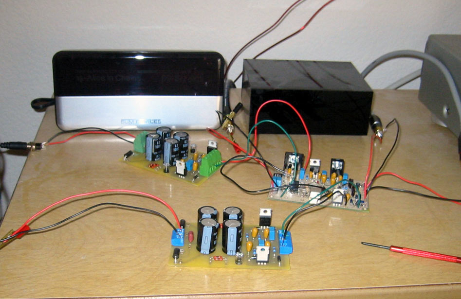

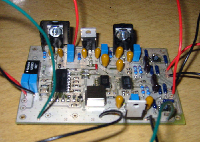

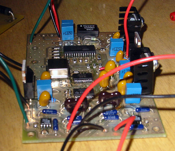

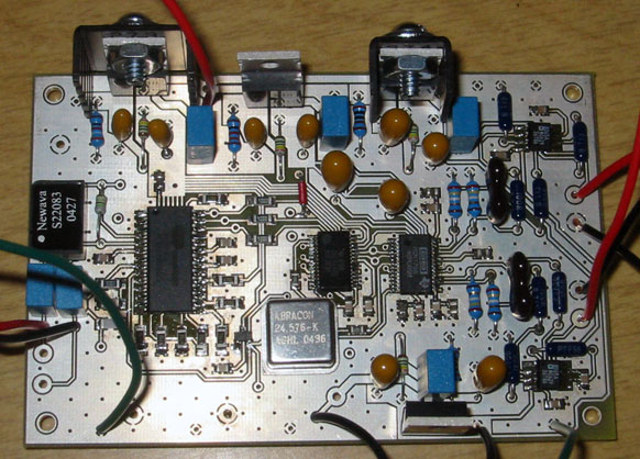

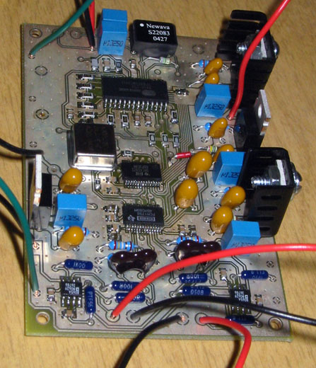

I gotta run, but just wanted to give an update. I finished building my DAC today, and it works. I have it hooked up to my SqueezeBox. I'll give more details later. But here's some pics.
Thanks! The sound is promising. The setup is not ideal, as the negative rail was not working, so I had to connect a second power supply. I think I must have burned the LM337. For my next build, which will be intended as a reference, I will use AD1896 and PCM1794, and also AD8610 for the op amps. But, so far, even this prototype sounds good to me. It's more "crisp" than my previous DAC, a TDA1543 NOS DAC made by Derek Shek, but I expected this to be the case. I liked the Shek DAC a lot. I need to listen to my DAC for several weeks to determine whether I will make a permanent change. If the perceived increase in detail becomes fatiguing, then I may switch back. Still, it was great fun to do this project.
I don't have those files. I'm doing this using ExpressPCB. I am going to make some minor modifications to the prototype, as well. Then I'd like to do another run. If you'd like to suggest some changes, I'm willing to listen. However, if you take a look at the BOM (and now the "Fancy BOM" that I made), building the current board is not exactly cheap. I don't want to add too much more to the cost or the complexity, or else, I fear losing the "EZ" in EZDAC. That said, the board has plenty of flexibility. For example, you can use external PSU for the op amps, and bypass the I/V section entirely to run your own, if that's desired.
