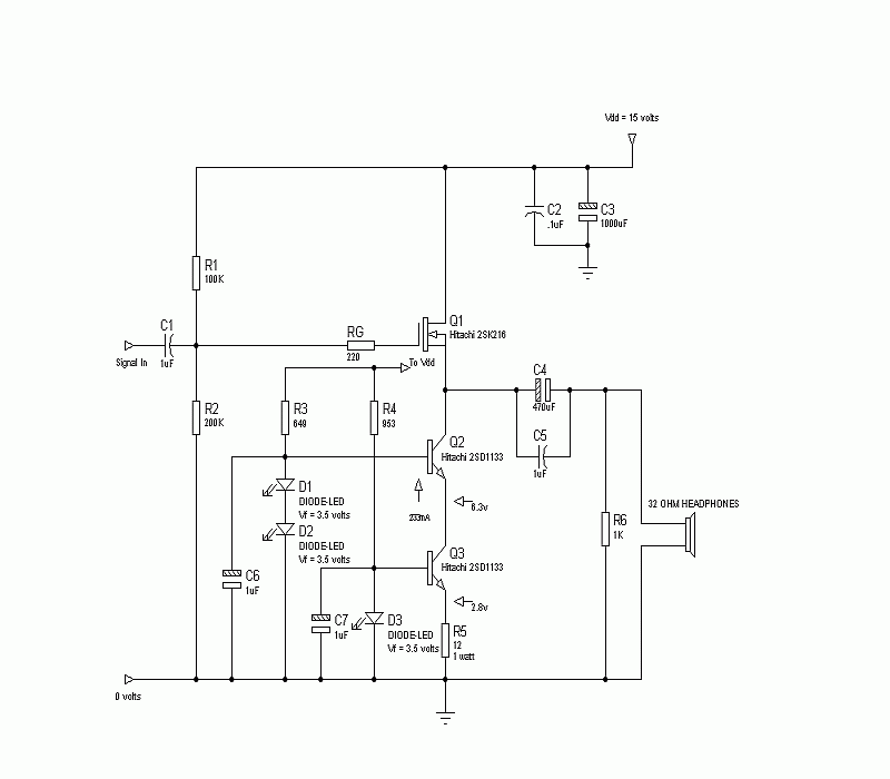

I'm going to build my first audio DIY project: a szekeres amp
First: I choose the szekeres because of it's simple design, and I've heard it sounds good. I'll use it for a Sennheiser HD565 on a computer (with sblive).
Is this a good choice? Or do better amps exist (better and not really more complicated) ?
Do you have some advices on the szekers model that sound the best? (DC coupled; CCS...)
My first choice is to build the latest one that is on headwise's site: (if nobody tells me it's a poor choice)

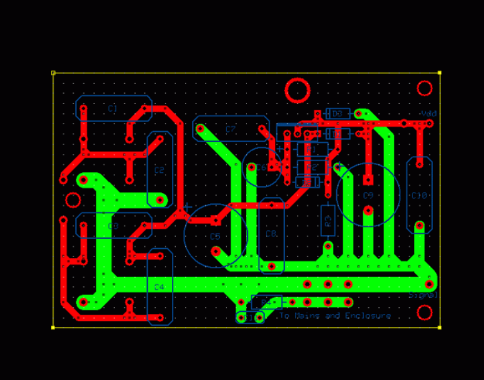

Now, I'm working on the PS. I've heard the szekeres are very sensible to ps quality, anr ripples. So I'm going to buils th PS myself, and not buy a regulated PS (a friend gave me a torroid transformer 2 days ago, so I haven't to buy the main part)
I'm thinking about using this model:
It's a ZenV4 PS. IMHO the design is good. But the values (especially for the condensers) are to be changed.
The problem is: how much will be good?
The transformer is a 230V (primary) 12V (secondary) 50VA. Will it be enough to drive a stereo szekeres?
What do you think about all this?
Can you give me some good values for the condensers?

Two caps in the middle are C2 1000uF Elna caps. Four blue caps are ps caps 4700uF caps. I am going to use regulated PS, 50va avel tranny 18volt x 2 and 2 LM317T (to220 package) voltage regulators. Regulators and misc components should arrive soon
P.S. I used a cheap 12 volt power supply for testing the board.

LM317 constant current source
Here is Tomo version
in an earlier post at Diyaudio forum.
Szekeres a la Tomo
This picture is also on Headwize.
Szekeres a la Tomo

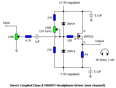

Hi Bricolo,
Have a read of this article:
http://sound.westhost.com/project36.htm
before you construct the Szkeres amp.
The distortion of such a basic circuit is likely to be very high - around 2%. Maybe you could consider Rod Elliott's revised project instead:
http://sound.westhost.com/project70.htm
Hope this helps,
Tim.

The Szekeres you've shown should draw (I think) around 350 mA per channel, 0.7A for two channels. At 15VDC, this would be 10.5 watts DC. A rule of thumb is to double DC watts to get AC VA, so you need 21 VA. Your 50VA should be more than enough.Bricolo said:The transformer is a 230V (primary) 12V (secondary) 50VA. Will it be enough to drive a stereo szekeres?
You need a reasonable sized heatsink, and mounting of the transistor is critical to ensure good thermal contact. Headwize should have plenty of examples of Szekeres amps.
You can experiment with adding regulators, but my preference is a capacitance multiplier. You don't really need regulation, you need smoothing. See www.sound.au.com for one such project. I suggest one multiplier or regulator per channel.

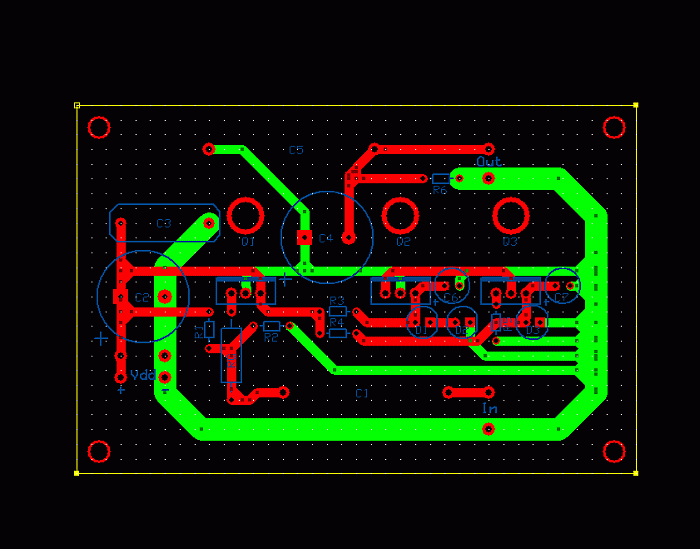

Here is an image of the regulated supply PCB. I don't have the diagram for this one yet. I took the Welborne Labs PS1 diagram and just used the positive half. It's basically a Jung regulator. They are made using ExpressPCB and each is layed out on a "miniboard". You can get three of each board for $120 USD. Less if there are others that want a set of boards and you do a group purchase. The way things look with my hobby funding I may never get to use the boards or the design so I figure that somebody should. Just email me if you want the files and I will send them to you. Oh,by the way The Szekeras is really meant to drive lo impedance loads. If you want to use Sennheiser HD580's a good Cmoy or Meta is all that you will need.
