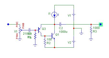

Well, the "BAM headphone buffer" would have split rails and, unlike the direct-coupled design G posted, it would use an output cap between FET and headphones and thus eliminate all of the input parts aside from the potentiometer. It would use a CCS to load the FET.
The sound would be better still if a pair of bipolars were used instead, say in CFB configuration. Bipolars are considerably more linear in this application.
Here's a bipolar design. I've just acquired this schematic capture software so I'm not too good with it yet.
Most part values are the same as in your original circuit. Voltages are +/- 10V to 15V as before. The Current source is 500mA. Driver transistor pnp ZTX753 or similar, output npn MJE243 or similar. base to gnd resistor at pnp is 22k. You need psu caps from both rails to ground too (not shown).
That's it. It'll sound sweet as a nut.
BAM

"Unlike BJTs, MOSFETs does not draw current so biasing is ultra easy"
Seems to me they both need a single resistor for bias, and the FET needs a VHF damping resistor to keep it stable. In either case you get a dc offset - usually several times higher with the FET because of Vgs. FET is good when you need very high input resistance and you don't care about the higher input capacitance, lower output resistance and non-linearity.
"Also, notice the matching is rather unnecessary. This is very unlike BJT counterpart."
I couldn't disagree more. What do you mean exactly?
In any case, this design does not require matching as it is single-ended.
For this configuration I recommend the lastest technology - BJT. Did you know that FETs were invented first? :eek: ;)
