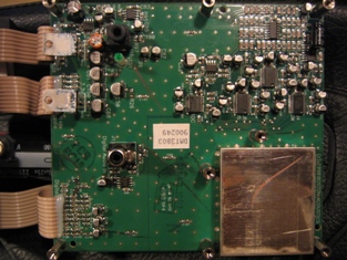

As mentioned in my last post you can check this by checking the diodes with a multimeter. If you can't identify them then post a photo of the PCB from the top and bottom and I will see if I can.
Andrew

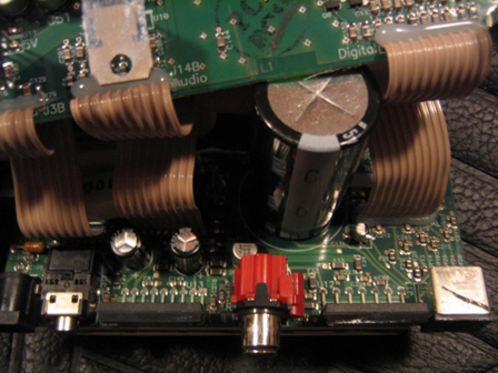

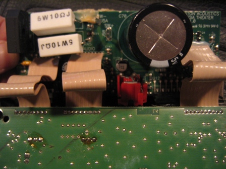

You must have been reading my mind, because there are so many components on here that I am not sure which are the diodes. I am uploading the pics here.

In the first picture you posted, your thumb is just shown in the top left of the shot. You thumb is actually touching the bridge rectifier. it is the black rectangle with one corner cut off and four legs on the bottom.
You need to take this out and then check the diodes with a multi meter.
