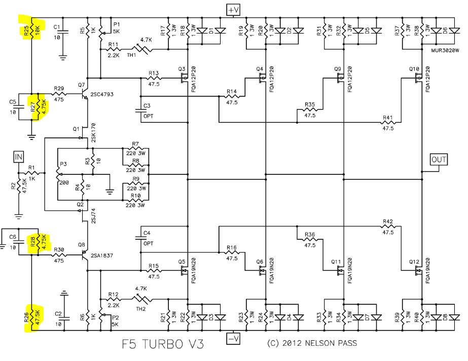

I am doing some calculation about che cascode.
Nelson suggest to be 1/3 of the rail voltage. In my case, will be around 15v (45v / 3)...
I think that the divider of interest is R25/R27 and R30/R26. I'm right ? If so, i don't see why they are different values...
If i fill the calculations :
TOP
Vcascode = [Vrail / (R25+R27)] * R27 -> Vcascode = 45v / (10k + 4.75k) * 4.75k = 12.8volt
BOTTOM
45v / (47k5 + 4k75) * 4k75 = 4.1volt.
They don't have to be equal for the top and the bottom half ?
... As usual, what i am missing ? (apart from a solid electronics background :rolleyes:)

about the cascode... i need to check for both dividers ?
or only the bottom one rules the voltage ?
Both cascodes operate for each of their supply rail and jFET.
But since both are exposed to the same voltages and the same currents, you will find that one prediction works for both upper and lower.
2sk170/j74 seem to work very well with 4Vds to 10Vds and this is the voltage the cascode needs to provide.

That is an error on schematic.
They should both be 10k
i knew it ! :D
anyway... in my very particular case, with 45 volt rail, to get the sk170/sj74 in the best fitness condition i have to supply them 10volt (as per AndrewT reply)
if i am correct Vcascode = [Vrail / (R25+R27)] * R27.
Fixed R25 @ 10k -> R27 = 2k85. with a 45v rail i will get 10v on the input jfets.
