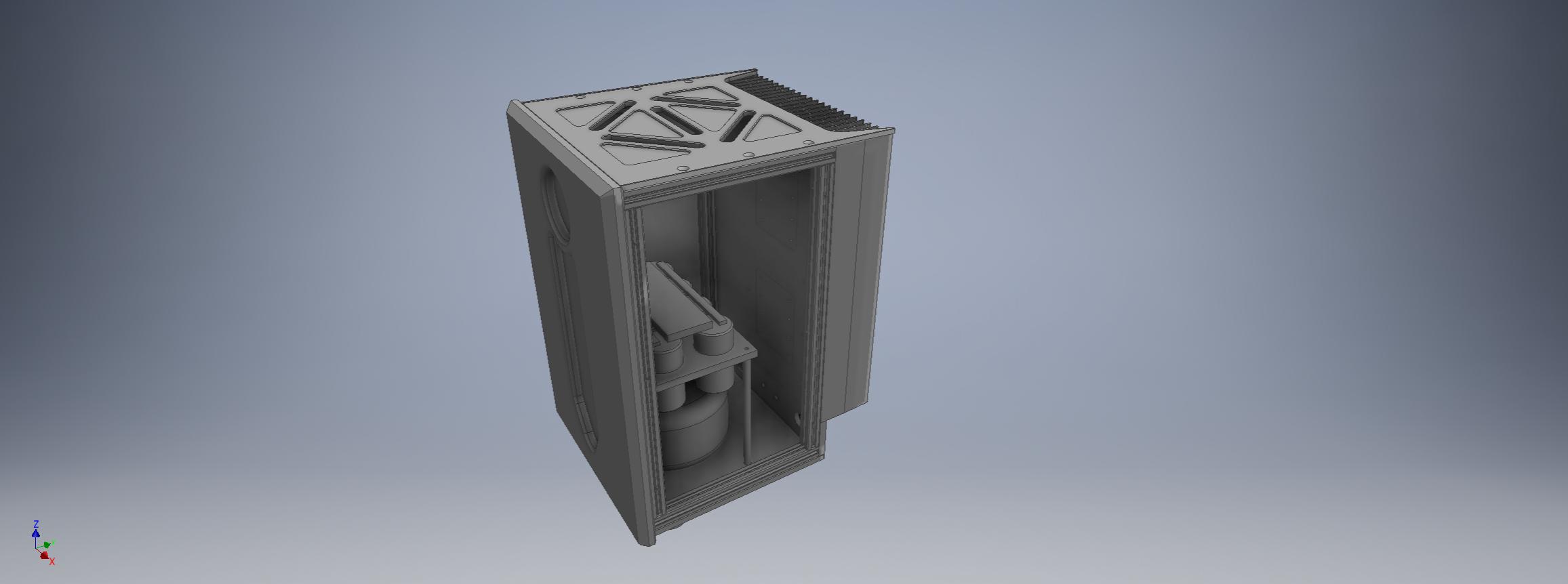

Today i have ordered to a local company 4x inductors, 1mH / 0.04Ω rated for 10A. They'll make on a toroidal iron core.
The main PCB was stuffed with all the components, and this weekend i will CNC-drill all the holes on the heatsinks so i can start attaching the boards and start some preliminary tests.
The finished case form-factor will be something like the images attached.
Wish me luck :D

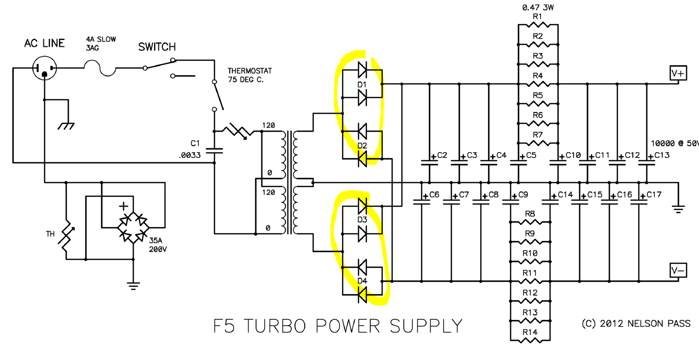

i start planning the power supply for the tests.
I have on hand a 1400VA toroid with 230v input and 2x38Vac secondaries.
I have made some pcbs to mount the same MUR3020 i use on the channel for rectification... and my idea is to make a 38-0-38 Center tap, with dual bridge and then 44mF+2mH+44mF each rail. this will end up in something like 55Vdc unloaded.
What do you think about this arrangement ?
There are advantages (from your honorable experiences) in using a 0-38 + 0-38 with dual bridge over a center tapped solution ?
