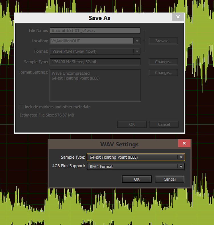

Indeed, Audition (based mainly on Cool Edit and improved further to work on 64 bit systems, as some another improvements), is a very good and complex audio processing software. But sometimes, I need to use Cool Edit for some options it were removed it from the new Audition...
At last I think that in connection with the suggested procedure to improve the quality of audio files (posted in http://www.diyaudio.com/forums/digi...iscussions-upgrading-mods-92.html#post3830309), it is not only about the up sampling of the files, but processing these files in 64 bit it may be another factor of improving.

"I've tried what you suggested, with Audition and RF64 high bit-rate, high sampling rate conversion. To me at least, the upsampled file produced loss of focus and mushy bass. There was some spatial expansion, but the loss of focus and sense of "uncertainty" were quite unpleasant to me. However, I can see how this Audition' processing and upconversion can sound interesting... Conversion to flac did not make much difference, but I preferred the Flac fronted encoder for Win 7 64 bit compared to Foobar...
I used ProTools before and just installed Adobe Audition to give it a go. I must say that I was impressed by Audition (!!) Very fast, intuitive, with great options, in particular cacheing and switch between two or more file versions. Excellent software.

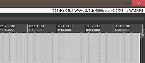

64 bit files?This facility to be converted to FLAC the 64 bit files (wav) is a progress.

64 bit files?
Well, since we were talking about processing 16-bit data, it seems like a bad idea to store it in a 64-bit format.
Especially floating point. Great if you want to process it, less than great if you want to play it.

Converting 16-bit data to 64-bit floating point is like converting your stereo music into 5.1 surround - to play it from 2 speakers.
... Or like when using a Sabre DAC with stereo channels digital IN, and 8 stereo channels OUT... When you put together these 8 channels out to get stereo, you get for sure a better sound... Better than when one use only two of the eight ESS9018 channels...
I think your analogy of 16 bit - 64 bit processing with converting stereo to multichannel to playing out on only two, is enough forced. Stereo to multichannel conversion mean something else and it have nothing to do with using more bits in processing to increase the resolution/approximation of the represented analogue signal...
At least stereo to multichannel conversion mean introducing/adding of artificial digital parameters (created based on algorithms) to the original stereo signal to realize an unnatural spacial/surround perception from only two channels
But you aren't doing any actual processing that would require additional precision, so all you are doing is adding extra empty data, giving the CPU extra work to do shifting it in and out, and adding two non-bit-perfect conversions (from fixed point to float and back to fixed point again for the DAC).
OK. If is so usefulness to have 64 bit for audio digital represented words, why do you think Adobe and others prefer to chose such 64bit processing instead of 32bit to process audio data in their softwares? Why studios works with such 64 bit data words, and so on?
It is because they need to have some empty bits and big size files?
