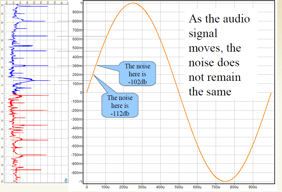

By the way, I have seen your plots (presentation) in another thread. It looks to me that these it were realized based on simulations. It could be nicer to have some real scope plots of real measurements of the stated behaviours...

The plotting paper might be mine, but seems pretty much anyone who has actually studied digital signal processing agrees with the view that you can't recreate the extra bits that weren't there in the first case - the dynamic range and SNR is limited by the source resolution (16 bits). Not much you can do to change that afterwards. Yes, you can dither, distort and colour the signal to sound more pleasant, but it won't give a greater dynamic range or SNR.

Feel free to do the simple simulations using an audio gererator and a scope. Which of the plots don't you think corresponds to a real situation?By the way, I have seen your plots (presentation) in another thread. It looks to me that these it were realized based on simulations. It could be nicer to have some real scope plots of real measurements of the stated behaviours...
I will not say that your plots and the logic behind your presentation are not right. And I do not pretend at all that upsampling techniques mean introducing of extra (quality) bits.
