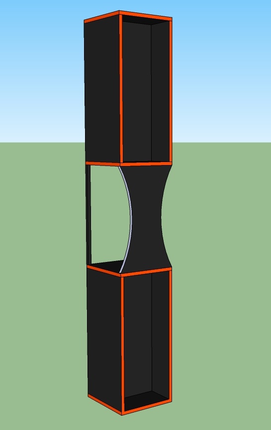

I'm open to any and all suggestions / warnings / kicks in the chuff. Here's a preliminary sketch I did yesterday, borrowed heavily from James Trexx's Gate, and the center baffle borrowed from 2Pi's Aristoteles.
Fire your cannons!

Here are my thoughts, from a recent endeavor involving active OB :
WMTMW layout is a potentially bad idea because of vibrations, especially from the top section, which will not be stiffly coupled to the floor because the middle is open. Move all woofers to the bottom.
Use a 4in-5in diameter true midrange driver, of as high a sensitivity as possible. For instance, in my prototype I used a pair of Seas MP12 drivers that I had around, and this worked pretty well. After extensive searching and modeling it seems the best driver out there for this purpose is the Seas 10F.
Do not use two midranges - this will definitely result in undesirable interference, because you can not cross over to the B&G until 3-4kHz IIRC.
Change to a 4-way system. You will need a driver to fill in below the small diameter midrange, which has to be crossed over somewhere around 600-700Hz, and the woofers, which can only operate up to about 100-150Hz because of the TL resonance of the H-frame.
Suggest U-frame loading for the woofers instead of H-frame. U frame has better sensitivity for given physical "size/length" and a better dispersion pattern.
You will need to EQ the woofers substantially. Sugges that you do NOT do this in the MiniDSP (except during the development phase when you are trying out different EQs) - keep in mind that the max peak output voltage of the MiniDSP is NOT very high (2V pk-pk?). The high amount of gain that is needed to extend the woofer response means that all other levels must be depressed in order to prevent internal digital levels greater than 0dB and very high and obvious distortion, etc. Instead, design and build an analog circuit for this purpose using an LT + a shelving filter.
Consider using a low noise, fixed gain stage with 10dB-20dB of gain on each MiniDSP output to better match its output to amplifier input sensitivity, or use amplifiers that have 0.707Vrms or less input voltage to reach max output power. You will appreciate the extra headroom!
-Charlie

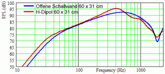

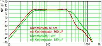

I simulated two Visaton W250 drivers in a H-frame (red) and in OB (blue) to give a rough comparison without any EQ applied:
The H frame is 9 cm deep on both sides. If you don't intend to use the dipole woofers below 60 Hz, a shallow H-frame will not have much advantage over a simple OB of same cross area. But a shallow H-frame will be usable up to at least 300 Hz too. Note that the frame resonance is only about 4 dB.
Doubling the depth of the H-frame would give another boost below 40 Hz, but reduce the upper range to about 200 Hz:
