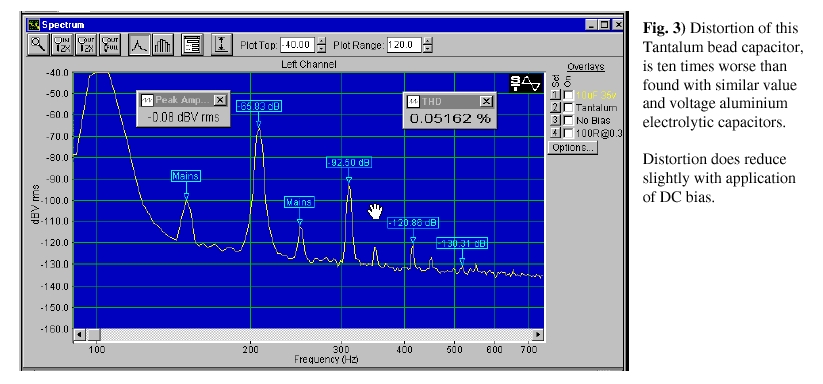

Several years back I remotely helped someone to tune-up his HP-100 with better capacitors. Once that tantalum at the output was replaced by some film cap, the person reported that the "Hovland sound" was gone and it sounded just like any other plain vanilla preamp. Needless to say, the amp was quickly sold.
I guess they used tantalum in that location as some sort of a "harmonic synthesizer" - just look at the distortion spectrum in tantalum measurement taken by C.Bateman (below).

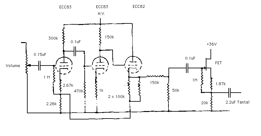

In the process I also reverse engineered most of the amp by looking at pictures the owner have sent me. Here's the sketch of a line stage, for those who are interested ;)

Is that really a line stage wth a gain of about 20, followed by a -12dB (x0.25) attenuator, then a source follower? Nobody would choose to design a line stage that way, as it increases distortion and reduces headroom.
My hunch is that the original design had less gain (more feedback) but they couldn't make it stable. Maybe 'dowsing' the prototype failed to modify the Bode stability plot, but that was the only technique the designer knew?
You certain? Or just slandering an excellent product :p
It looks like a seriously misunderstood interpretation of ARC SP - 3, but at least it's easy to improve by shorting all the tubes and leaving only the fet follower. Or maybe just the tantalum cap...
