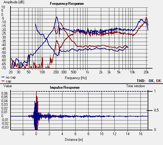

Here are the measurements.

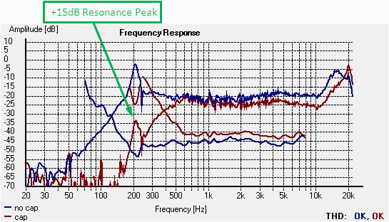

Bleu Line is esl without cap red is with an audin cap of 15uF
upper line is freq response bottom line is distortion (THD) look how nice the distortion goes up at the frequency the cap kicks in, also funny is that the distortion is a few DB louder overal, i only changed the cap nothing else
this measurement is taken up close so i could do it at low volume. the Hump at 200 is resonance freq of the panel.
also the impulse repsonse changed quit a bit. the blue one looks beter overal

maybe You could do an impedance measurement? This would also clear up as to which extend the serious HF-peak is due to the mic or the transformer-panel combo.
How does THD behave with a series resistor between amp and ESL?
Like Gerald I also assume rather amplifier drive probs. A Resistor of 1-5Ohms would dampen the electrical series LC-resonance and reduce loading on the amp.

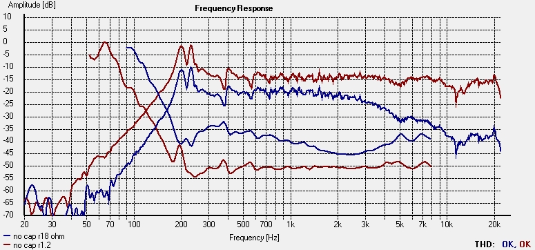

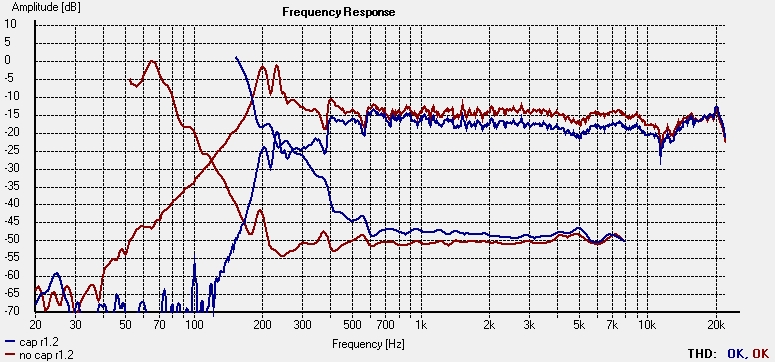

well here are the measurements up close with and without cap and a resistor of 1.2 ohm in series wth the transformer. picture one
if i increase this number for instance 18 ohm spl goes down overal and mostly above 10 k as expected. weird thing is even without cap and series resistor of 18 ohm distortion s heard in the lower regions. picture 2

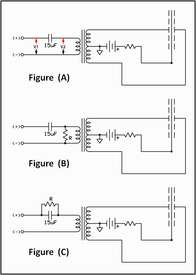

I schematic of your setup would help greatly.

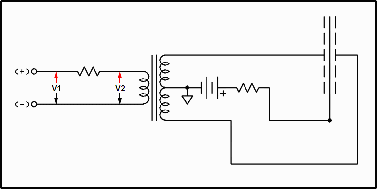

Distortion that increases as impedance in series with transformer primary increases, is usually core related. The series impedance can be resistive, inductive or capacitive. Looking at the attachment, if you examine the voltage before(V1) and after(V2) the series impedance you can determine if the distortion is core or amplifier related. I show a resistance, but you could use a capacitor as well(Impedance for 15uF at 100Hz = 100ohm). Whichever you use, select a component value for which you get noticeable distortion.
Since the distortion occurs at low volume level, you can use a line-input from another stereo setup to listen to (V1) and (V2).
Alternatively you could use the computer line-input to analyze with HOLM.
Just be sure to keep level < 2Vrms
If V2 is distorted, but V1 isn't, the distortion is most likely transformer(core) related.
If both V2 and V1 are distorted, the distortion is amplifier related.
Also, as geraldfryjr mentioned, a few specifics on your setup would be helpful.
In particular, what transformer you are using and a schematic of the circuit.
Also, it would be helpful to have a 100Hz sine wave recorded with and without the series resistor or capacitor to look at.
It might provide more insight into the distortion than the music sample did.

the setup explained by bolserst may need some more explanation for me
if i change the resistor for a cap of 15uF i should measure before and after the cap. and see what the distortion is ? so like the loop i use to calibrate the line out of the soundcard ? but then trough the amplifier trough the cap and back into line in ? and ofc first calibrate the output of max 2 volt RMS?
or listen to v1 and v2.

ok i tried only one panel with a cap to compare with one panel wil high resisting coating.
funny enough both had no distortion....... hmmm. i then though i desolder 4 of the panels in my setup to see if i lose the distortion then.. well no. still distorted.
i do think it might have to do with the capacitance of a few of these panels and a cap in series with the primairy. i really should get me a few panels with high resistance coating to check if this helps. getting sick of this crap. cant believe al 6 tranies i tried have core saturation when playing on low volume. as capacity said. it should be more noticable when playing louder.
i just noticed capacity said this in a really old thread of mine wich exact same problem. my mind forgot ewhat the solutions was back then or if i even had one in the end or just thought id live with it. the setup i used back then was same brand and type of tranies, with same kind of panels. i used six back then and 7 right now.
i do think it might have to do with the capacitance of a few of these panels and a cap in series with the primary... cant believe al 6 tranies i tried have core saturation when playing on low volume. as capacity said. it should be more noticeable when playing louder.
I agree it is not likely to be core/transformer related saturation as these type of problems almost always get worse as volume is increased. That was why I had suggested a test to prove whether the distortion is coming from the amplifier or transformer/ESL. I will try to clarify/simplify the explanation of the test.
Figure (A) is the setup you described that gives you distortion.
Measure or listen to the voltage at "V1" and "V2"...you can simply hook up headphones at these two points and listen.
If only V2 sounds distorted, the distortion is coming from the transformer or ESL.
If both "V1" & "V2" sound distorted, the distortion is coming from the amplifier.
If the amplifier is distorting it is most likely due to an impedance dip from series resonance between the 15uF capacitor and the transformer primary. I believe this is the case based on the +15dB peak in the response from your post #1. To get this size of peak, the impedance will have dropped to the DC resistance of the transformer primary(probably < 1ohm) and impedance phase will swing from +80deg to -80deg either side of the dip. This can upset the best of amplifiers.
To test this hypothesis, you can apply damping to the resonance with a resistor "R" as shown in Figure (B) or Figure (C). A resistance of 15ohm - 30ohm will work fine. With the panel producing distorted sound, connect the damping resistor and see if the distortion is reduced or eliminated. Figure (C) is the preferred setup as this placement of the damping resistor swamps variations in the transformer impedance and helps to stabilize the crossover operation.
