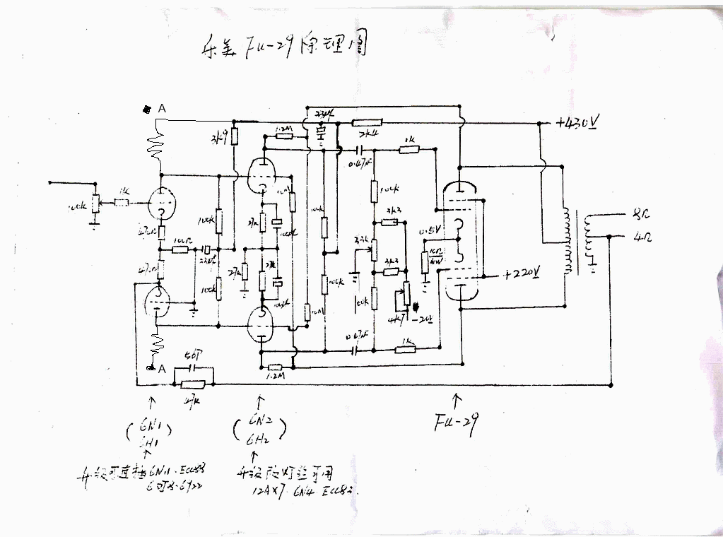

I will try to get the schematic for the Audioromy and post it. My idea with this thread is to share, learn and quality-control of modifications.

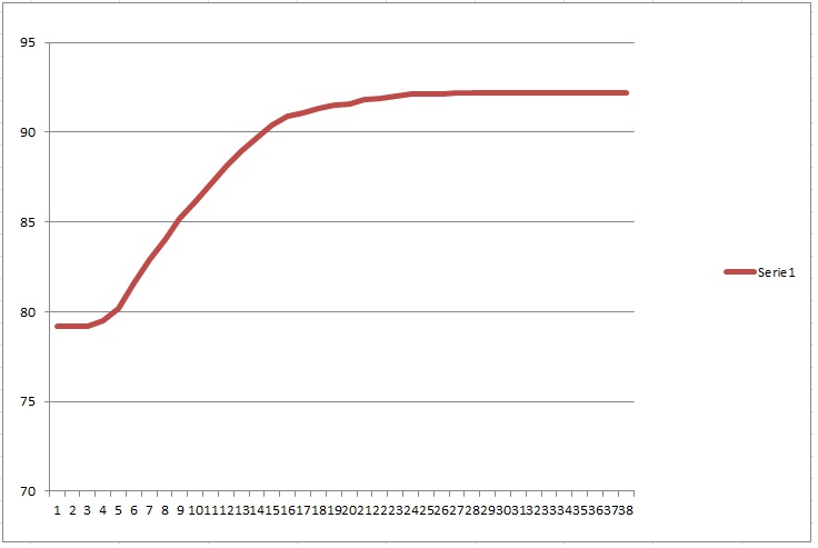

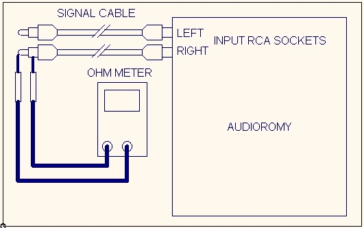

Measured input resistance acc. to this diagram fotis provided(thanks!)
Measuring results:
Unplugged signal cable, unplugged main power direct measure from rca contact. Did NOT unplug speakers.
Ohm-setting: 200k
steps from left:
1-12= 92,2kohm
13-15= 92,1
16=92,0
17=91,9
18=91,8
19=91,6
20=91,5
21=91,3
22=91,1
23=90,9
24=90,4
25=89,7
26=89,0
27=88,1
28=87,1
29=86,1
30=85,2
31=84,0
32=82,9
33=81,6
34=80,2
35=79,5
36-38=79,2
Stop
How accurate my results are is unknown, it is a cheap type digital multimeter.
I will have to learn about calculating gain structure.. :)

Interesting feedback scheme there. I've always wondered about the push-pull sharing of feedback from one side to the other.
I guess it works well in class A with a sinewave.

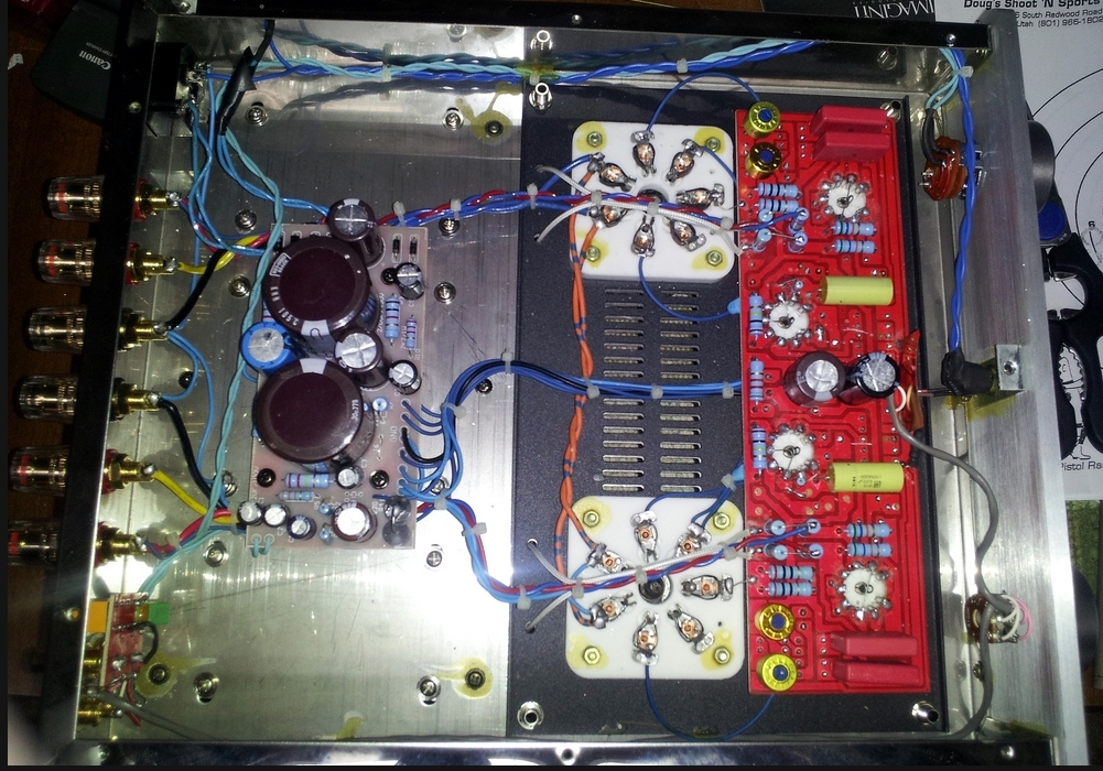

Thank you. I will have to open up my unit and start taking notes, order new parts and then replace one by one then. Seems like a wise place to start.
What recommended manufacturers are out there or better, what is quality items? :)
Those caps that I posted a picture of on page#1, do they fit any of the required spec? The schematic is a little hard to read. I got the 4psc. on the picture.
And, what tubes is recommended for the small tubes replacement?

Capacitors
Looking at the pcb, there are just 6 foil capacitors. The red radial at the corners of pcb are probably WIMA MKP. The two axial yellow at the middle are probably "ICEL" MKP made in Italy. IMHO both brands are not so cheap.
For electrolytics, i don't know. Simply that are either Nippon or Panasonic.
