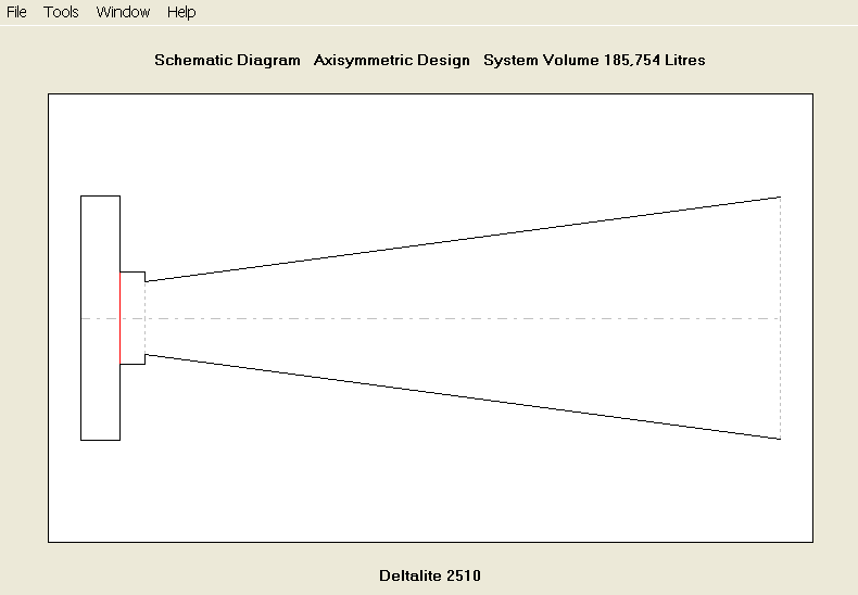

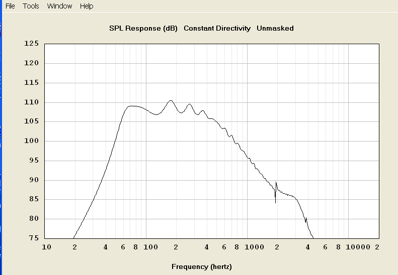

@ Rvrasvan

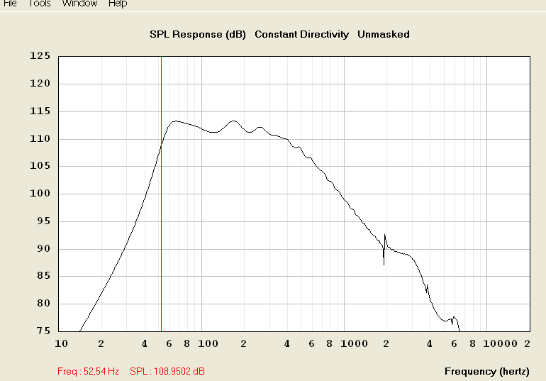

The eminence deltalite 2510 10" perform like a champion in the simulation.
0,5 PHI
attachment.php
1 phi still 55Hz!
257877d1325443759-klipsch-bass-horn-la-scala-schermafbeelding-2012-01-01-om-19.40.09.png
Make it simple straight.

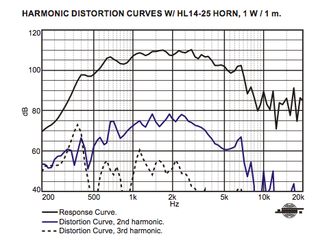

This is what i have in mind.
I hope i will be able to find a good driver that will do 400hz-10khz in an Iwata horn. I will fill the top with an APT-200(i am buying them tomorrow).
My biggest concern are the XO points->no XO in 500-10k region...al least
@Hentai. I won't use the KU-516 yet. But I will buy one soon because i want to hear it! :D
@helmuth.....You are not helping! I am trying to keep my mind away from those beautiful straight horn monsters :)).

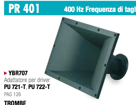

This one with the KU516 you need to make a adapter. It has a big diameter but it is not very long. They look beautiful. >400Hz
this one is also 400hz> 50cmX50cm
450Hz> is more some thing for a la scala enclosure. 75cm is very wide.

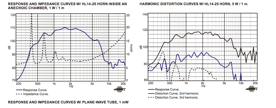

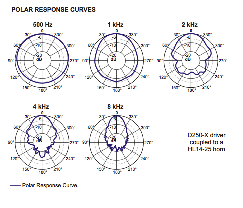

Right now I'm listening to a Scala with a Selenium D-250X... this little baby is fantastic... I use it with CT125 tweets and CW1526C woofers and special XOvers...
D-250Xs sound very very close to Klipsch K-55s which are one of the best... K-55s are about 265$/pair... I'm satisfied with D-250X because of their nice price tag and also cheap replacement diagram
I would like to have something that goes higher but at this price i won't complain.....

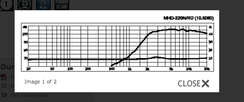

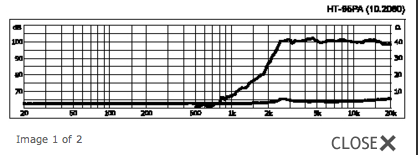

To Buy: 2xAPT-50 with apt 200 horn
2xSelenium 250x
