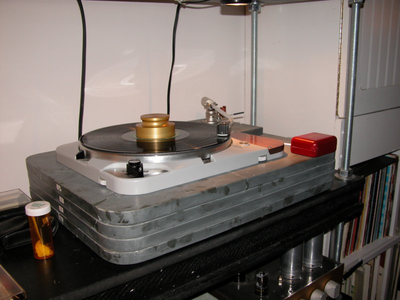

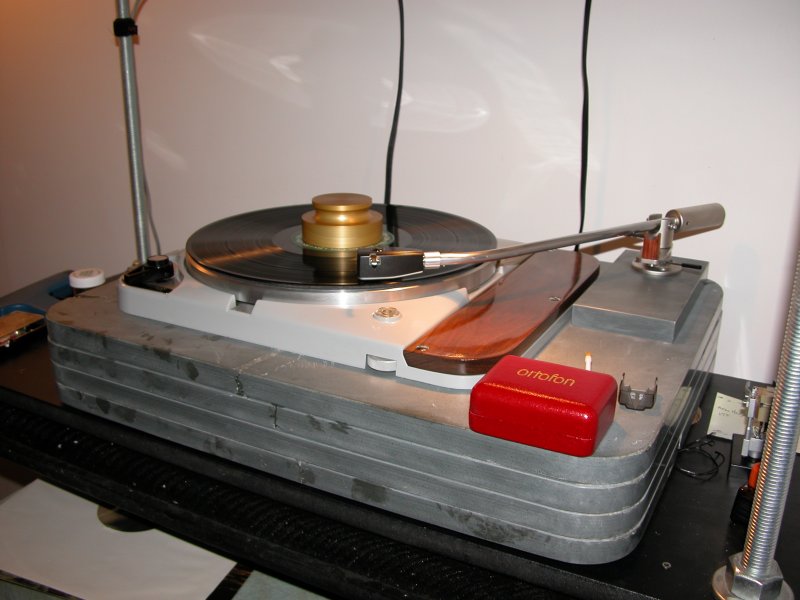

Finally bit the bullet and acquired a new SPU GM E MKII for my TD-124/II/Schick/cracked_slate_plinth.. :D Quite thrilled with it overall, do need transformers with more gain and a lower primary impedance although those 977 are doing a lot better than I expected..
It seems like they actually knew what they were doing back in the old days.. This is certainly by far the best sounding analog set up I have ever owned, and I think would stand up well against some very pricey modern competition - not that the comparison will ever get done.. :D
I have a ZU and a DL-103D, neither of these cartridges come close to the SPU in detail, dynamics, imaging, speed, bass quality and quantity, etc... I also have an all original loaner SPU G/T E on hand which in its own right is pretty amazing - all the more so given its age, apparently these cartridges if treated with a little respect are very long lived..

I'm obviously biased, but I'm really enjoying it.:D Vinyl now reigns supreme in my listening room.. :p
The ZU is very good for the money spent, but really IMLE requires high mass head shells and a heavy and usually expensive arm more or less just like the one required for the SPU in order to perform its best. The SPU however performs at another level still, and is much less restrained dynamically speaking, and at least the elliptical versions track difficult program material much more confidently.. Sometimes you don't even realize how hard the 103 is working at some points until you do the comparison and then you very quickly realize that the congestion and sibilants you were vaguely aware of were the cartridge itself - not the recording. There is more resolution across the board (the ZU is very good in this respect), but the SPU interestingly enough comes across as more neutral and evenhanded - an interesting realization. Another observation is that the tonal balance of the SPU just sounds more right to me, and to the half dozen or so people I demonstrated this to recently.
I was eventually going to retip the ZU, but realized thinking about it that the cost of the retip + what I originally paid for that cartridge was well into SPU territory so I applied the retip money to the purchase of an SPU instead, and am selling the ZU in order to recoup a little of the money I have invested in this stuff. :D

simply beautiful, timeless!
congratulations on finishing this wonderful project, i envy you.
