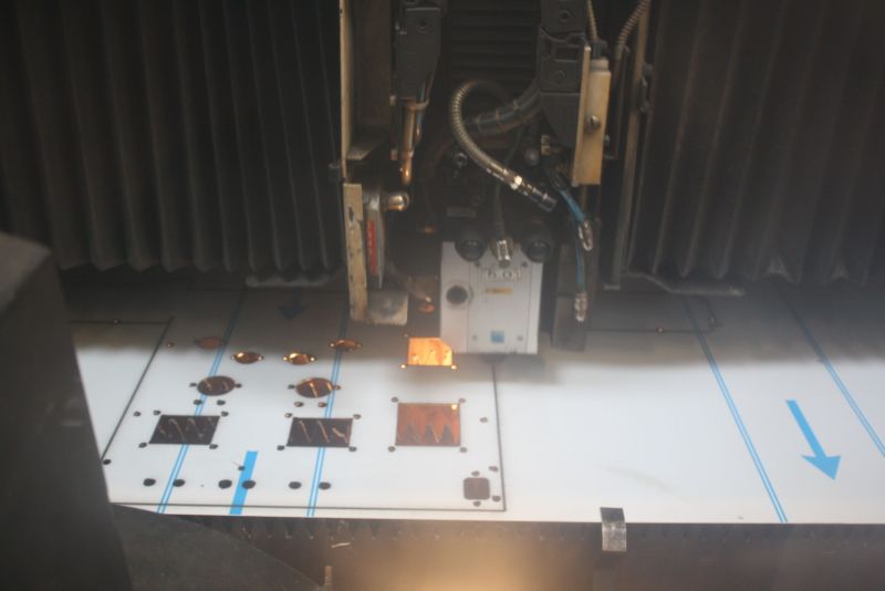

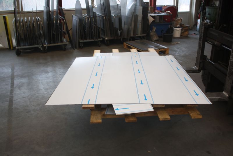

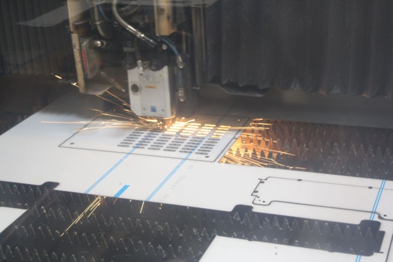

Here's a few pictures from the building of the amplifier.
Starting out with a raw sheet of stainless steel to be cut by a laser.
Probably not many have seen how it actually looks when the laser cuts.
Well, here's a chance to enlighten yourself
I needed to cut 3 different materials: steel, aluminum and plastic
All can be cut with a laser if the operator knows what he's doing and in my case I know the best!
Plastic bits, aluminum and stainless steel-plates are cut with a sheet-laser.
I also needed some way of mounting the electrolytic caps and I did't want to see them sticking up through the amplifier top-plate.
A capacitor holder/frame that takes up to 6 either Ø22mm or Ø25mm caps was drawn and cut. This time with a tube-laser and in regular rectangular steel-tubing. For not to squeeze the caps between all steel-frames the center-piece is made from plastic allowing for some elasticity when assembling the frame.
An aluminum 'heat-sink' plate was made where to place various components that needs heatsinking. Actually the 10 Ohm Cathode-resistors aren't all that hot, but it looks tidy when they are mounted on the plate. Also the LM317T regulator hasn't yet been put to use. It's for regulating DC for the 6AN8A fil's, but I don't yet know if that feature will be implemented. The main rectifiers are also put here but again, it's a bit overdone. I'm not drawing any serious current from these diodes (2ea. 15STH06FP). The plate also serves to mount a small piece of Veroboard with the negative supply transformer and regulation (TL783)
Feel free to ask whatever questions you have....
