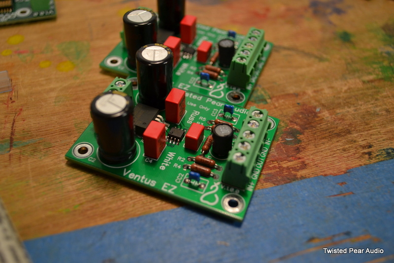

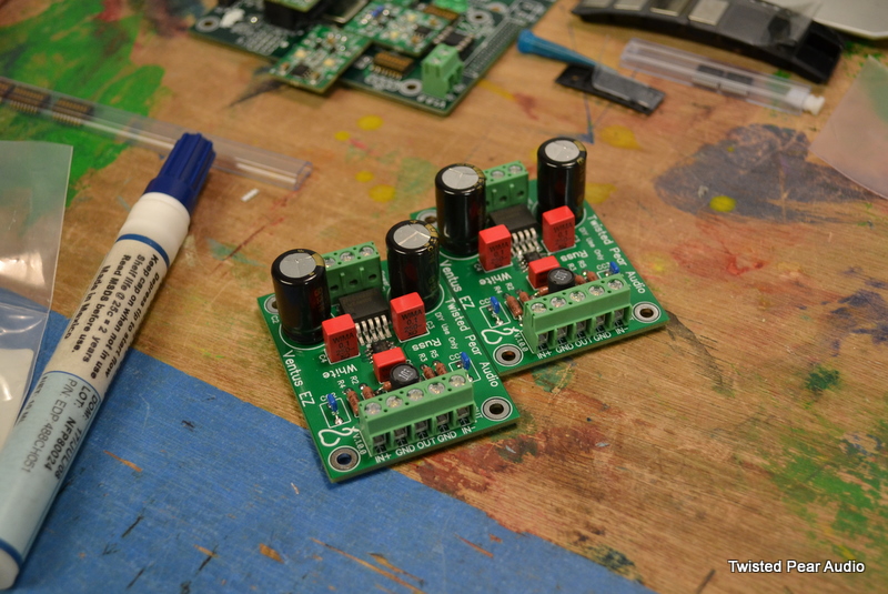

Nice pics Brian!
Cheers!

Nice pics Brian!
Cheers!
