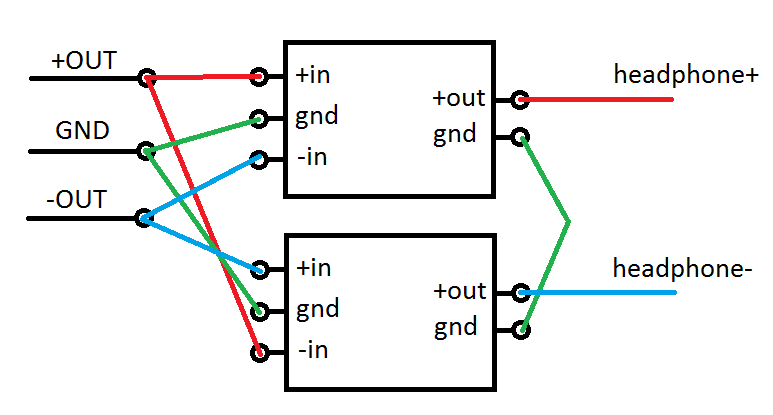

Currently, I do not have a balanced DAC. But I plan on obtaining one soon. For now, I will be using a Gamma2 The γ2 Compact High Performance DAC thats the link for it
It will output into 4pin XLR, or dual 3 pin, haven't decided yet.
But, I have 4 Ventus EZ boards, and am willing to use em all, because I would like (if possible) to be able to use both balanced and SE setups with the Ventus.
That will work, if your headphones can support being driven with a balanced signal. Not sure how much benefit you will get, however.
Yup they can :) so all the boards get wired up for SE use, with GND shorted to IN-, right? Because the signal is already inverted, so if you invert it again, it would be 2x normal, right?
So ide have 4x Non-Inverting boards, powered by 1 LCBPS? Or would I need 2?
No, use balanced inputs to each board, not single-ended, but reverse the inputs on the second pair (see picture). Repeat for each channel (left and right).
