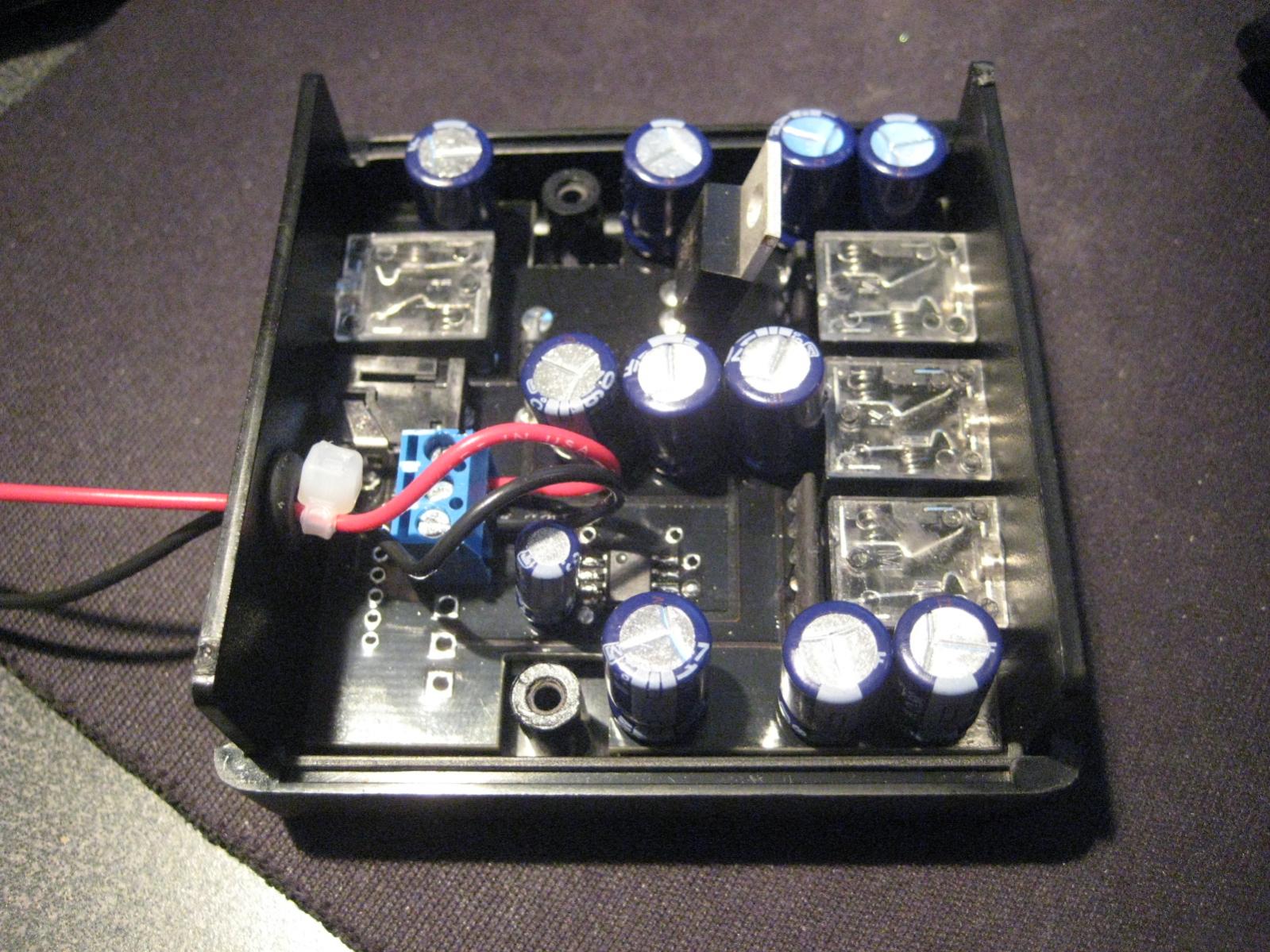

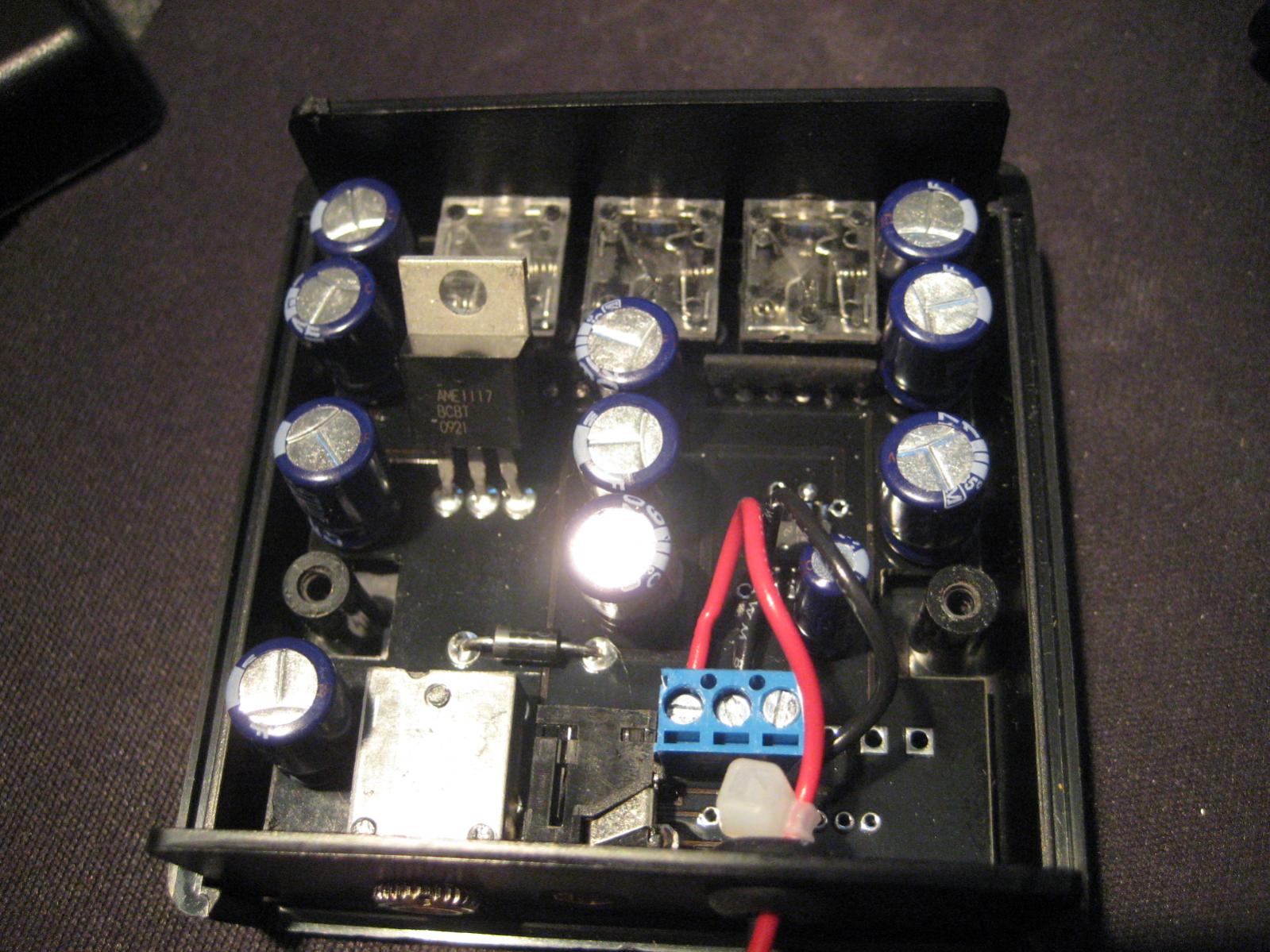

A little update and more questions.
Here is the amp/mixer I bought. Seems like a very simple design. What do the experts think? It has an MXAB LM48 chip, is that any good? There are no resistors in the design, a AME1117BCBT regulator, one diode, and some capacitors.
Also, dumb question, but what are the black bar shaped devices by the inputs? They have 6 connections and connect to the capacitors that then connect to the inputs and to the MXAB LM48 chip. One of these black bars is connected to right channel of all three inputs and one to left. They obviously merge the three inputs but do they isolate the inputs properly?
I am a little concerned that the inputs are properly isolated/protected as I will be connecting this to an 800.00 GPS.
Impossible to say without a circuit or actually handling the device.
470uF caps as input coupling seems very excessive so thats why a circuit is needed to see exactly how its configured.
I can't come up with anything for the LM48 either... I would have expected a common dual opamp.
