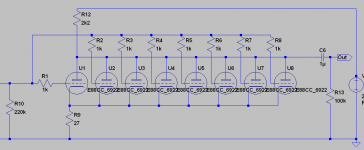

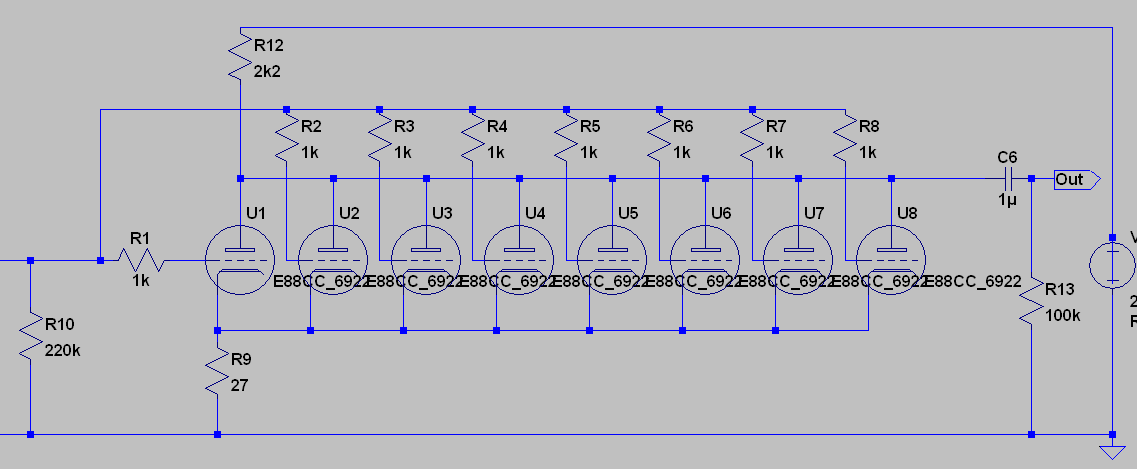

I like the simplicity, and elegance of the ART preamplifier. So I decided to build something like the ART. I did some simulation, and the result is quite good:
4pcs. of E88CC (8 triode parallel), with 6.2mA bias each. Distortion is 0.00075% with 100kohm load, and 1V output! Output impedance is about 800ohms. The distortion with 800ohm load, and 1V output it 0.1%. With 100kohm load, and 10V output is 0.05%
I know that is only simulation, but it looks promising!

I found anoother solution: Use 6H30, with higher current. Something like CT-5. I did some simulation, and it looks promising. The output impedance is less than 800ohm, if the bias is 25mA, and I connect parallel the 2 half of the 6H30. If I push up the bias to 40mA/triode (80mA together), the output impedance goes down to 500ohms, and the distortion is 0.02% at 1V output level, and 100kohm load.

yeah - really the reference
in any case - with so many triode systems in parallel , cascoding is first what's on my mind ....
If You ever hear the ART, the cascoding will leave Your mind...

I read about ART years ago , read more to complete enough information about working points used , make my own version and had it for year or so
later I got original schematic ( even with one or two original mistakes ) , conclusion is that I was somewher in 10% of working points with my own version .
so - years later , and few preamps in between , I say - I'll cascode it

btw. your schm is , also , not original ART one - just principle
I'm not saying that is worse or better .....

I know that my schematic is not same. I never did exact copy of any amplifier. I just like the simplicity, and I want to make my version.
So I really like the E88CC version, but I can build the dual 6H30 shorter signal path. The only question is the bias I should use. I don't want to try lot version because the high quality resistors costs lot of money.
