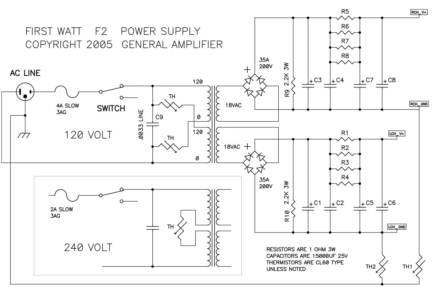

i want to build an F2 (or should that moniker be reserved for the originals made by the big man himself? i should say F2 clone). i have a question regarding the PSU. the original schematic in the service manual shows a toroid with dual 18v secondaries. can replace this with two 0-18 EI transformers? is it possible to use a single, centre tapped EI transformer? i am asking because toroidal transformers are very expensive in india, about 2.5x the cost of a good EI transformer. if i use two transformers i am thinking of going with 350VA each. do you think i need to increase this?
thanks

according to my tricky memory - F2 have 75W dissipation per channel , so even 250VA xformer per channel is approaching overkill ...... but more is always merrier , at least in xformer department ;
you can use CT xformer - connecting CT to gnd and using just two diodes (one from each sec. end to + ) to have full-wave rectification
or even better - use two xformers ( from 250VA and up) , each having just one 18Vac secondary
Papa's PSU is sort of dual mono PSU with common core and primary

thanks Zen mod,
if i go with two transformers (which is not more expensive for me than going with one, larger one) what type of rectification would i use? a bridge with the - connected to ground?
Also, with this xformer size, will i need a separate soft start circuit aside from what is already in the schematic (in the form of the thermistors)?

yes - full Graetz , with - to gnd
you can use one NTC for both xformers
...... just to confirm, the dissipation is 75w for 2 channels?
yes ...... 75W for two channels ........ and double it
I wrote already - 75W per channel

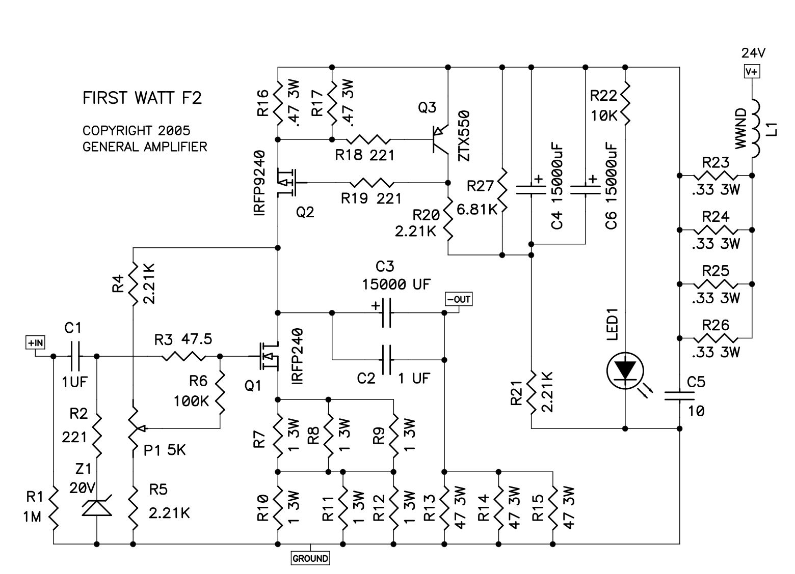

i went out to buy the parts yesterday and realized that the only 3W resistors available are inductive wirewounds. The alternative is 2W carbon types. Can i use a combination of these in the F2? can someone please guide me through which type i should use for which position...
thanks in advance
am attaching the schematic below
cheers,
mymindinside
thanks in advance
cheers,
mymindinside

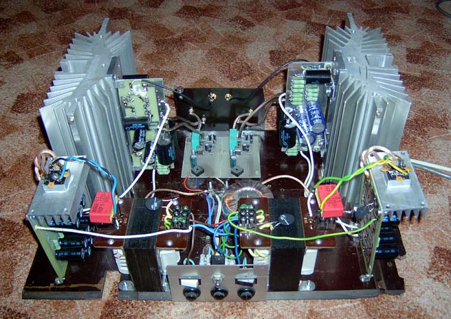

Hi, it's my F2 clone prototype Transformers 2x 100VA (18V-4A). In final version There are toroidal transformers in final version. More photos on my webpage.
Voigt Pipes
Voigt Pipes
Hi again,
in continuation to the resistors question; i had meant to post the amplifier schematic, but by mistake posted just the psu schematic. That is why DougL commented only about the PSU resistors.
i am attaching the amplifier schematic now, could you please have a look and see if i can use wirewounds throughout?
thanks
mymindinside
thanks
mymindinside
just those which Papa labelled as WWND can be plain wirewound , where Papa also accounted on their inductance .
all other resistors must be non-inductive , be it Metal Oxide or wirewound
non-inductive wirewounds aren't usual rectangular white ones , which you can buy everywhere
So i decided to parallel 2 2W carbon resistors because i just cant find 3W non inductive ones. can you please tell me if the values are close enough to the originals or if i am in trouble.
instead of 1R i am using 2 x 2.2R
instead of 47R i have 82R and 100R
and instead of 0.47R i have 2 x 1R
is this ok?

2R2 II 2R2 - good enough instead of 1R
for 47R - use 2 paralleled of 100R
two 1R paralleled instead of 0R47 - good
regarding bypass - I'm proponent of cheap and great solution - use motor-run cap , from 20uF upwards ; they're of great - industrial quality - and you can hardly beat them with any audiophool grade cap .
