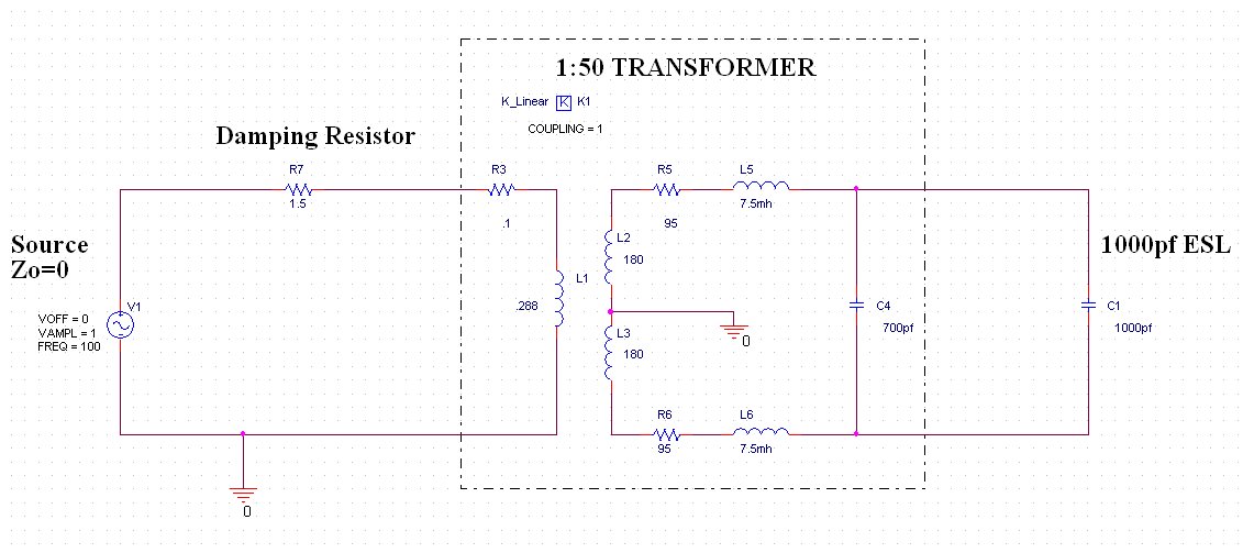

This is a SPICE model I created of a transformer and ESL load. The items in the box represent the transformer with leakage inductance, stray capacitance, and wire resistance. To the left is the source and damping resistor. To the right is a 1000pf ESL.

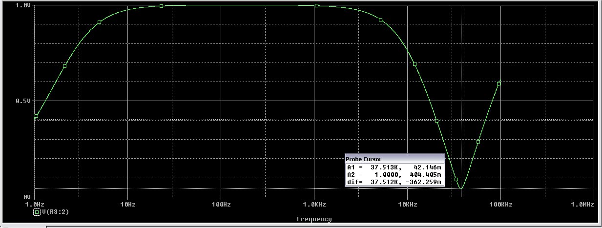

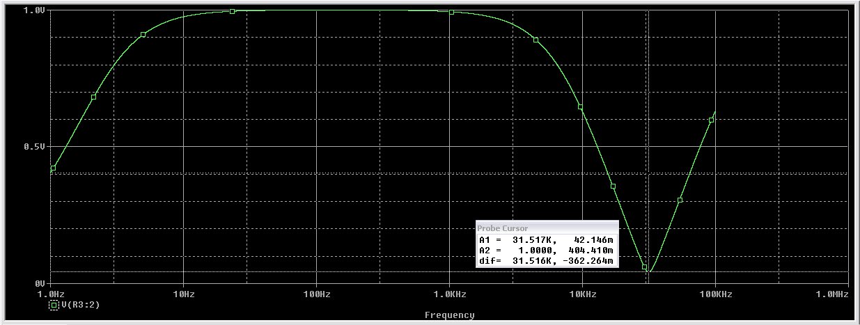

The next screenshot is the voltage across the load without the damping resistor. Note the high Q resonance at about 31.6khz.

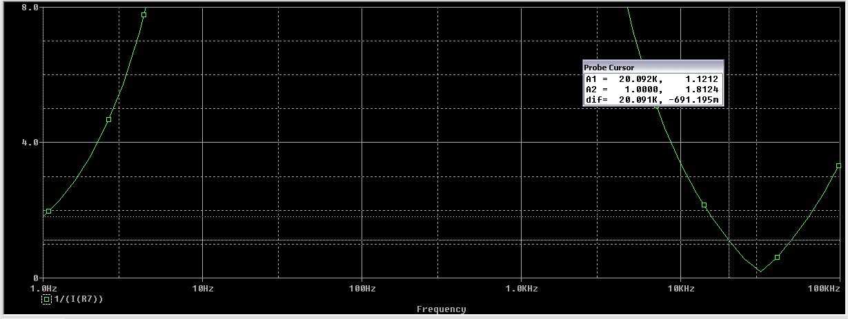

This screenshot shows the impedance without damping. It is about 1.12 ohms at 20khz and about .175 ohms at 31.6khz
We can calculate the unloaded Q at about 6.73
We will design for a Q of about .707. In order to accomplish this we will add a resistor in series with the primary to make the total Q .707.
Here are the calculations...

Therefore we need a resistor in the primary of about 1.5 ohms.

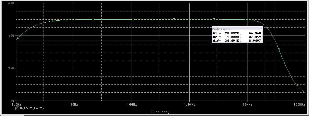

Here is the result of that addition:

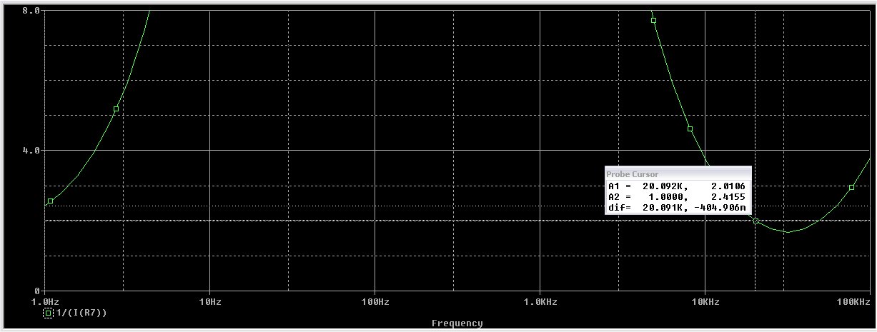

The impedance plot follows:
Note that at 20khz the impedance is about 2 ohms. The absolute minimum impedance is 1.67 ohms at about 31.6khz.
The frequency response shows about .655 db down at 20khz

I have some remarks on the values:
1. Primary inductance of 288mH appears too high. This would request a very big core and a lot of windings. I think about 100mH is the limit
2. Your leakage indutance L5 and L6 is too low. Its ratio is 0,000042 (L5/L2). Even you make a lot of intersection windings you will hardly target 0,0005, which corresponds to 90mH leakage.
Would be intersting to see, how those values will modify performance

I could be wrong, but the leakage inductance, winding capacitance, and primary & secondary winding resistances match the Plitron 50:1 toroidal step-up transformer.
Jelanier, if you are reflecting the ~720H secondary inductance to the primary side, L1=288mH, what do L2 & L3 represent in your model?

Inductance varies as to the square of turns. L2 and L3 share the same field.
L2 represents half the number of turns. Twice the number of turns would yield 4 times the inductance. The load is connected at 2X.
Since L2 is half the number of turns it represents a step up ratio of 25:1. So .288H x 25^2=180H
If you model this as a single ended design (a single winding of 720 with 15mh leakage) the result is the same.

Aaah. I misunderstood one of your previous posts. I thought you had said you were reflecting the secondary inductance to the primary. I jumped to the conclusion that you were double-dipping on your modeling of the secondary inductance; having it modeled on the primary and secondary sides of the transformer. In fact you were just calculating the value of the primary inductance based on the known secondary inductance and the square of the turns ratio.
You are probably aware that the specified 720H(and calculated 288mH primary inductance) are the maximum values when the core permeability has reached its peak just before the onset of saturation. At lower input voltages, the inductances values will be much lower. Even so, those are pretty high inductance values, which hints at a very high quality grain oriented core material.
I would recommend Terman's engineering handbook if you wish to gain more knowledge on winding transformers.
