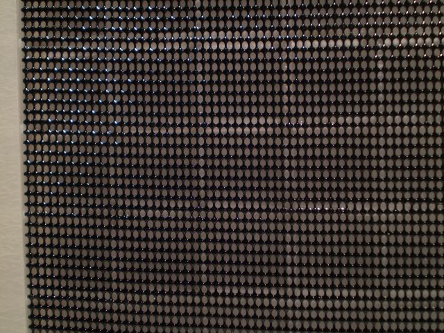

The flat surface you see is the spacer. Acoustat used rigid plastic for these and the whole "sandwich" was glued together -- I have seen a series of pictures online that covered the whole process, but I can't remember the site.
I have never tried to take a panel apart, but I guess these pictures prove it can be done.
You might want to consider using acrylic louvres rather than the much cheaper styrene louvres. The acrylic will cost a lot more but the quality of the material is much higher and will be longer lasting. You can practice on styrene louvres and then do your final build with acrylic. Note you will have to use different adhesives and solvents than you do with the styrene. If you are doing a simple proof of concept experiment or you don't have a lot to spend then simply use the styrene. It will give you acceptable results and last a long time. The advantage to the acrylic material is that it is much stronger is better self damped and is more stable and will not get brittle with age as the styrene does.
Acoustat panels were not intended to ever be disassembled. With the acrylic you can easily go with a 3/8 inch thick louvre rather than the 1/2 inch styrene Acoustat used. Styrene louvre is also available in 3/8 inch thickness which works well too. If you use a wire with a thinner but stronger dielectric then you can use more wires per inch than Acoustat did which will yield a more efficient panel. You can use threaded rod to make a winding jig. !/4 - 20 threaded rod will give you 20 wires per inch perfectly spaced. If you just want to go with 5 -6 wires per inch as Jim did then just drill holes in the end row of the louvre and thread the wire. Not my first choice but it works.
You could also try drilling small holed into the end row of the louvre through both parallel walls of the first cube then insert a 3/4 inch finishing nail into the drilled hole and use that as a solid hook to wrap the wire around (you will need one nail for each loop of wire so say six per inch). Once the wire has been bonded down simply pull the nails out and the adhesive will hold the wires in place.

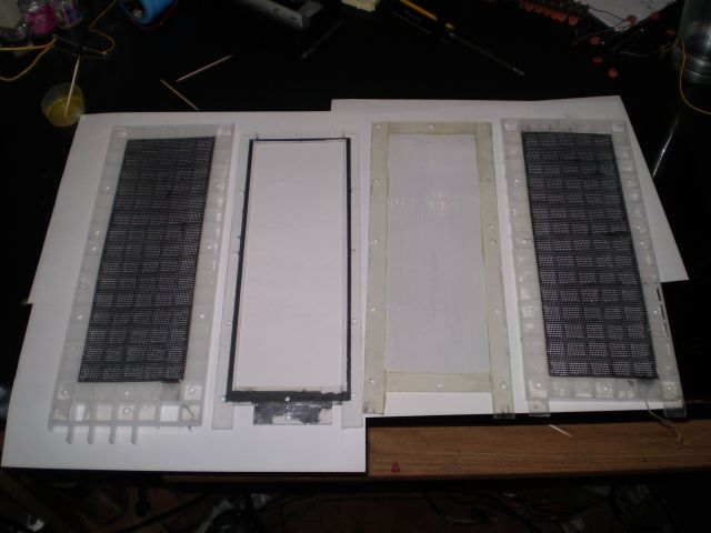

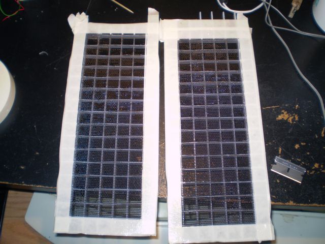

This is how I built mine seven years ago these pics are of the smaller version 3.25" x 9.75".
I also built larger ones that are 7.75" x 22.5".
I am now getting ready to build a 4 foot version.
I was not aware the this material is available in acrylic as i have been using the readily available styrene poduct,as it works good but I to am not happy with its mechcanical strength and rigidablity.
However,both sizes still sound great and haven't had and any major mechcanical problems after seven years,just use good adhesives is all.
Does any one have a source for the acrylic version of this material? jer

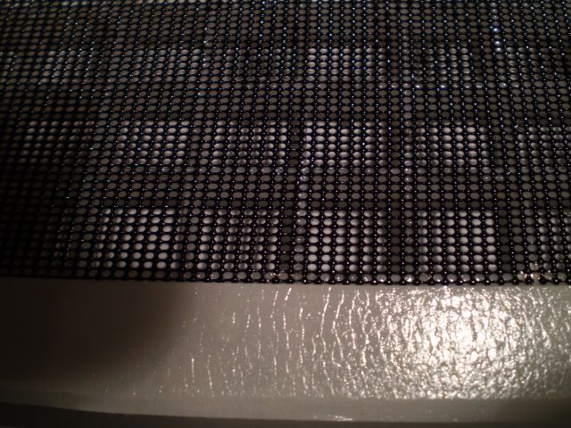

I just saw you last post so I will answer here. The contact point of the diaphragm resistive coating to the small foil strip is usually not an issue. I have never found one that failed. If you are getting a little leakage to the outer edges of the panel you can avoid shock by not touching them (ha) but this is not usually an issue and a thin layer of silicon seal is not a bad idea. You should check to see it there is any diaphragm sticking out first and simply remove it with a sharp exacto blade. the reason for this charge bleeding is contamination on the surface of the diaphragm (coating side only). You can address this by using a a Q-Tip and some paint thinner and wash the clear half inch wide stretch of diaphragm around the outside of the resistive coating. There is simply a build up of cooking grease and or cigarette residue that has built up and collected dust and become conductive enough to carry the charge to the outside edge of the film where your trembling fingers await initiation to the world of working on electrostats. The solvent wash might well be enough to solve the shocking condition of handling the panels out of the frame while still charged up. You will want to invest in a high voltage probe to use with your hand held multi metre, that's a lot better than using your fingers to see if things are loaded. Say can't they pack a wallop? Just as a side not I would probably be more inclined to clean things up with paint thinner and then spray paint half a dozen wet coats of clear high gloss (greatest solids content) urethane on the panel edges. Yes this is a lot more work than silicone but it will most likely do a much better job and you wont have bits of silly cone flaking off and getting into your panels over the years. Silicone will stick but it will float right off any spot which sweats out plasticizer. More work I know just what you wanted to hear but this is like the old Fram Air Filter guy says "You can pay me now or you can pay me later". With high voltage if you don't do things right you will pay for it sooner or later.
Regarding pin holes in the diaphragm don't worry about them at all as they have zero impact on speaker performance no matter how big they get. When the stator pops an arc which jumps to the resistive coating because it looks like ground it simply burns a tiny pin hole in the Mylar diaphragm. This hole self cauterizes and it is extremely rare to ever see one of these split open and run so don't worry about them they are not an issue.
Glad to see that you are in the sign business and are adept at using solvents and adhesives for plastics. That said the very worst abuses and violations of safety issues surrounding solvent use that I have ever seen (multiple times and places) is in plastic fabrication shops. Please be careful you know better than most that these solvents and adhesives can destroy your health. Hope this answers your questions.
