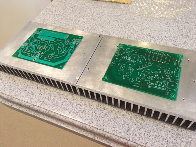

I just received my Babelfish J PCBs. They look really nice. Thanks ZenMod. And thank you to my benefactor who donated me the boards and transistor kit. 🙂
I have a couple questions (probably answered somewhere in this long thread).
Can I use IRFP240 instead of 150?
Are these heatsinks big enough?

yes, you can use 240 , keep them in 35W/device heat base
I can't really judge fins height from angled picture , but I would use 2 of these per channel ..... counting on final dissipation in 70W bracket
sorry , we can't go against physics ........ even if we can cheat sometimes with Babysitter
Or cheat with a small fan. 🙂
These are the 7.28in wide x 1in tall fins and 0.3in base thickness.
http://www.heatsinkusa.com/7-280-wide-extruded-aluminum-heatsink/
The manufacturer says 1.3 deg C/W/3inches.
I have 5in length so I think that says 55deg C for 70w. Then add 20C ambient for 75C so yes too hot.
2 per side , and Babysitter in Summer
edit: save them for ACA or something like that , buy 4 new ones , at least 7" long
in greater scheme , that's petty money
