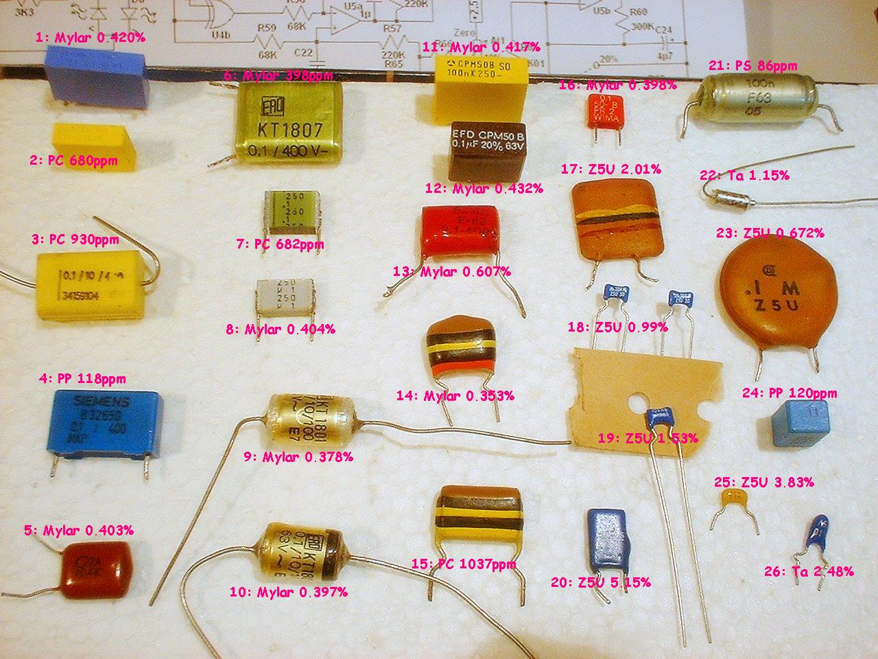

A selection of 100nF's:

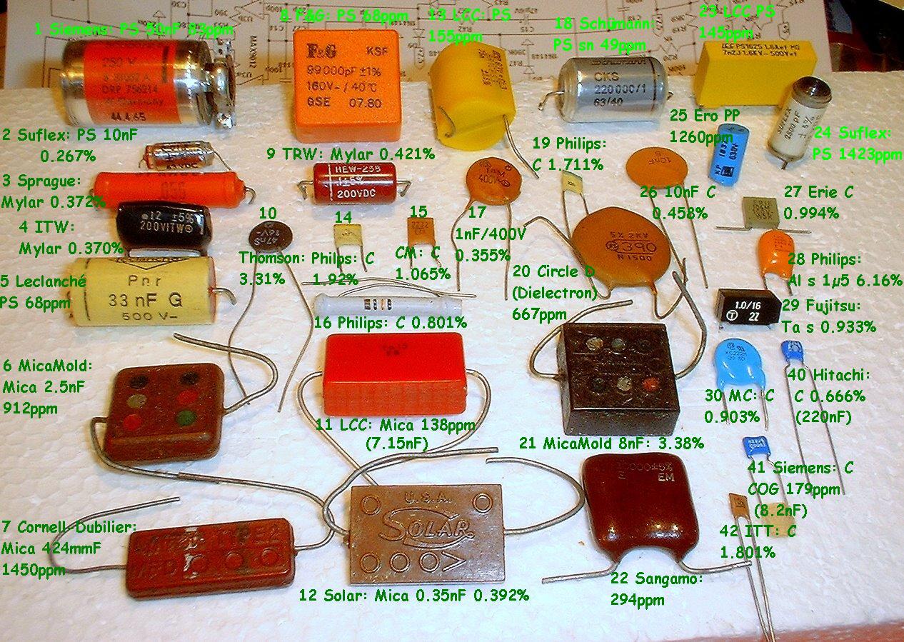

A mixed bag, with the best and the worst side by side:
