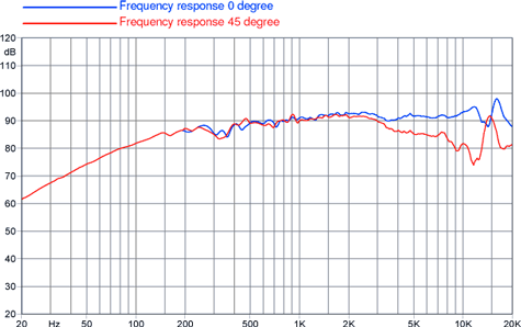

Here's the idea I had. Someone tell me this is a stupid idea, or else I'm going to place an order with Madisound this morning 🙂
In the Danley SM-60M and SM-60F, there is a 5" coaxial at the throat of the horn. The throat of the horn is connected to the compression driver in the throat of the 5" midrange, and the woofer cone is 'tapped' into the horn a bit further down the horn's axis.
What if you took one of these $48 Fostex woofers, and used it in lieu of the BMS Coax?

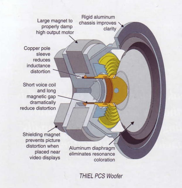

I got the idea from Thiel's "coaxial", which is basically a 3" aluminum midrange where the dustcap is decoupled from the woofer cone.

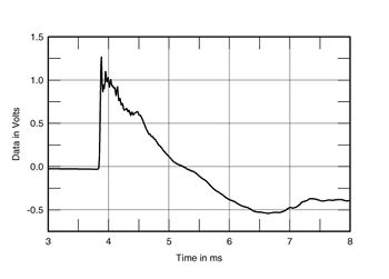

The step response, directivity, and waterfall plot are as good as I've seen from any two-way. The frequency response is 'hot' in the very top octave, but this is actually a bonus for horn loading, because it gives us some extra efficiency in an octave where the horn is too large to do it for us. (IE, with a 1" throat we're only getting gain to 13500hz due to the geometry of the throat.)

The idea is that the dustcap on the Thiel and the Fostex is behaving like a tweeter at high frequencies. The efficiency of this will be nowhere near the BMS, but once horn loaded, I wouldn't be surprised if the efficiency is in the mid 90s.
Best of all, it eliminates the expense and complexity of the compression driver and it's crossover. On my first Unity project, I spent over $500 and two weeks of time on that component of the design. So this would be a significant cost savings if it worked.

This is the predicted frequency response of the Faital 3FE20 on a couple of horns.
The grey graph is a response graph for a 60x60 horn with a 16" x 16" mouth, basically similar to the Lambda Unity
The black line is the QSC waveguide, with a 14" x 10" mouth, and a much wider directivity.
The Faital is vented. The efficiency is very low - just 90dB. I have to keep excursion as low as possible, so maximum SPL may be as low as 100dB. The maximum SPL depends a lot on the gap betwen the throat of the waveguide and the dust cap ("tweeter") of the Faital.
The 60x60 horn has much higher midrange efficiency, but the 90x40 horn has a predicted rolloff at 7700hz. So hopefully if the dustcap 'decouples' it will radiate right down the waveguide, as if it wasn't even there.
So basically you'd get horn gain down to around 500hz, directivity control from 1khz to 14khz, and then at 14khz the high frequencies basically don't "see" the waveguide and the dustcap is radiating as if it was on a flat baffle.
