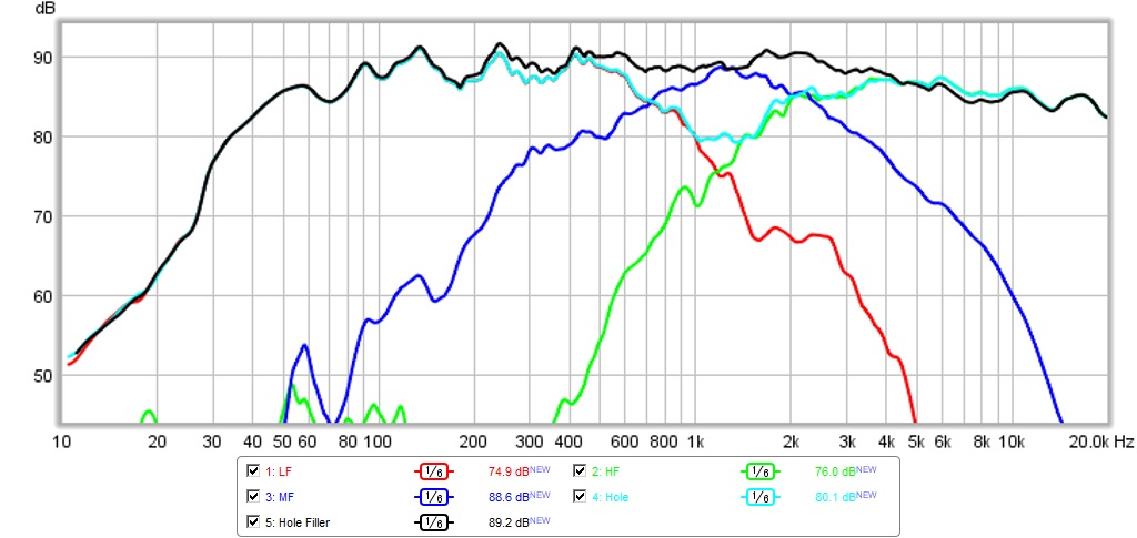

I had some time to fiddle with this test bed speaker today. Trying to get the LR2-BW1-LR2 transient perfect thing going. Settled on 1200Hz as central frequency. Making some progress and here is acoustical crossover measured so far. I am not use to a large speaker like this but the dynamic range and clarity is quite stunning. It's been a real pleasure to listen to - even though it's just a "test bed" for learning.
I think I will have to finally resort to overlaying the ideal response in REW calculated from the spreadsheet and then tweak each response to match via PEQ.
Here is measured acoustical xo. Note the magenta color shows the "hole" that gets filled by the mid.

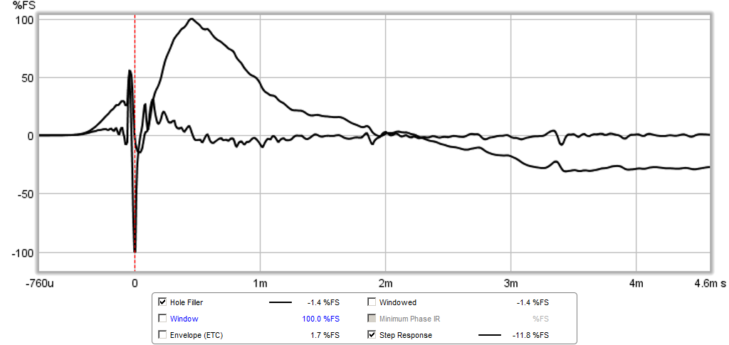

It's not what I want yet, but here is open disclosure so you can see progress. I just created FRD files in John K's spreadsheet for 1200Hz and 0.6 overlap factor. Will try to massage the drivers into this response - can be tough going but will be worth it when they all sum up nicely. As compromise will do measurements at 1m, (half dist for LP).
Here is current IR/SR that goes with previous xo plot (I have a LONG way to go):
Thanks SR plot as you say long way to go, but it's hard to track reallity when all traces are black, i'm green in this but do some guessing shouldn't IR/SR both go positive and then get woofer about 0,4-0,5mS forward in time domain by delay the others.

I downloaded XSim and set up BYRTT's sim, then loaded component values into LTSpice and generated wave output with swept sine wave input. From this IR.wav was generated; this is for intents and purposes here is a transient perfect response. BYRTT's comments about real drivers hold as limiting factor for results.
For your LR2-BW1-LR2 approach I simulated in Cool Edit; Woofer LR2 generated as cascaded 580Hz BW1 low pass, tweeter LR2 generated as cascaded 1720Hz BW1 high pass, and midrange generated as 1kHz BW1 low pass cascaded with 1kHz BW1 high pass. 9dB gain applied to midrange makes for good sum with woofer and tweeter filters. A somewhat more appealing result was obtained with midrange gain of 12dB summed with woofer and tweeter followed by application of PEQ 1kHz, -5.2dB with Q=.707.

I just spent 2 hrs manipulating the responses to match the target curves. It takes way too much PEQ to do so, and I fear this is putting all sorts of phase anomalies on the signal. The summed result seemed to be to high at the XO frequency. Bulged up. Don't know what is happening but it doesn't sound great. Anyhow, back to the drawing board. The last setup I had sounded much better. Will need to think and perhaps do some xsim or PCD modeling before doing it empirically again. Very time consuming.
This B&O hole filler XO is harder to implement than it looks. With miniDSP you would think it is easy. Can't imagine doing this with passives. One thing I see now is that if you need a lot of mid range sensitivity to do this. Maybe a PRV 5MR450NDY with 95dB sensitivity and 250Hz to 15kHz bandwidth would have been a better choice?

One example my thoughts for limiting factor is the system high pass and that alone will squeeze some the beatifull SQ-wave shown at that picture.
