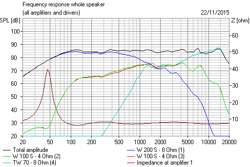

Note the flattened out peaks and troughs below 100 Hertz and a knowlegable person can figure it out. That compression can also be seen as a flattened, but not flat, electrical phase angle. This is always to be expected.
Now note what our respective measurements looks like for the alternative Usher S520:
[Actual measurement, not the modelling.]
Compare the above and it's fair to say that something more, ahem... sophisticated is going on. The difference is that this approach achieves something that commercial speakers with crossovers can not do: Can be driven by current and hence any amplifier of any output impedance. We will show examples later to prove what the affect is from driving from zero Ohm (which is voltage delivery) and near infinite output impedance (which is current delivery).

Frequency Response 15 degrees Off Axis:
Crossing Over:
The hump circa 1KHz was also indicated in the Atkinson measurements, it seems a reflection due to the mechanical layout of the driver.
The above are modeled.
Actual In-Room RTA Response:

Two extremes, Red for voltage drive and Green for current driving (270 Ohm source impedance as per 40 Watt Trans-Amp):
Now let's look at the current phase angle, same Red and Green:
Next the Frequency Response Family, 0, 15 and 30 degrees of axis:
Now comes the really interesting part, how does the crossover perform from a 270 Ohm source impedance (current drive):
Now let us overlay that with crossover driven from zero Ohm (voltage drive):
Note that the crossover performs almost as identically as can be.
Finally, we shall look at the minimum phase:
Please note this is with 4 Watt input and indeed the minimum phase goes well above 10KHz when one Watt.
What the above shows is a remarkable immunity to any source impedance, the largest deviation is at 25 Hertz, low enough for a small speaker system as this (in the Elsinores it even better controlled and below 20 Hertz).

What I'm getting from this write-up is that what's being touted is the unremarkable result that a constant impedance load (wrt frequency) will have a constant voltage across it irrespective of the source impedance. IOW, it follows Ohm and Kirchoff.
There's a marketing disadvantage, though- reduced sensitivity to amplifier output impedance and drive capability. Why is that a disadvantage since it's a technical advantage? Take the Wilson speakers, for example. The impedance curve swings mightily and dips down to brutally low levels. So the reviewer will note that the Wilson is far more revealing of amplifier differences than Joe's speaker!
Interesting. It looks like you fixed the very ugly looking response at the crossover point though, making direct comparisons between impedance-flattened and conventional designs hard to really discover.
Based on the Stereophile charts this isn't a speaker I would have bothered with at all, so that's impressive.
Could you post the raw driver responses, and CSD's of the post-modified system if you have them?
