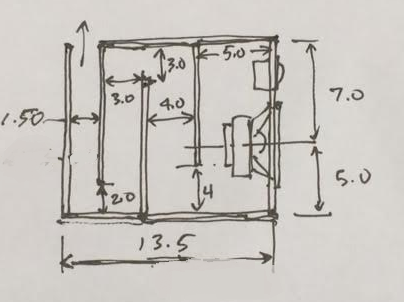

Anyhow, my design constraints were to use approximately the same 48in long TL that the PMC TB-1 has, and about the same physical format. I put the vent in an up-firing position at first, but eventually went with forward firing to gain a few dB of sensitivity in the bass. I also wanted a tuning frequency fb of about 60Hz - 80Hz depending on the damping scheme used.
The design of the TL was as follows with a 6.0in wide internal dimension:

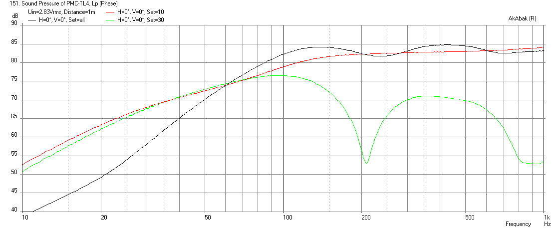

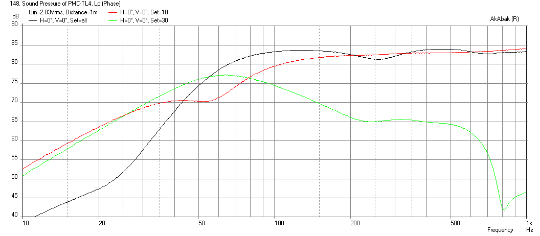

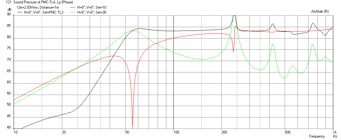

The predicted frequency response for this TL depended heavily on the amount of stuffing inside. Here are 3 cases of light, moderate, and dense stuffing. As expected, each case is a tradeoff in bass extension and SPL for light damping with lower group delay and improved transient response with dense stuffing. The predicted impedance curves go from double peak for light stuffing, to single peak for dense stuffing. The dense case tends to an aperiodic TL.
Light stuffing:
Moderate stuffing:
Dense stuffing:

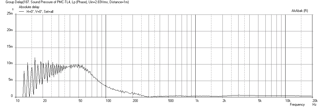

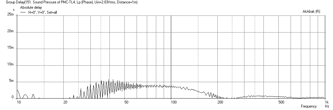

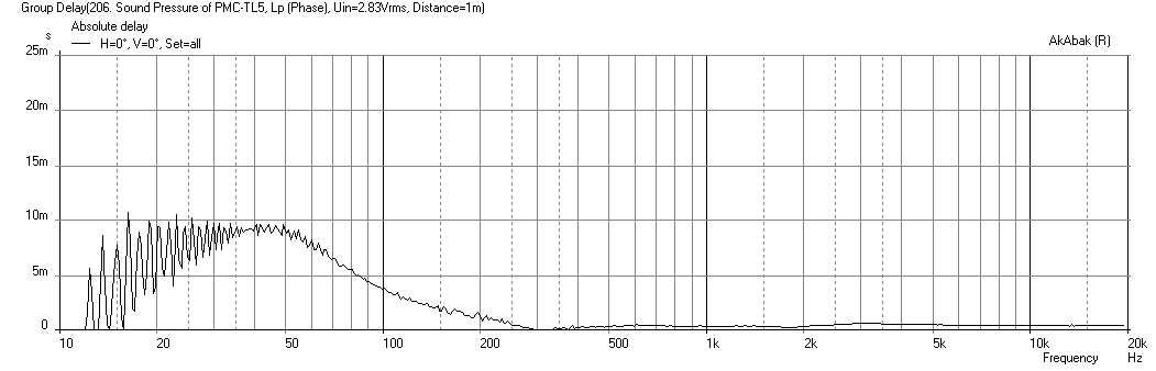

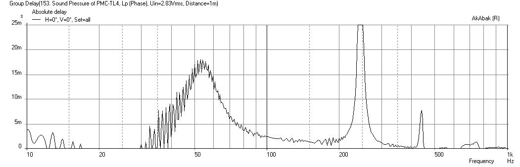

Here are the corresponding Group Delays for the light to dense stuffing, the GD goes from 16ms down to under 5ms at 50Hz which is about the same as a sealed cabinet, but with deeper bass extension.
Light:
Dense:

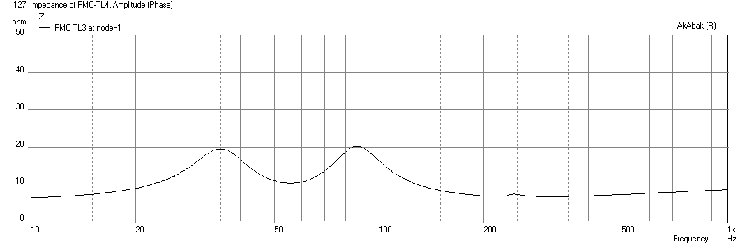

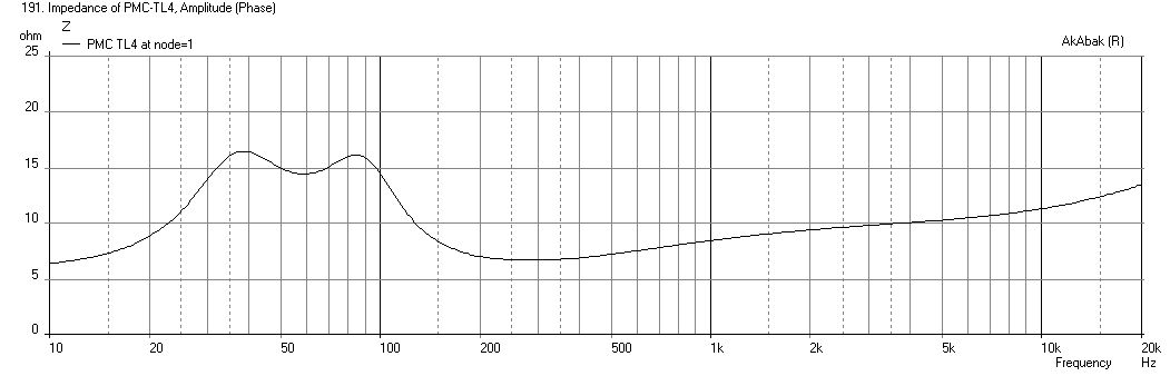

Here is the predicted impedance for light stuffing:
Moderate stuffing:
Dense stuffing:

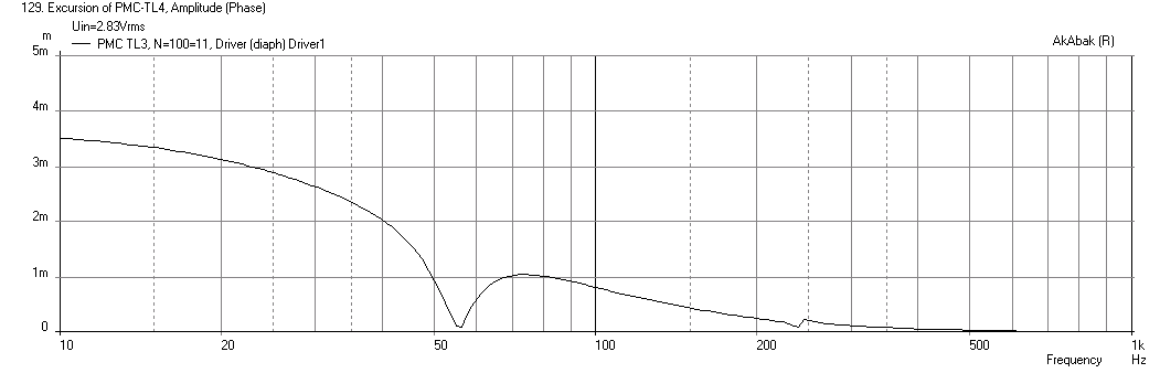

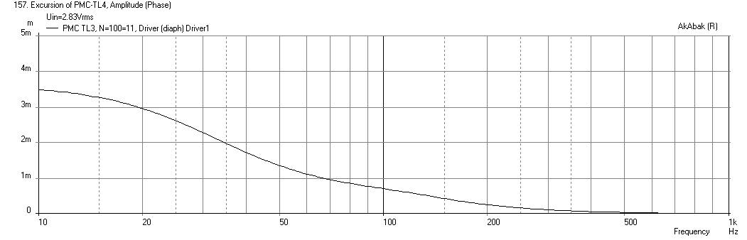

The predicted speaker cone excursion goes from a classic double peak 4th order:
To what you would see in an aperiodic TL or a sealed cabinet:

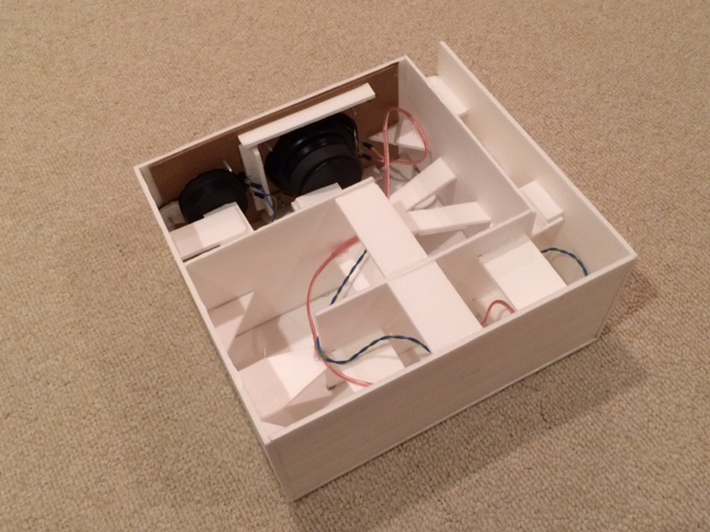

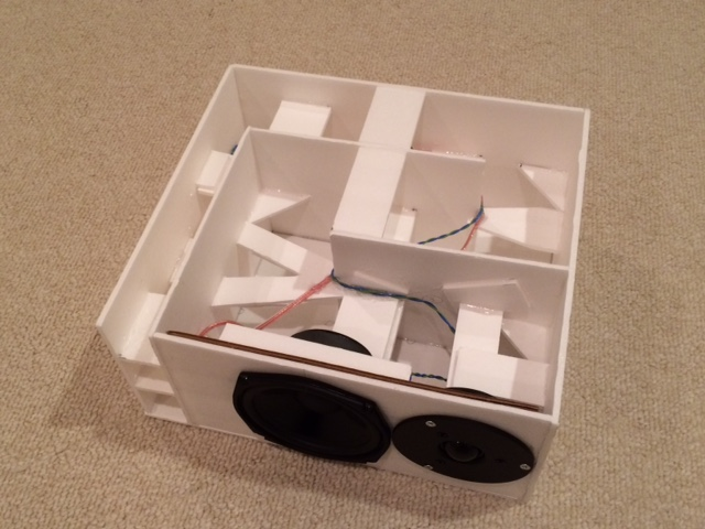

So these plots intrigued me and I decided to go with a prototype build in foam core. I was aiming for the moderate to dense case somewhere in between. I thought it important to get at least a -3dB point at 80Hz to get a sense of some bass output. I redid the model with front exit vent and the stuffing plan closer to how I will implement it using loosely teased out polyfill. Here is the predicted frequency response with a 2kHz XO and baffle step loses included:
And here is the predicted GD:
If stuffing is added to the final leg, here is the predicted response - about 80Hz f3:
With about 7ms GD at 50Hz:
With a semi-bordering on aperiodic TL impedance peak with a mild double bump:

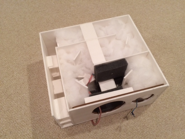

Anyhow that was the goal and here is the build process:
Stuffing plan (adding stuffing in final leg transforms to aperiodic TL):

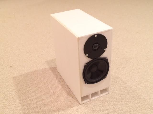

Here is the completed speaker:

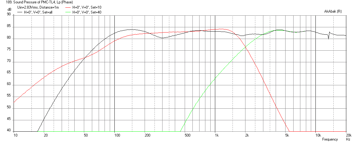

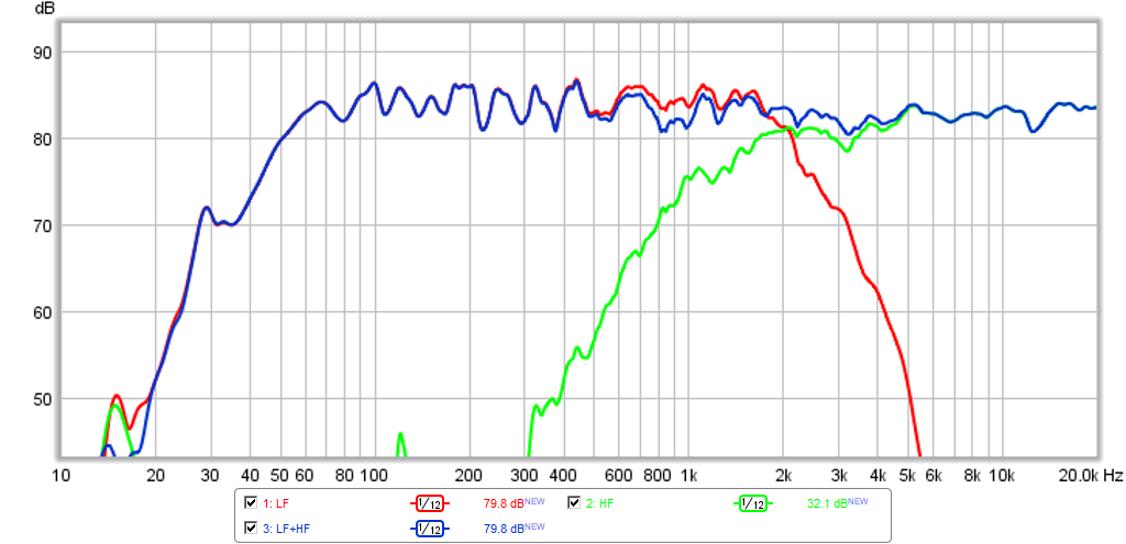

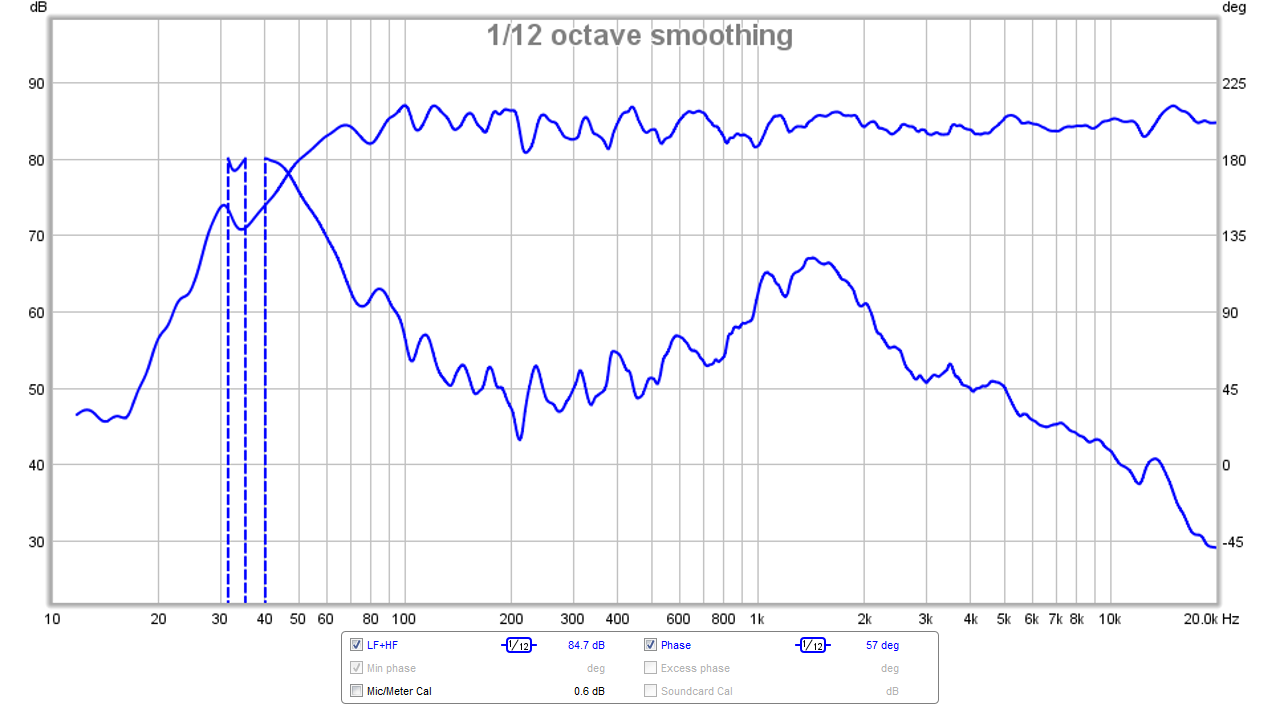

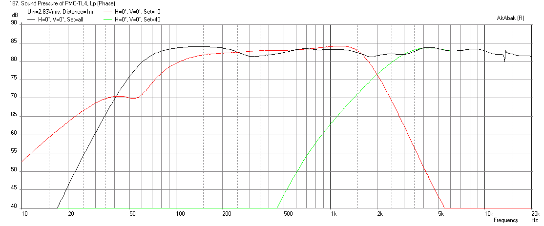

And here are the measurements using a miniDSP and TPA3116D2 amps for an active 2-way. I am using 1st order electrical HPF at 2kHz on the DC28F and a 4th order BW low pass at 1kHz on the DC130A to get an acoustic XO of about 1350Hz. The slopes are quasi-Harsch and allow somewhat of a time-coherent output. I will refine the XO later but these are just to get started.
Raw measurement of the woofer in the TL running full range:
Frequency response showing XO profiles:

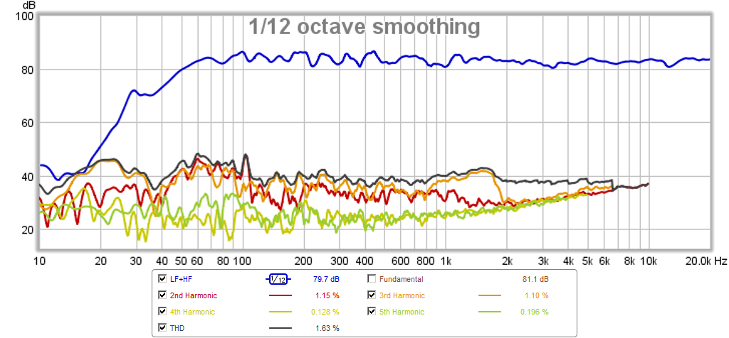

Harmonic Distortion:

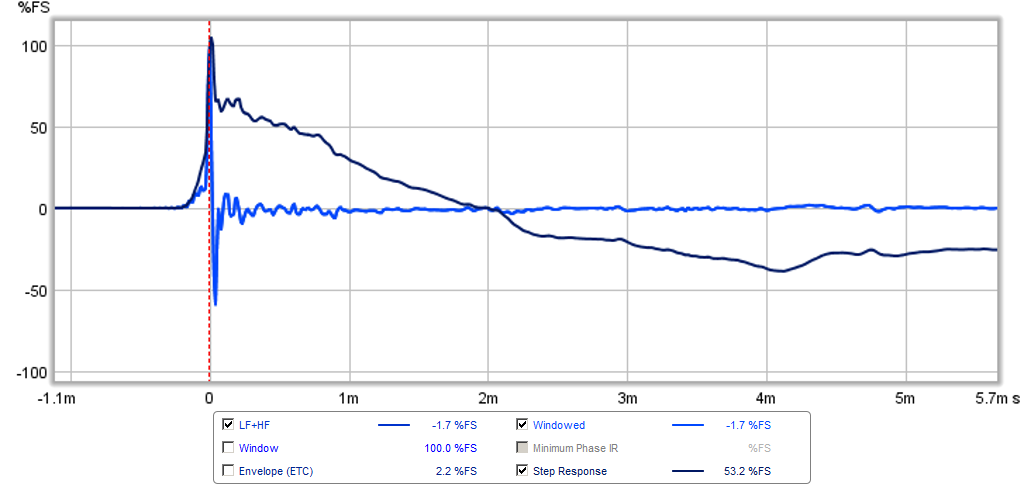

Impulse Response (there is a slight rise and wiggle before the main pulse due to the time delay on the tweeter to get it to be quasi transient perfect with the woofer):

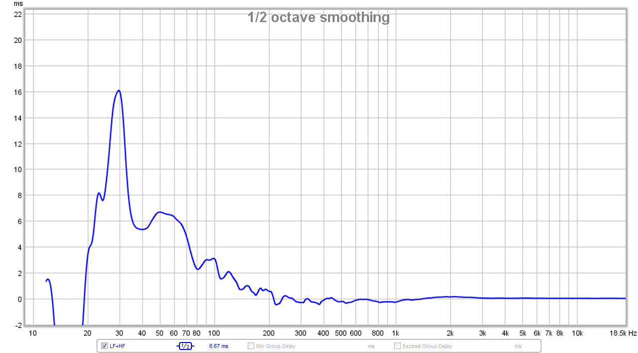

Group Delay (with 1/2oct smoothing for clarity) is about 6.7ms at 50Hz:
I did take impedance sweeps and they look a lot like the mild double bump prediction above.

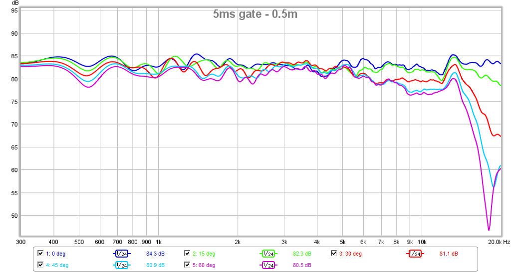

Edit 10/31/15: Polar data shown has tweeter rebated and brillo pad diffraction reducers installed

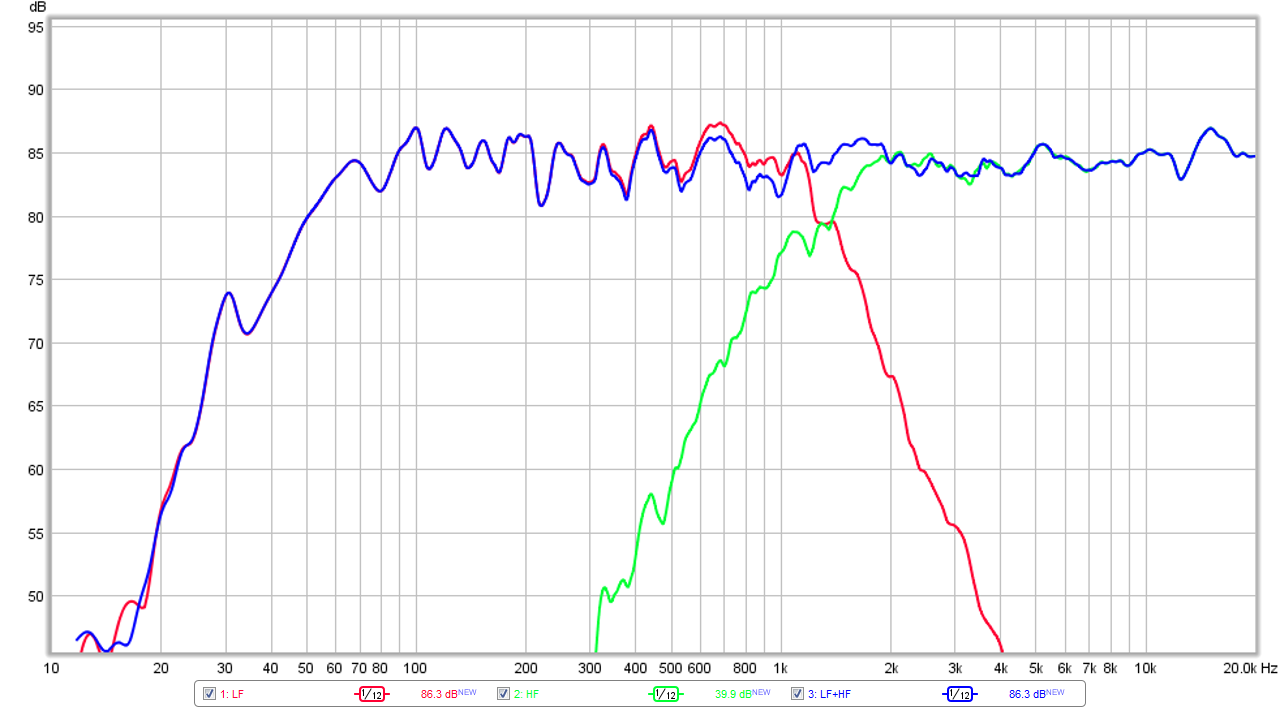

Edit 10/31/15 - latest Measurements with 2kHz XO and rebated tweeter with brillo pad diffraction control - sounds great and settings are now"locked down" for enjoyment (and to build stereo pair):
XO plot:

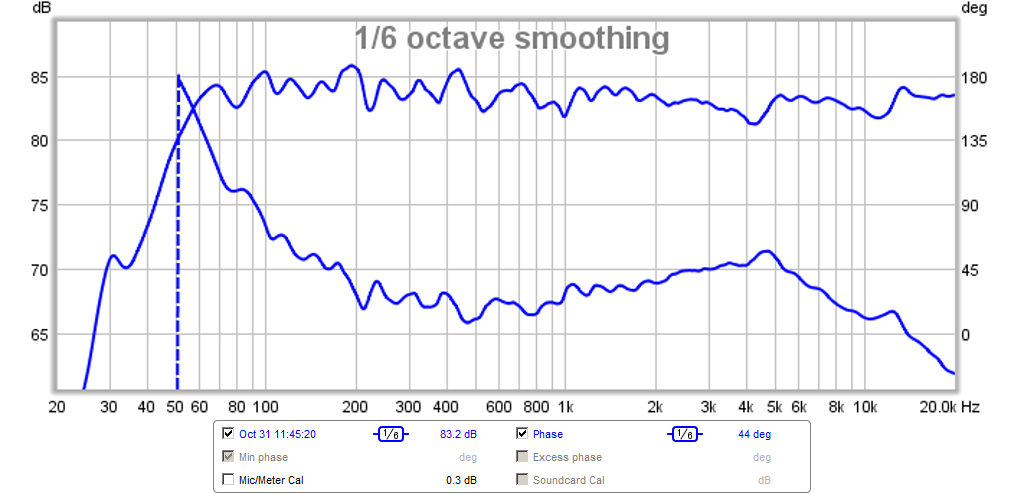

Phase - +/-23deg over 150Hz to 15kHz :

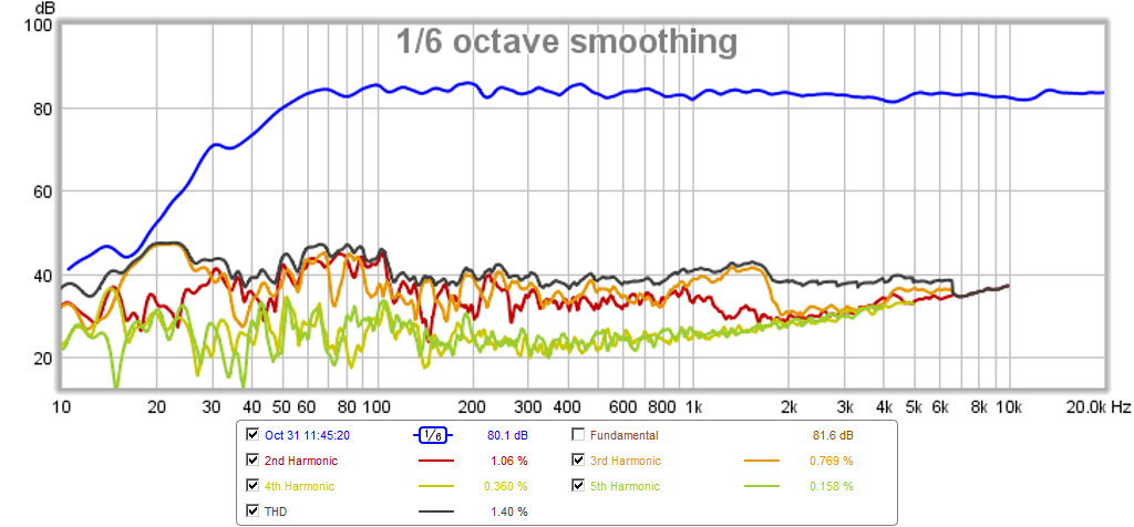

Harmonic Distortion - about 1.4% at 50Hz at normal listening levels:

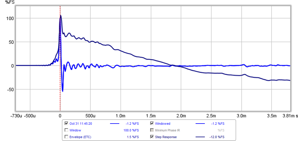

Impulse Response/Step Response - very nice:

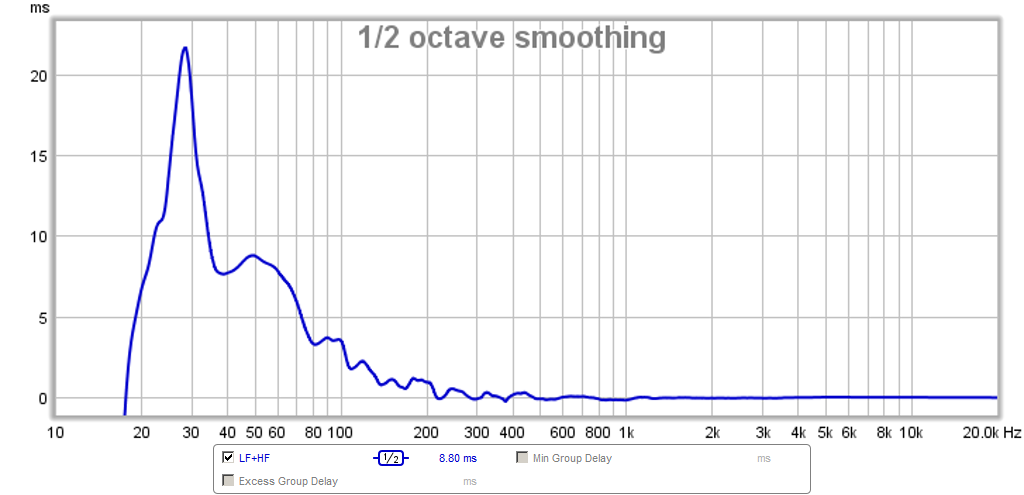

Group Delay (8.6ms at 50Hz - increased 2ms due to BW1 HPF at 32Hz):

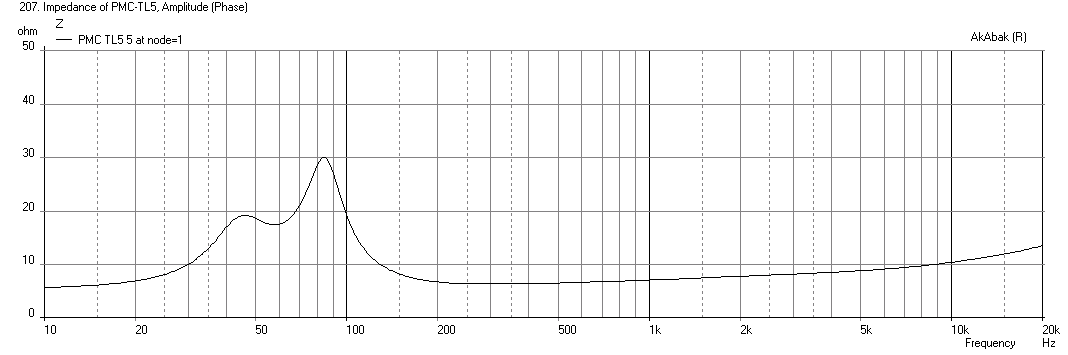

Here is the impedance:

Could you please post nearfield measurements of the woofer and the port? Great would be a scaled nearfield measurement of port and woofer (adjusted sound pressure using the port and cone surface area). If possible a nearfield mesurement of the CB (with closed port) would be great.
And finally, a impedance measurement of the TL would be great too. I'm curious about the difference of the CB and the TL.

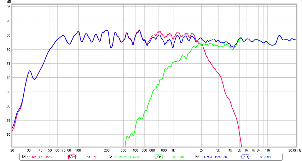

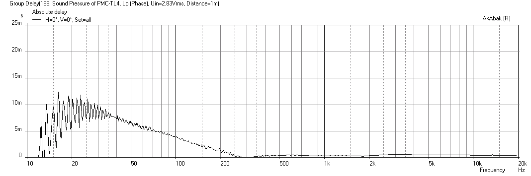

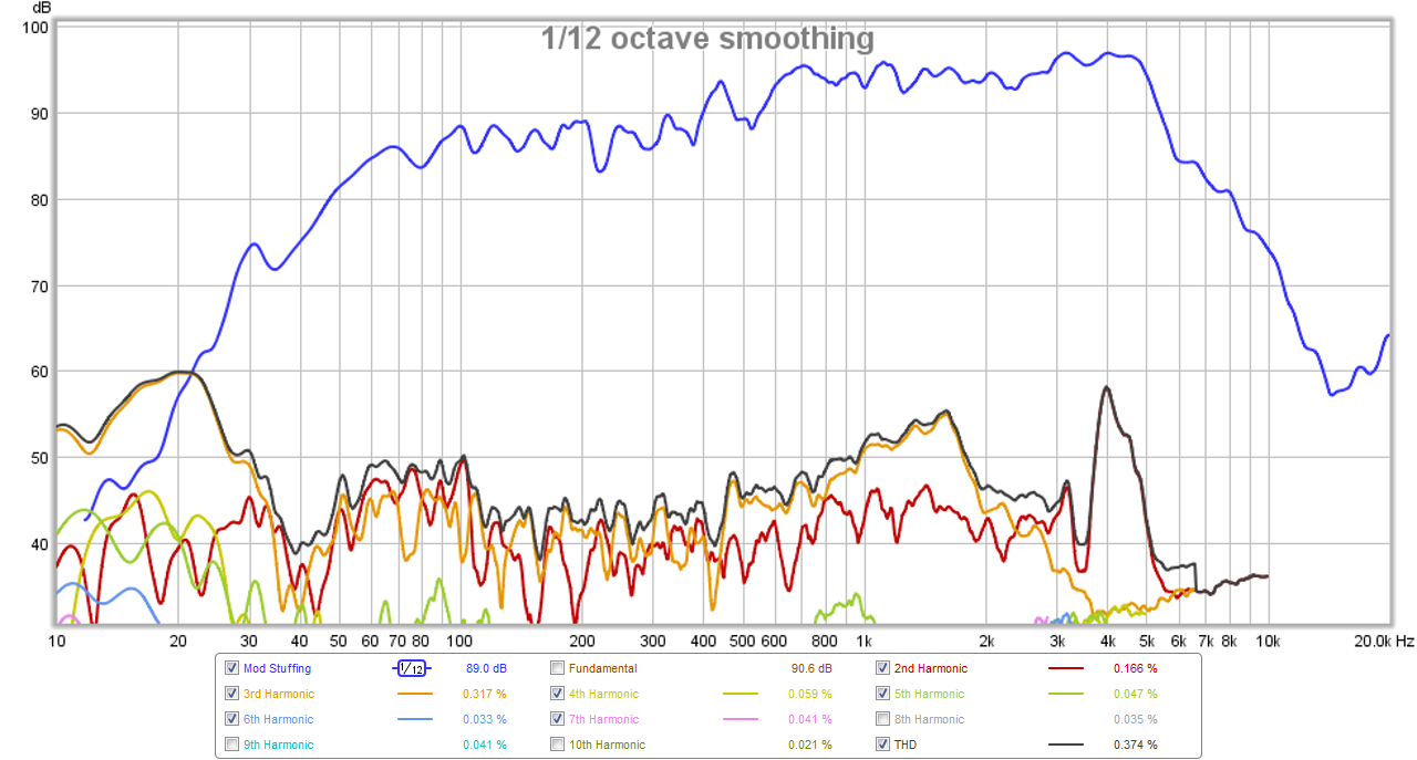

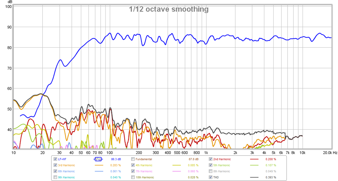

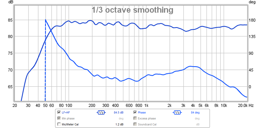

2kHz XO
So I decided to try moving the XO point to 2kHz. The responses on both drivers is quite smooth so it was an easy matter to just go in and nudge the electrical XO points upwards. I ended up 1900Hz BW4 LPF for the DC130A and 2500Hz BW1 HPF on the DC28F with a 0.40ms delay on the tweeter. I also put a BW1 HPF at 32Hz on the woofer to limit over-excursion and reduce HD at the low frequencies. This had a +2ms penalty on group delay at 50Hz, ending up at 8.7ms but I think is worth it. The acoustic XO is exactly at 2kHz.
Measured Frequency Response and Acoustic XO plot:
Measured Harmonic Distortion - note increased HD at 1.7kHz due to woofer - but a good trade-off for better overall sound:
Measured Group Delay (increased 2ms due to 32Hz HPF:
Measured Phase:
Measured Impulse Response and Step Response - pretty much this is as good as it gets for a basic eyeballed Harsch XO.

If the graphs are correct the Faital is in reality around 3db more sensitive than that tweet
Sent from my iPhone using Tapatalk
That implies your ignoring diffraction/BSC, which is never good.
You can do a lot better than current with a proper x/o design.
rgds, sreten.
FWIW the Rogers DB101 has no BSC either.
Very much so.
Given that my speakers inevitably find themselves with their back on a wall and in this case sitting on a desk as well if I'd implement BSC the bass would be way too hot.
It would result in a horrible and inefficient mess that sounds like crap.
With my current main speakers (Tannoy DC +12" Volt TL), which sit in corners, I had to reduce bass by nearly 9dB to get a flat response at my listening position.
You're right.
I used an air-cored inductor for the low pass with a highish DCR to make up for that.
You're right.
The SEAS 19TFF looks very nice and smooth. The tweeter appears to be 87dB sensitive and the 5FE120 appears to be 90dB sensitive. Would you typically have about 5dB baffle step loss so that the tweeter would still need to get cut by a note 2dB? I guess I am assuming 4pi placement and measurement - maybe you have room boundary reinforcement for 2pi?
My monitors are currently in 29in tall stands about 5ft from back wall so effectively 4pi. I wonder what kind of bass boost it would get if closer to back wall? Would probably get a reflection cancellation somewhere.
My daughter uses them as nearfields sitting on a desk with their backs to a wall.
There will inevitably be some ripple in the response but considering their placement this is small compared to implementing BSC which would result in bloated, messy low end response.
None of my speakers will ever be in free space (4pi), the wife sees to that*.
It was hard enough to get her to accept my main speakers (190L or there abouts) so they ended up in the room corners. As I said above in my response to sreten I had to knock the bass back by 8dB to get a flat response at the listening position.
If I had the cash and space for a dedicated listening room I'd soffit mount them.
*Personally I don't like free standing speakers either. They become to visually dominant which lessens my enjoyment by ruining the auditory illusion. Ideally I'd want speakers to be invisible hence my preference of soffit mounting if it were possible.
I assumed room gain wd make back 2-3db in the bass
Going a bit OT a 3 way (TL?)with the Faital 10fe200 or similar MCM wd be nice also. Total for the drivers around £130-140. That wd be a killer budget build imo
Polar Measurements
I tried a polar measurement with the tweeter just surface mounted no rebate and it looked terrible with sawtooth diffraction. So I added some foam core sheet trim to flush mount it - like it was rebated. I also added some pieces of Scotchbrite scouring pads glued around in a rectangular pattern a la LS5/3A. The measurements now look outstanding. I was using some EQ before to get the on-axis flat response but off-axis the diffraction was still there. So now there is no EQ except for a very mild +1.5dB Q=1.2 at 5100Hz. The data was collected with a 0.5m mic distance and gated 0.5ms before and 5ms after.
The variation is about 5dB up to about 13kHz and mostly less than that. It also shows that the tweeter XO frequency integrates very well with the woofer at 2kHz. Walking around the room it sounds very uniform and I imagine in stereo, the sweet spot would be pretty wide. These budget Dayton DC28F's are very nice performers.
The legend shows values for the cursor at 6kHz.
