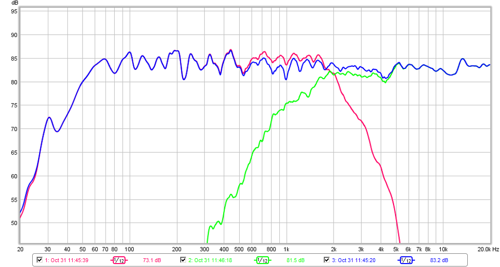

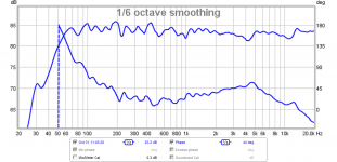

Final Measurements with Rebate/Brillo and no EQ
Measurements performed after all EQ removed from tweeter except for +1.5dB Q=1.2 at 5.1kHz.
It does sound better now - the highs are very smooth and no sign of harshness. Bass has nice extension to 50Hz (f3) now with mild +1.5dB low shelf at 70Hz Q=0.8.
I think this configuration is good enough to lock down and just enjoy now. Also start building the stereo pair.
Listening to it right now and just really enjoying the music these can play. The produce a surprising amount of bass and I have them stand mounted in the open so no wall reinforcement. When listening while looking away I have to remind myself that these are the basic 5.25in mid woofers offered by Dayton. Very pleased with this speaker right now. :D

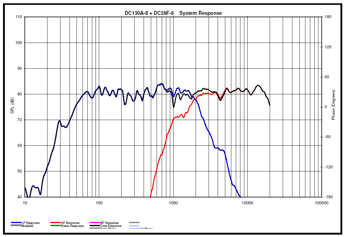

XO plot:
512031d1446307612-low-cost-pmc-inspired-tl-monitor-dc130a-dc28f-pmctl4-2khz-xo-rebate-brillo.png

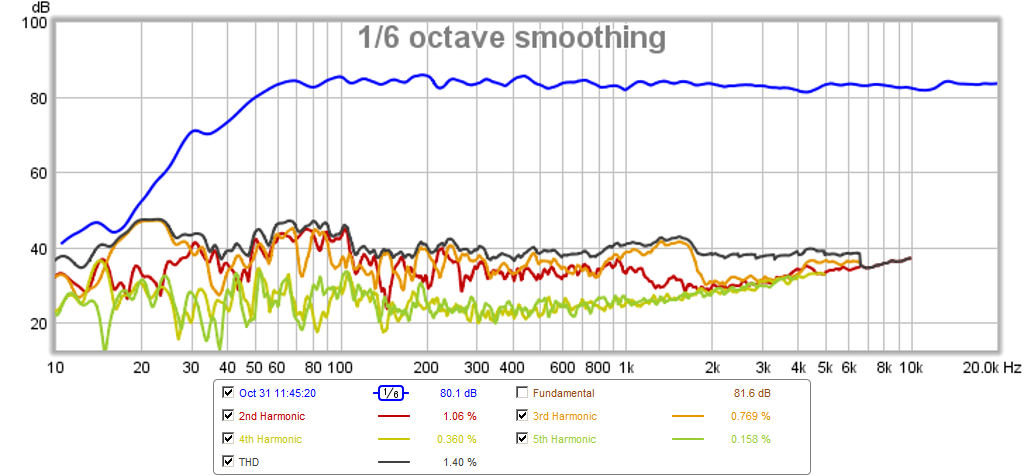

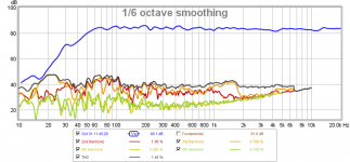

HD - about 1.3%HD at 50Hz at 80dB:
512033d1446307612-low-cost-pmc-inspired-tl-monitor-dc130a-dc28f-pmctl4-2khz-hd-rebate-brillo.png

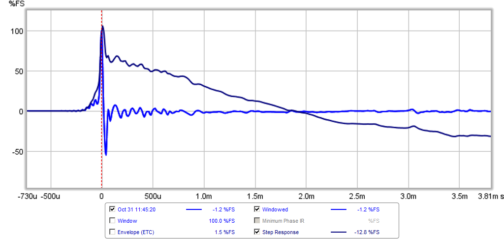

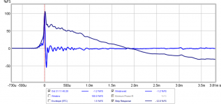

IR/SR - looks cleaner now and is consistent at all polar angles measured:
512034d1446307612-low-cost-pmc-inspired-tl-monitor-dc130a-dc28f-pmctl4-2khz-ir-sr-rebate-brillo.png

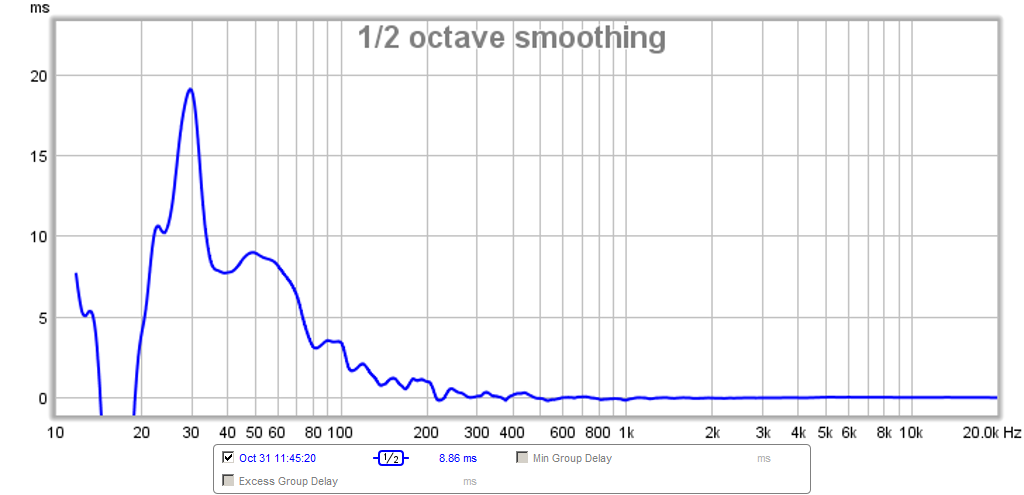

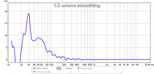

GD - still 8.6ms at 50Hz:
512035d1446307612-low-cost-pmc-inspired-tl-monitor-dc130a-dc28f-pmctl4-2khz-gd-rebate-brillo.png

The TL is better as it reaches deeper cleanly and with low group delay - it's a much bigger box though. If I were to design a TL for the AC130F1 it would certainly sound even better than the DC130A. The little sealed AC130F1 reached almost the same bass when a LT was applied but then ran out of room excursion wise. The TL is a lot more efficient than a sealed box with about the same group delay. If you can handle a 14in tall x 12in deep x 6in wide box (internal dims) the PMC TL clone will be more satisfying.

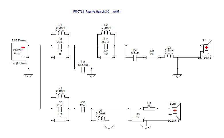

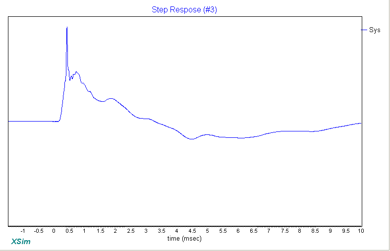

Passive XO - first cut

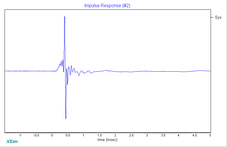

I had some time to play around with PCD and managed to get this passive XO for this speaker. I am using a stepped front baffle with a 13.5cm setback (maybe a WG would be best way to achieve this?) on the tweeter, and 2nd order BW electrical on both woofer and tweeter to get 4th order BW acoustic on the woofer and 2nd order BW acoustic (should be Bessel) on the tweeter. The result is a quasi-transient perfect sort-of-a-Harsch XO.
Here is the Impulse Response Step Response from Xsim using the FRD file from PCD:
512383d1446449857-low-cost-pmc-inspired-tl-monitor-dc130a-dc28f-pmctl4-pcd-xo-ir-v2.png
512384d1446449857-low-cost-pmc-inspired-tl-monitor-dc130a-dc28f-pmctl4-pcd-xo-sr-v2.png
This is my first passive XO designed from scratch, so probably can use a lot of help.
Here is the XO diagram as drawn in Xsim:

Founder of XSA-Labs
Joined 2012

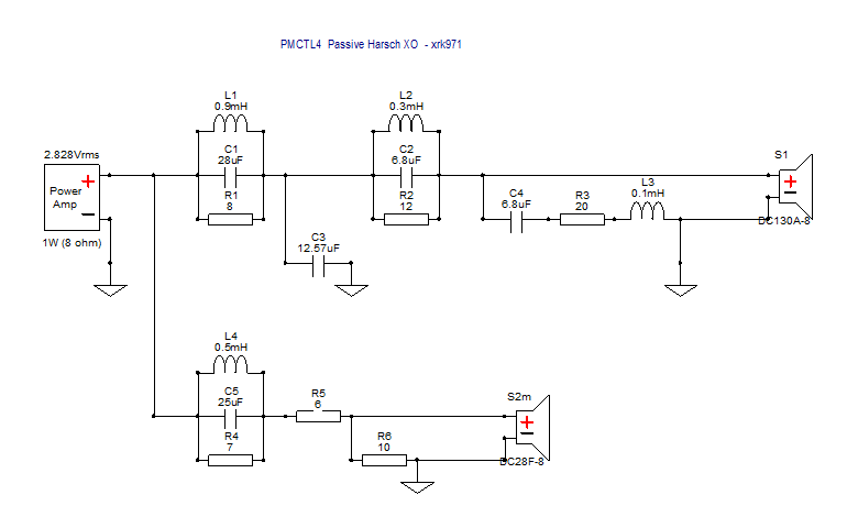

Disregard above diagram - my typo - left off the HPF section!
This one should be better.
Given the high parts count, without even pricing the parts, I can say that this XO is probably going to cost more than a miniDSP and two class D amps. If one had access to scrap magnet wire from a surplus trafo, home made inductors and non-polarized electrolytic caps can bring the price down.
512416d1446479846-low-cost-pmc-inspired-tl-monitor-dc130a-dc28f-xsim-diag-pmctl4-xo-v2-fix-typo.png

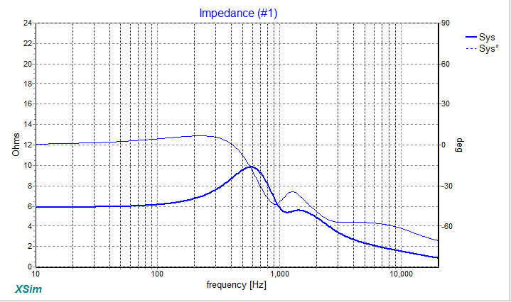

Here is the electrical impedance that the amp will see:
512417d1446479954-low-cost-pmc-inspired-tl-monitor-dc130a-dc28f-xsim-diag-pmctl4-xo-v2-fix-typo-impedance.png
Not sure why the impedance at HF's is so low?

.....Not sure why the impedance at HF's is so low?
At HF a capacitor given its value and ESR is a AC short so when amp look through C1/C3 it has direct HF-AC-SHORT to ground, maybe try if C3 will keep your filter slope design funchtion adding some x,xx R value in electric series to C3, or a x,xx value inductor that hinders HF can pass the route.
Most often a passive electric 2. order high pass filter is capacitor followed by inductor CL or two set CR cascaded or high loss type two set RL cascaded.
