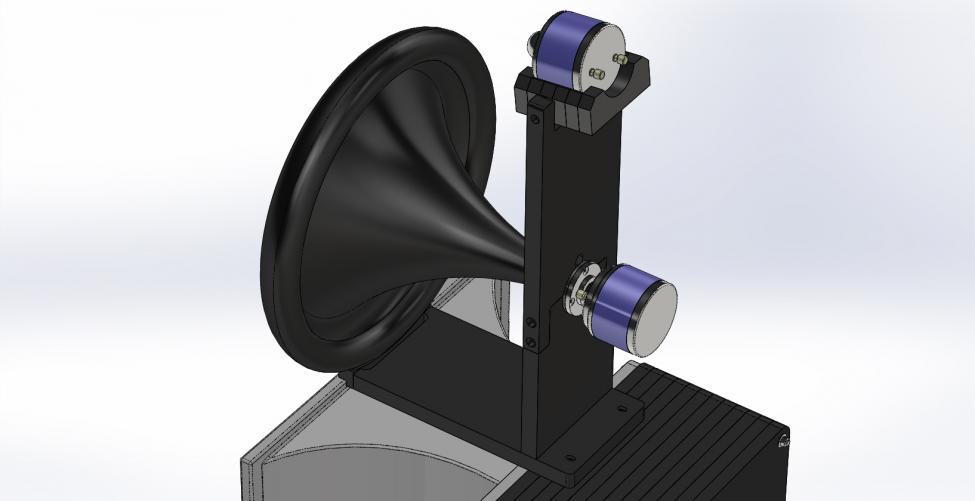

I tried and made a lot of 3D-models of different kinds of holders for the mid and tweeters to fit on top of the J-horn. I ended up with this solution made out of 30mm aluminum, as simple as possible, form-follows-function kind of deal. Easy to produce with as few parts as possible:
A render of the complete 3D assembly started really looking good in my opinion. I had used a lot of time without really being satisfied. This came together in a good fashion I think:

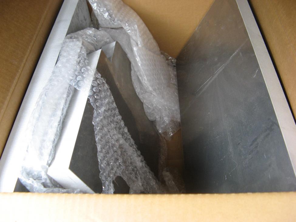

First the parts were cut with a waterjet. I cut all parts with 3mm excess material, since the waterjet cut is a bit rough and does not go through the material perfectly perpendicular. The plan was to CNC these parts to a perfect fit later on.
Thanks Ernie. Working with product development and engineering of machinery via 3D tools definitively helped the process, not to mention the network of vendors.
Parts fresh out of the CNC mill, a testassembly of the parts to check the fit. Everything was perfect.
